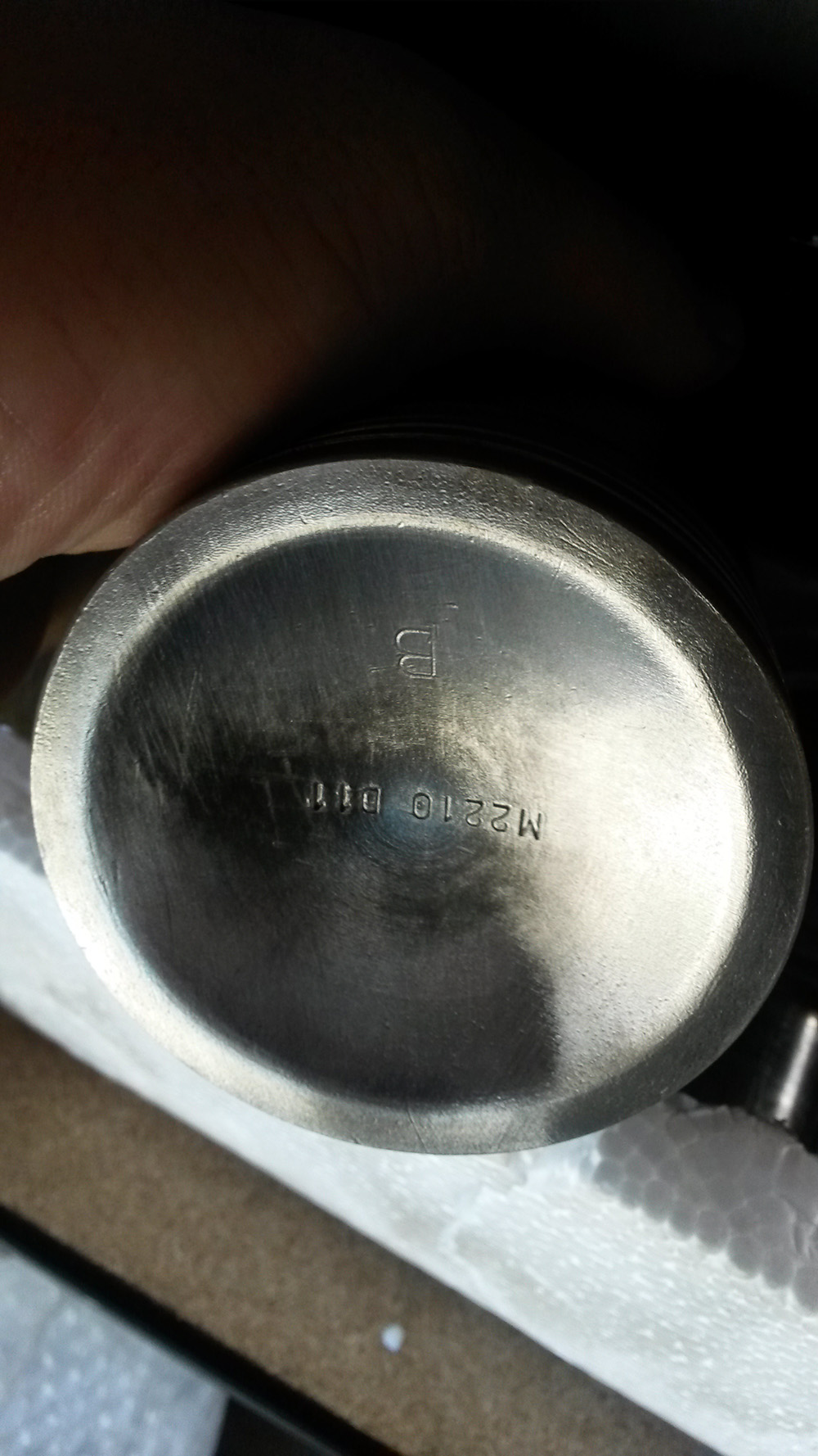

So cc in the modified head is 22 that I work it out at..... pistons are factory 1275 dished pistons

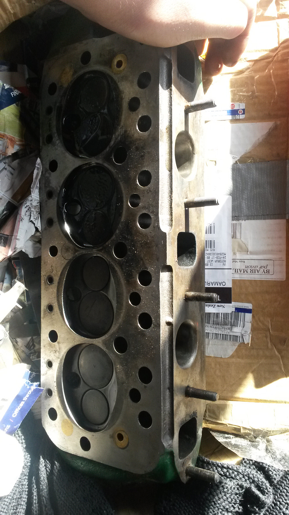

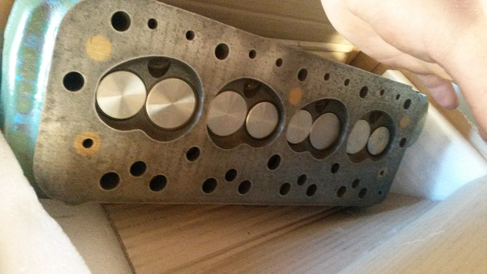

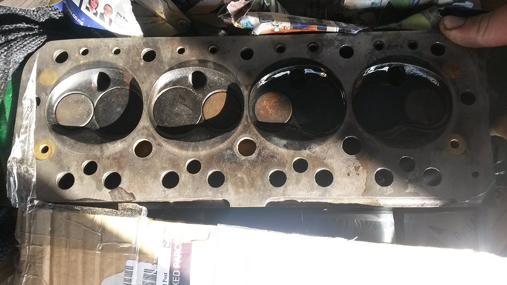

Hopefully this photo works
uk boy
32 Posts
Member #: 10074
new Zealand
One is the new stock head other two are modified head. Would a factory block hold up to small amount of boost? Once finished it will only be used for a Sunday drive probably every month haha

So I just measured up new head and came up with 20 cc am I doing this right?
Potentially in the ballpark.
There are lots of YouTube vids on measuring chamber volume; I've seen some where they use a burette and others using a large syringe. A burette is very easy and more accurate than a syringe for this, and plastic versions (better for the garage) can be purchased for only a few quid off eBay/Amazon, etc...
uk boy
32 Posts
Member #: 10074
new Zealand
Yeah I used a siringe and oil and there what I got
