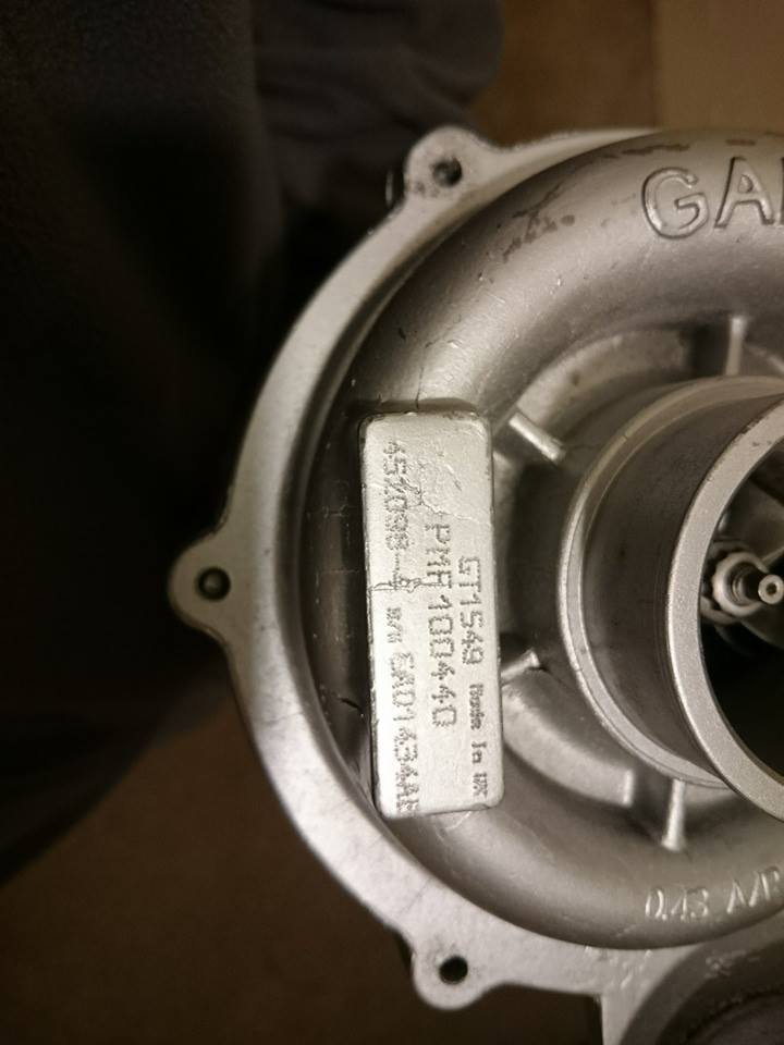

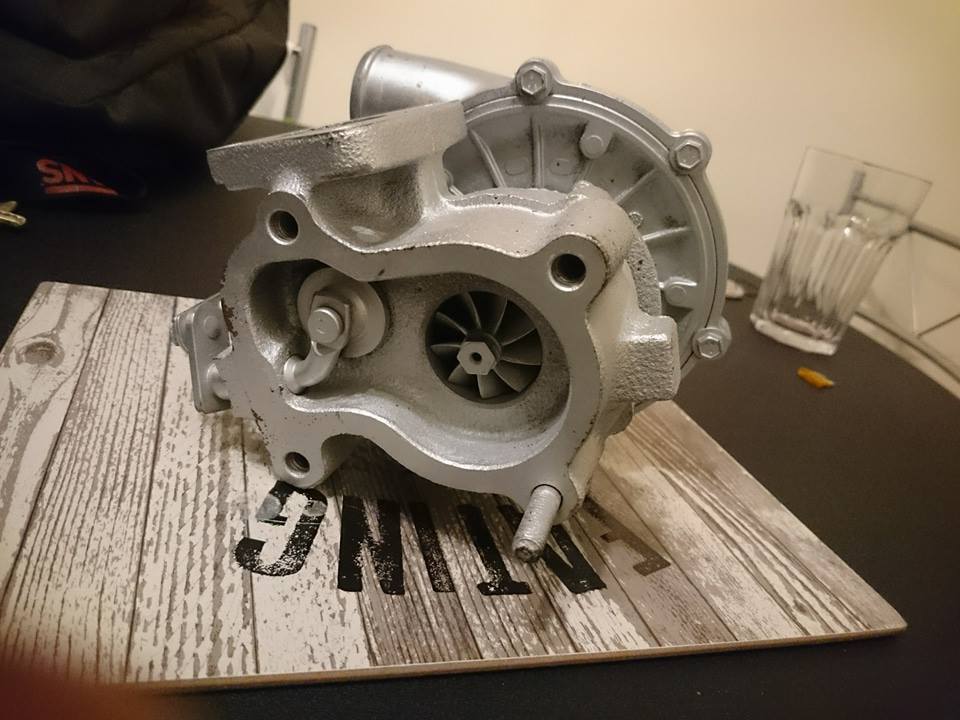

Brought a GT1549 Turbo off a Rover 200 2.0l TDI 105bhp pmf100440
Now I am aiming for 120-130 bhp will be using a verible boost controller
is this turbo any good?
also anyone know where I can get the Inlet and exhuast flange made please local comoany to me has let me down.
Thanks stephen

Right Ideally I want a GT1548 turbo
I found this online
This is the biggest GT15 turbocharger that Garrett have. It's a 200 HP turbo and you see that it does not have the same turbine housing as the smaller Garrett turbos have like the GT12 and the two smaller GT15 turbochargers. The turbine housing here is the T25 turbine housing and that means you can use a T25 / T28 turbo inlet flange with this GT1548 turbo.
Does this mean I could build a hybrid turbo from the Above GT1549 and a T25 turbo?

In reply to your DM Stephen I don't have the part number for the gt1548. It was never fitted as standard to a production car I don't think.
Garret sold a lot of them in the states in the snow mobile scene.
Mine has Got a 360 degree thrust bearing and the accuator has been altered so the actuator can can be mounted above the engine.
I'm not sure they still make them, as garret seem to have rationalised there product range
