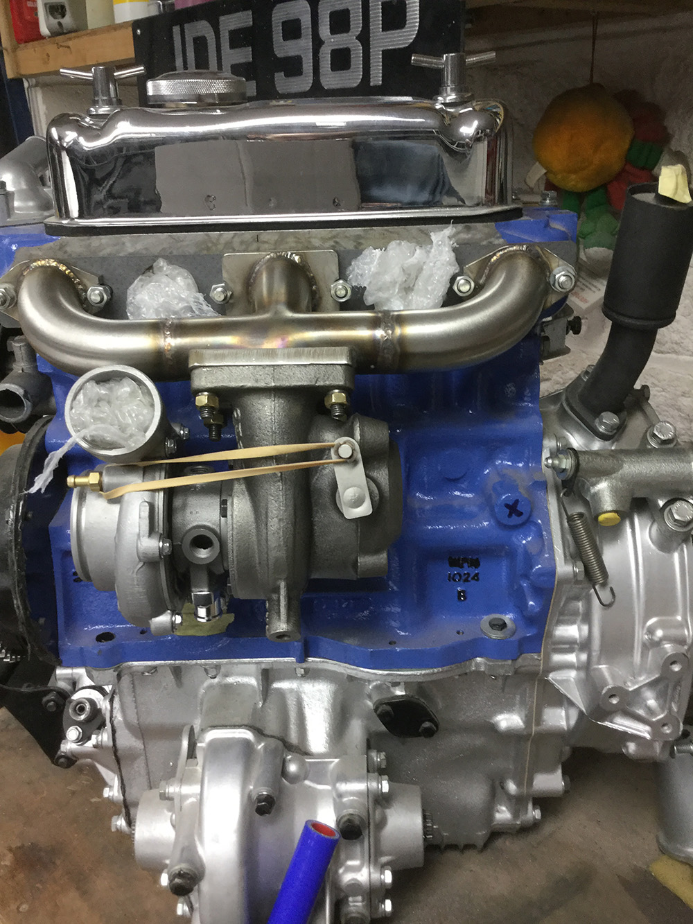

hi guys I am at the stage of needing a water feed to my gt 17 , I have searched the site for info and it seams that drilling in to the water jacket is probably the best option !! Now I have also read about one chap that drilled right through in to the bores 😳A good 100mm in ! Now I really don't want to do this and also my engine built by Benross and sat on my workbench so at this stage I have the option to do the job right !! I have also read that all drilling should really have been done before the engine was completed 😳And I realise this now but this doesn't change the fact that it has to be done !! Do you guys think it will be ok to drill ? Or could this cause me problems ? Any info on this will be gratefully appreciated as I don't want to end up like the poor old chap mentioned above 👍

Are you referring to this part of the block marked x ? If so not all blocks have this tapped

I had no problem in drilling and tapping the block for the water feed - it just needs normal care. If you were worried about going too deep slip a sleeve over the drill to prevent it going any further than the amount protruding

When I drilled my block, I put some water in the cooling system so that as soon as I was into the water jacket water pissed out. It also got the swarf out.

Thank you chaps for reassuring me ! I'm pretty sure I can manage it without drilling too deep 😊and filling with water first is a great idea , what size did you guys tap the thread ? Do you think it's a good idea to tap it the same as the turbo ( 14mmx1.5 ) so as I can use a banjo type fitting on both ends ? How did you guys do yours ? Thanks in advance 😀

Do it to what ever suits you. I used a 90° barb fitting. And used a braided hose to the existing feed on the turbo.
