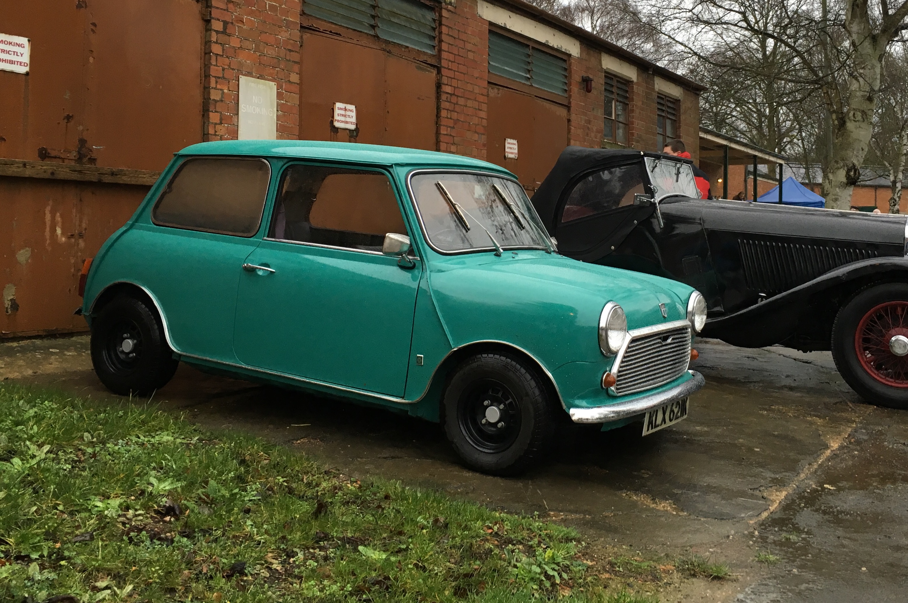

After many years i finally have a turbo mini (one i get it started). Its a 1972 Morris mini 1000, i got it as a long term investment and promised the wife i wouldn't modify it. Its been off the road now for 18 months, target is to get it on the road for London to Brighton this year. MOT is booked in for the 13th May so all hand to the deck at the moment. Im not after quick quarter mile times just want to make the car more fun and driveable.
So, its a bogo 998, with Turbo Phil 12G295, X-pin diff, Piper BP255 cam, GT15, fusion fabrication manifold and down pipe, Megajolt.

Looking good!
Rammie2000
1751 Posts
Member #: 10190
belgium
Wouldn't modify. .. is that turbo standard. Yes my love... hahaha
Fan looks like it's on backwards?
Looks great though *smiley*

Thanks guys. Just checked Dave and it's on the right way round.
Taz, it's the original aqua colour

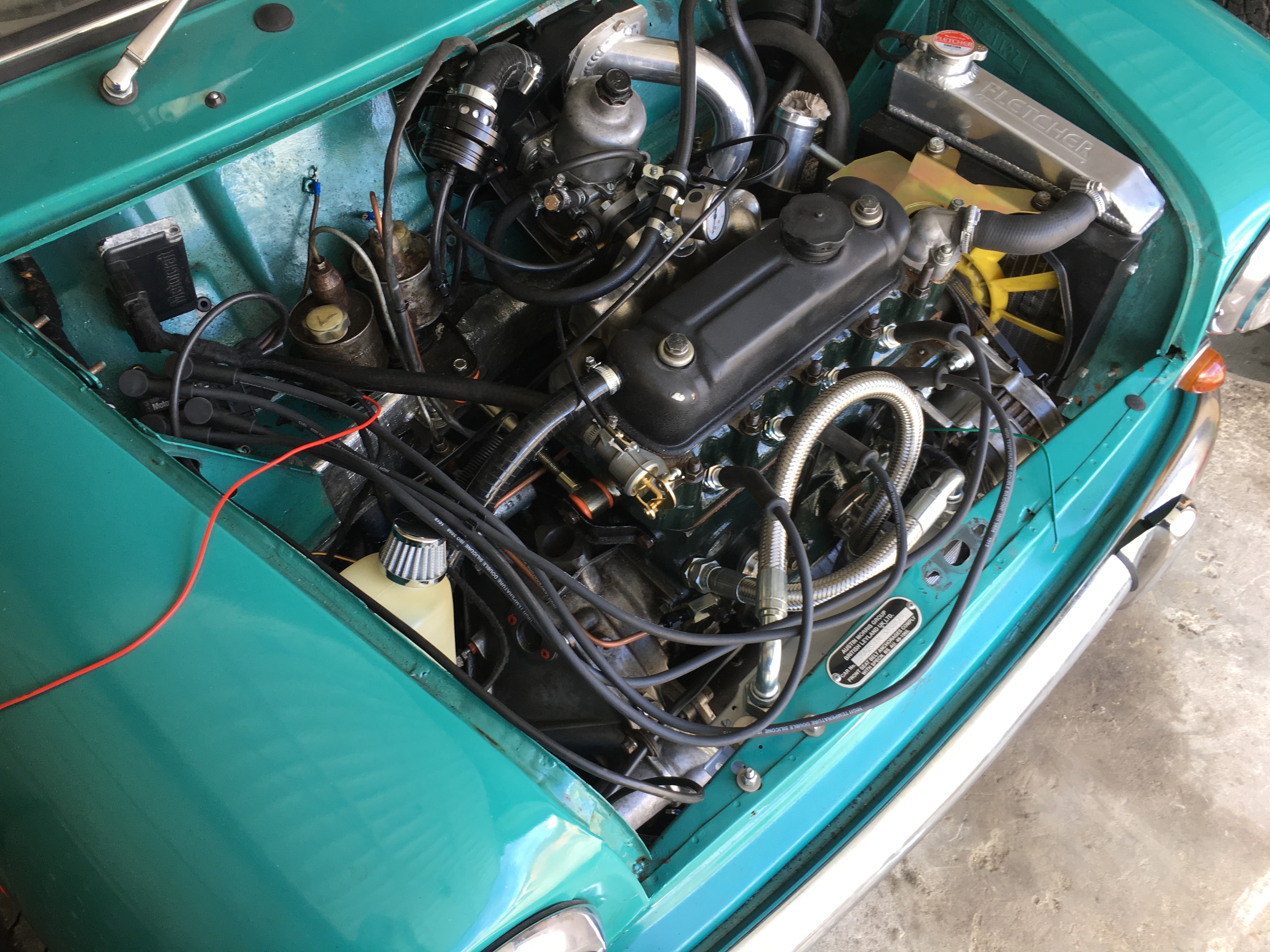

Ive now put new HT leads and plugs on. I manage to get it idling, but the revs were hunting up and down and as soon as i gave it any throttle it died. Now it fires for a few seconds and then dies. Any ideas?
1972 998 TURBO SLEEPER
Hunting is usually an air leak. I'm surpriseed that the ECU even worked at 10 V, so deffo a contributing factor.
I use the same leads and coil pack as you and never had an issue with any plug I've tried.
The part throttle lean off pipe looks weedy, check it's not got a leak.
Edited by wil_h on 5th May, 2017.
As an aside - maybe it's the picture, but it looks like your dump valve signal is connected to the plenum nipple?

your right Dave thanks
ill have look tomorrow thanks will
