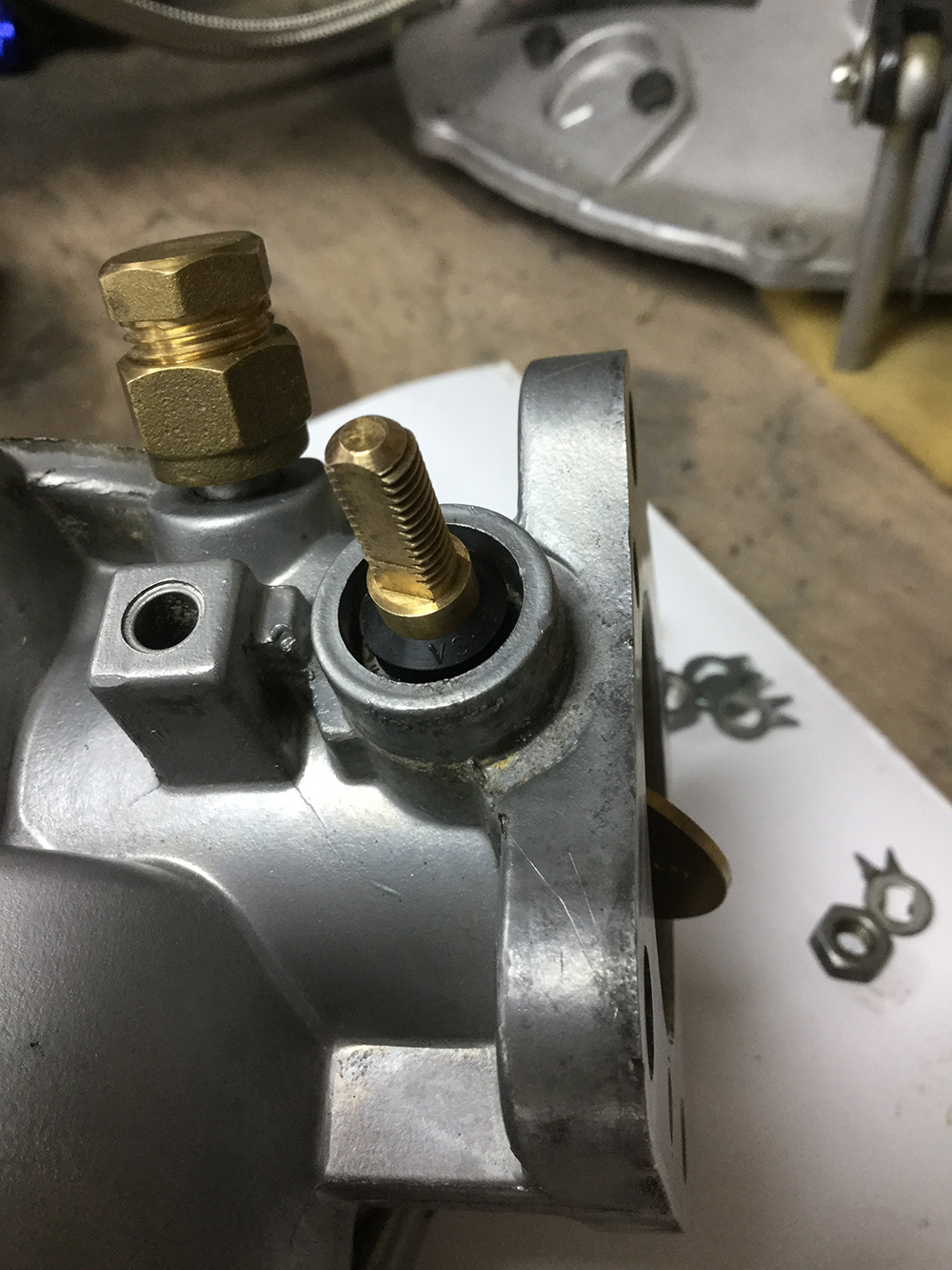

Hi chaps I am re building my hif44 for turbo use and have come stuck on the spindle seals ?
The kit has seals for a few different carbs and I'm wondering which seals I should be using can anyone shed any light ? I have read Tom Fentons guide which states replacing some plastic washers which I don't have fitted to mine as the perished seals that came out were the smaller of the two pictured
Any help would be appreciated
4642 Posts
The seal in the second picture is the right one, but you've got it the wrong way round.

That's great thanks for the quick reply Phil *Clapping*
