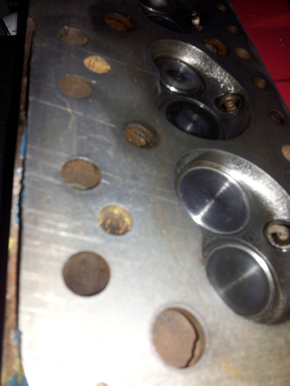

Just wondering would you skim this head to remove these marks? You can slightly feel one with your nail.
Just its had quite a skim already so don't want to go too far... How can I tell how much more can be skimmed?

got a decent photo?
can't see, they dont look that bad though.
I've put worse looking heads on without issue.
looks ok,
lay the gasket on it and see iof there are any deep marks that go over the fire rings
