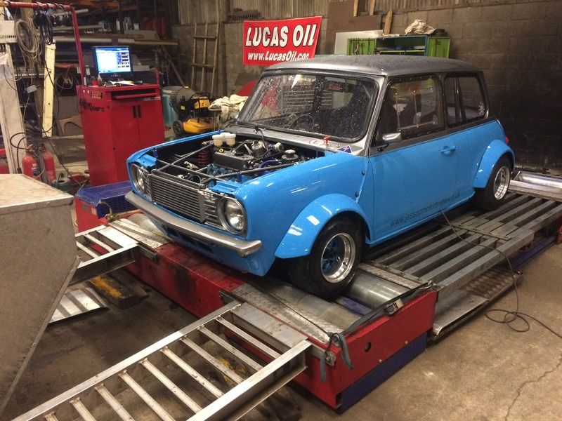

Hi all , ive not done much investigating as yet but thought id get the ball rolling with you guys .
My car ran perfect last year , ive had the engine out to swap the cam , gone from a kent 266 to a phase 2 and swapped my t3 for the gt20
Gone back to the rollers and I'm 20 hp down from last year but more boost !!!!
I drove the car last week and if I floored it it comes on boost then 5k ish it just looses power and doesn't want to rev like its lost its boost , this has shown on the rollers !!
We have fuel , plenty of boost and timing is ok , car doesn't miss or run funny but just wont pull the power ?
Any thoughts or things I can or should check !

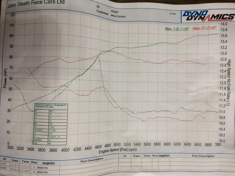

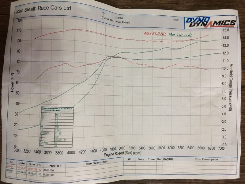

thanks men , ps the graphs show last years run to todays

Does the boost level actually drop at 5k?
No it stays the same

This says to me that it probably isn't the turbo intake pipe sucking flat as I'd expect it to starve of air and boost drop right off.

Car runs and drives fine , no misfires , spitting back , doesnt run warm good oil pressure , doesnt breath heavy etc , timing all good , plugs looked good , it doesnt alter or afr or drop boost but just wont pull any power over 5
On the road it spools up the turbo very fast and sounds like its going to unleash hell !! You then keep your down and it comes on boost but hits a brick wall as if its lost all boost but it hasnt !!
Afr and boost all backed up by my gauges in the car showing the same as the rollers

Boost pressure is measured in the manifold
Not sure in turbine size comparison , im still running the same air filter .
Its producing the boost and does creap up slightly at the top end of the revs !

The way that the power curve has swivelled around the 5000rpm value, I would guess that the Dyno settings may have been changed.
Just read your build thread.
Did you tell the Dyno man that you had changed the FD ratio?
Yes told him about the final drive and we looked to see what it had given me from last time . 8 mph
