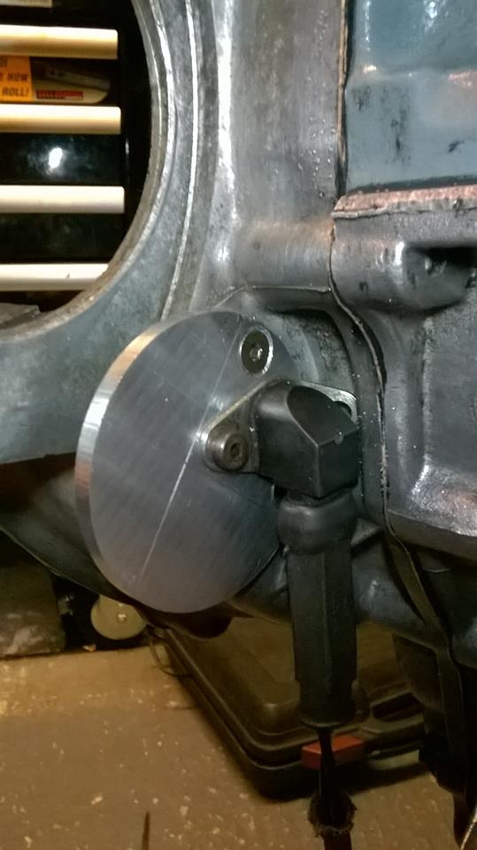

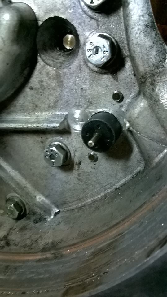

Modified turbo casing to accept the standard crank sensor. The back was fly cut to allow a spacer to sit nice and flat as the the non injection cases are about 5mm thinner in that area (after fly cutting).
I also had to get round the issue of the geared high torque starter motor as it fouled the crank sensor.
cool, so you used the turbo case for the better bearing?
