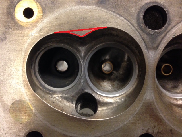

I need to get another 3cc out of my 25cc 12G940head.
Is the red area safe to take away, ist there any water/oil ways in this area?:
https://photos.app.goo.gl/I6xVGBE6YLdGSWgD2
Rammie2000
1751 Posts
Member #: 10190
belgium
Not an expert. And there is some thing close to it but i have done it. Even bit more then that.
slater
1030 Posts
Member #: 1291
Suffolk / Birmingham
It's safe to remove but it's not the best way. Keep the beak and find the volume in the 'corners' of the chamber

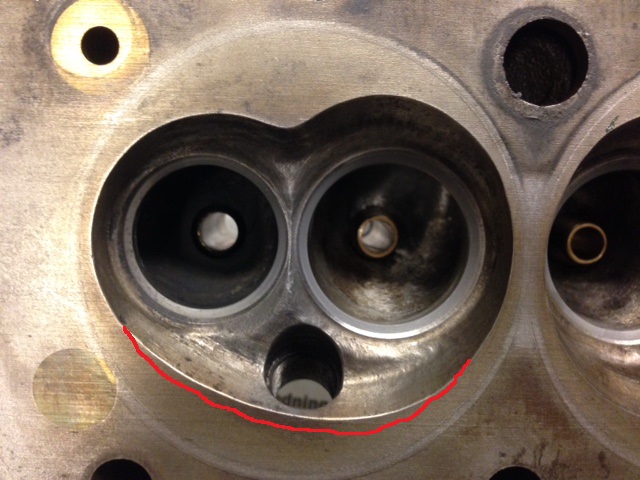

How about this area, better/worse?:
4642 Posts
Either of those areas is fine to remove material from. I'd put a picture up showing how far you can go, but photobucket has restricted hosting now. There's plenty of pictures on my FB page if you're on there ?

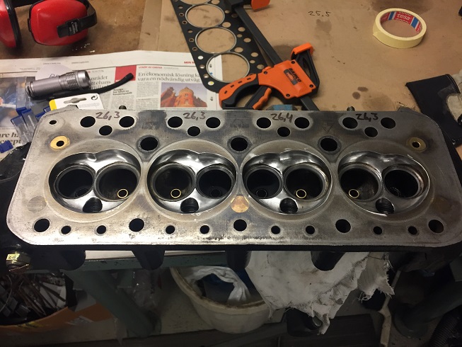

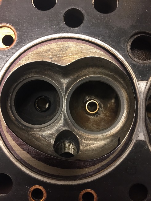

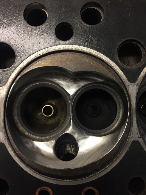

This is how it turned out, added volume but kept the shape.
Before, ~24-25cc
After 26.3cc (After some calculation I didnt need 28cc, so 26.3 will be perfect)
Edited by Jonas on 26th Sep, 2017.
Looks good!
4642 Posts
If you have some old valves and access to a lathe, machine the valve faces off so they sit flush in the seat. You can then grind the chamber roof without fear of damaging the seats. This will enable you to blend those "peaks" around the valves away.
Phil.
Jonas
76 Posts
Member #: 61
Thanks for the advice Phil, I dont want to take more of it though.
