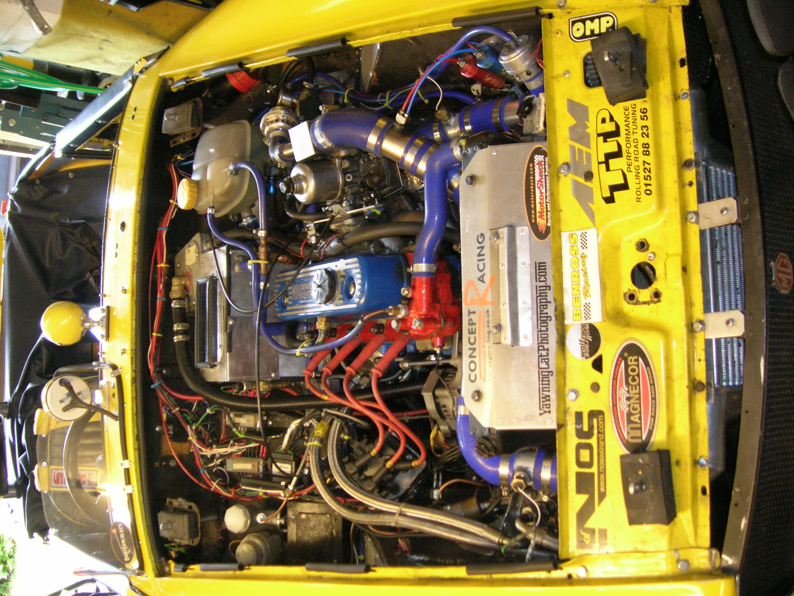

The nozzle for fuel and NOS goes into the inlet about a foot before the plenum, on a section that runs uphill to the engine so that any liquid NOS drains away from the engine. The solenoids are on the inner wing, operated by a WOT microswitch on the carb. I took the fuel feed out from the line before the fuel regulator, this may give too much fuel pressure as it runs very rich on NOS, but safer that way. NOS bottle is in the boot. Nominal 50 bhp jets give about 60 on the RR. Hope this helps.

Spotted the TTP sticker. Malc is a good guy.

Sure is Tom, and the author of the 'nuttier than squirrel shit' quote on the back of the car *hehe!*
