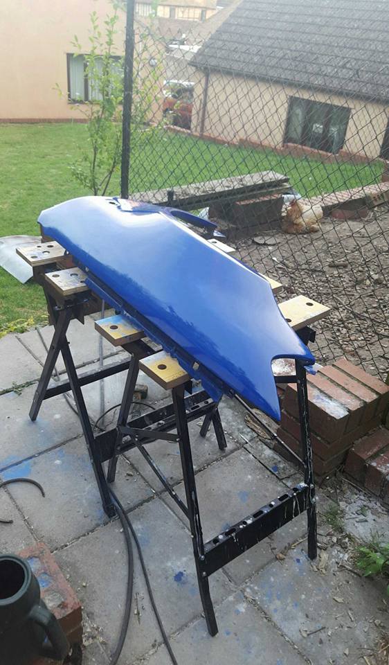

Roller it.
This panel was rollered. That is not flatted and compounded either.
Dont think of spraying 2k in your home garage. Especially given its attached to the house. Its very sketchy stuff.
