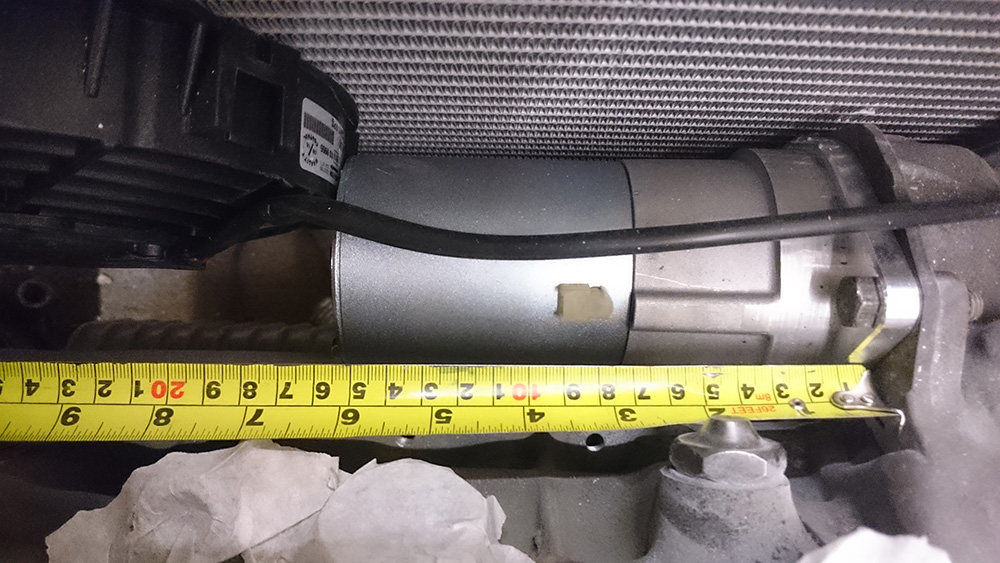

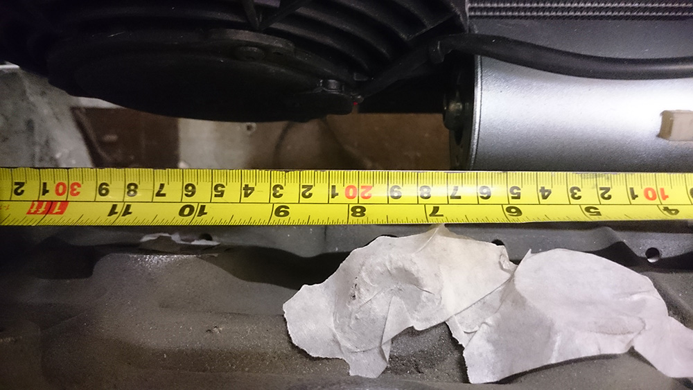

165mm long when u include the nubbin bit right at the end, 70mm dia at the back end. Soz looks like my phone flipped the pics upside down
Theres an old style one they do, i'd be interested to know how long that one is if anyone knows, as my 'bay is rather tight.
