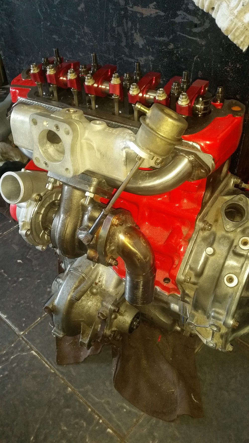

No clearance with the bulkhead
Where's the best place to relocate the actuator
Can't it be mounted vertically by the carb and the bracket and and welded to suit?
Or what are people doing?
Thanks
this was my solution on an engine ive just built for a show car
gt17 no bulkhead mods and a servo make things rather tight
i used [edit][/edit] tags to try and post an image *happy**happy*
