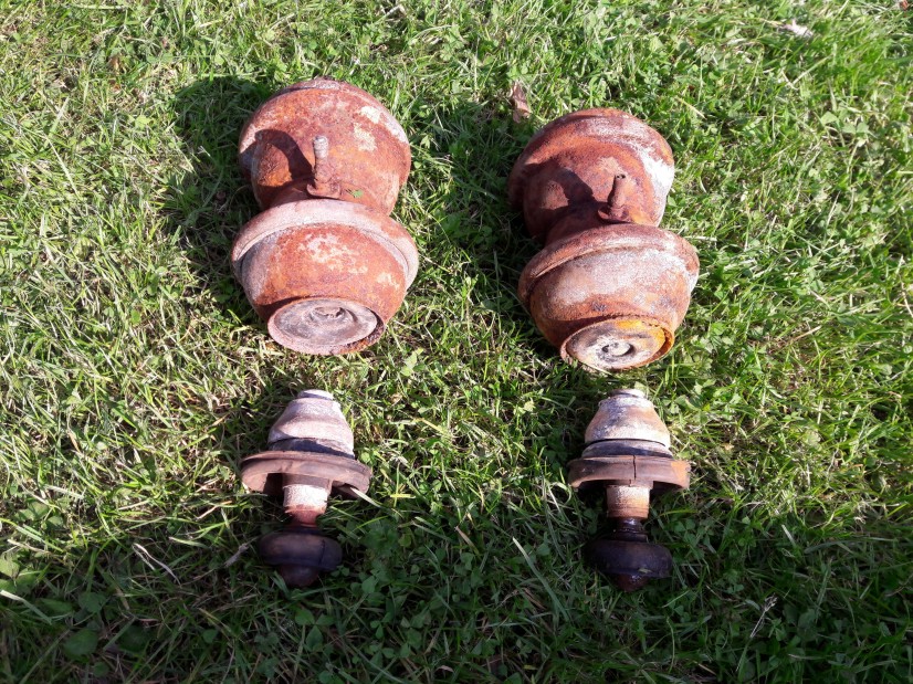

I've dug out a couple (and I may have more) but these both have individual valves suggesting front.
They are in poor condition - too many years in a damp UK shed - one has clearly lost its pressure on the fluid side (or a failed nitrogen sphere) and the other has had washers added to the knuckle joint...
But before I wire brush them and spray them red to sell on eBay as go faster suspension, where should I look for the part number.

Individual valves on them means they are front, from either a MK1 or MK2. The part numbers were on the top, but if the cadmium coating has gone, so has the part number. There was a difference to MK1 units as they all came with external shock absorbers, but you have to just take what is on offer these days. The washers added to the knuckle joints are to account for the different side to side weight of the car at the front.
