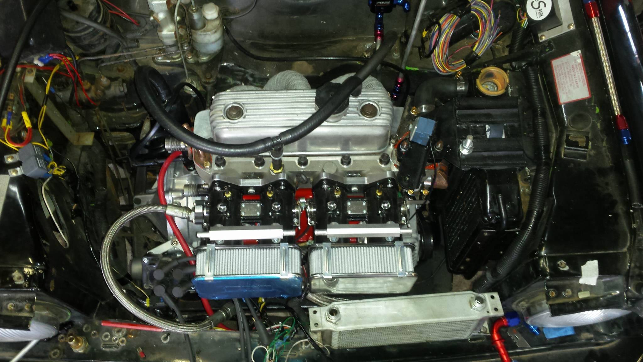

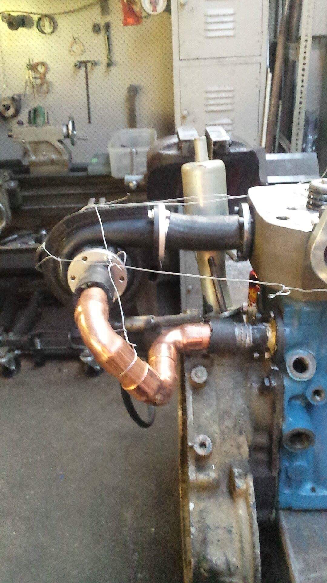

I have a mezere pump fitted like so...
It works fine with my old minispares 2 core rad. Plus I have a scooter rad fitted aswell.
The turbo is plumbed in also, which I think puts alot of hest into the system.
Just realised that this was my first attempt. How it was last was plumbed up was slightly different with only one 8mm branch out of the cooper manifold. Which feeds the scooter rad, then from scooter rad to turbo.
I also fitted a bleed valve to the copper manifold to help perge air out of thst side of the system.
