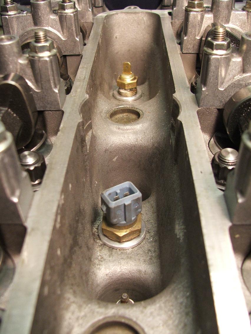

Are the two core plugs on the top of the head water? Was thinking about teeing off then and venting to header tank
Thats interesting, do you bleed the system through those holes too?
Looks like you've had the same issue im having.. where the ecu and gauges use different types of sensors, so you gotta double up on most of them. Very annoying. - unless one's reading oil?

That looks like the standard mini temp sensor and the bosch 0280130026 that almost every ECU manufacturer uses.

4309 Posts
Interesting Sprocket. Thats a useful place to put some sensors anyway.
Yep, that is definately something I’d not considered; mine went into the lower thermostat housing, which I then realised wasn’t earthed so needed to run yet another wire! Rest assured; I’m plagiarising this idea the next time. *smiley*

I thought in the same place for the sensors, but always thought that was to close from the spark plugs and could interfere whit the readings.

To be honest, i'm not using the sensor anymore. That picture was from 2010 lol. I'm using an MPi thermostat sandwich plate now and the sensor is now in that. I'm still using the temp sender for the dash in the top of the head, but, the latest version firmware for my ECU now has a temp gauge output and i'm tempted to use that at a later date.
I don't think it matters much. you only have to look how close the K1200 coolant temp sensor is to number 4 exhaust port. The coolant temp sensor is only really there for fueling, the actual value doesn't matter much as long as the fueling is calibrated to what ever temperatures it does read. Being human, you tend to think too much about stuff when it doesnt really matter, so long as the value changes, and the fueling along with it, the sensor could be measuring 85 bananas for all its worth, as long as it is repeatable.
It's not really the proximity of the sensors to high voltage things like spark plugs, but the proximity of sensor wires to HT leads. Not so much for affecting the reading but because it can put high voltage "noise" onto any number of the ECU sensor inputs (because they all share the same the same CPU reference voltage) which can lead to all sorts of other issues.
So I would be more concerned where you run the wires rather than the sensor location itself.
