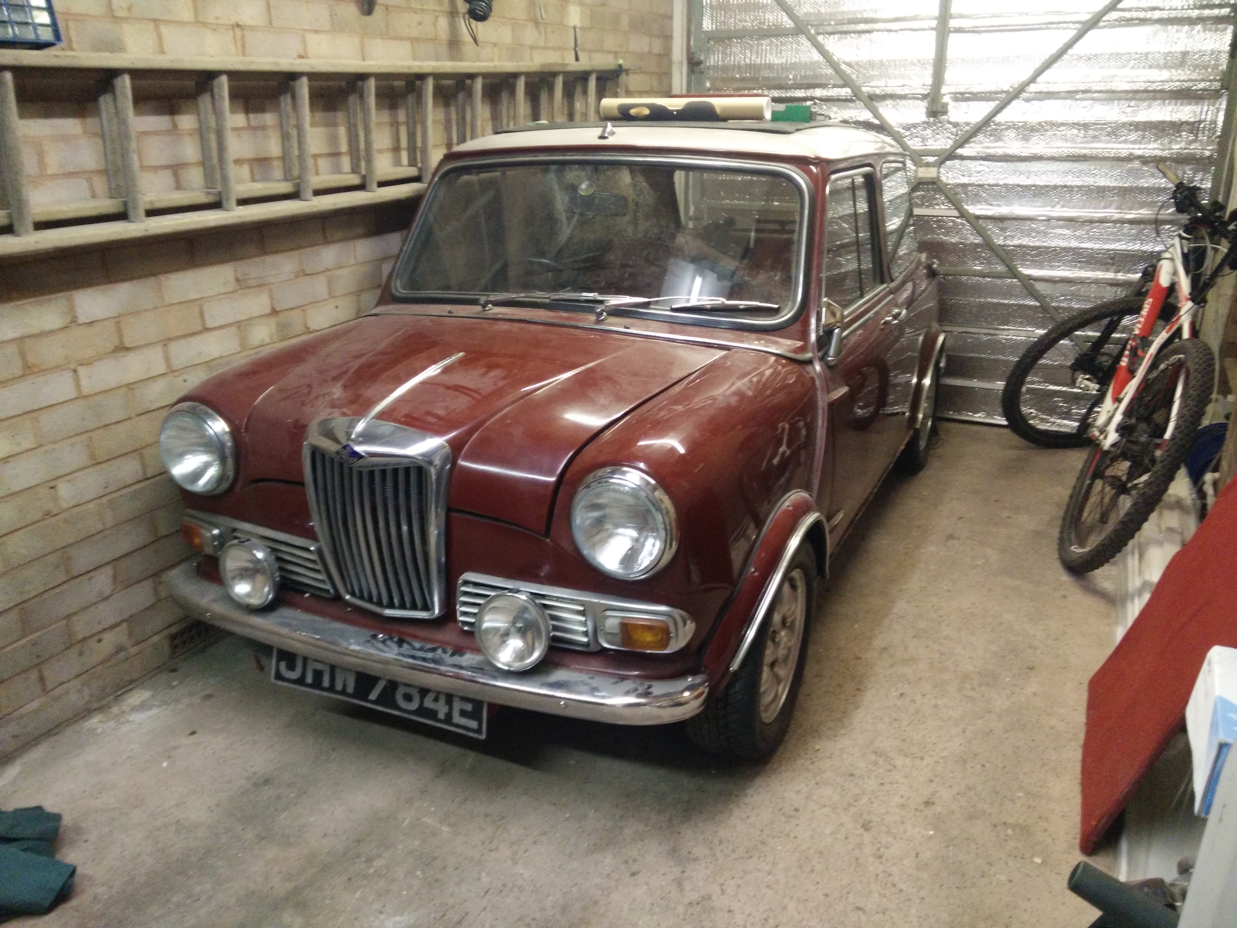

Introducing my Riley Elf. It has been off the road for three years. Usual turbo tomfoolery.
Started off with a MG Metro engine with a SPI block, MED crank, which I then opened up the chambers and fitted bits from a Metro Turbo to it. Was great but idler gear lunched the casing, fitted straight cut drops.
Wound boost up.
Downfall came after export radiator fan exploded taking out radiator. Cooked engine. Suspect from lack of compression on no. 1 is due to broken piston ring lands.
Then split up from partner, got a new one, had to buy new house, fix it up and had a daughter who is just 8 weeks old. Three years passed....
I have been quietly been acquiring parts. Got a mega-jolt, some 1293 pressure cast omegas, 307 Pug intercooler, BMW undercrown jets, also got ARP rod and cap bolts. IWIS simplex chain.
Going to buy 4 pin diff.
Got a Mitsubishi Turbo off a late Classic SAAB 900 to fit - same stud pattern as Garret. I plan to convert to dry deck.
What i want to do is build a tough power unit, that could survive a blast across Germany - do a ten min lap of the ring and drive back.
Hoss
HOSS

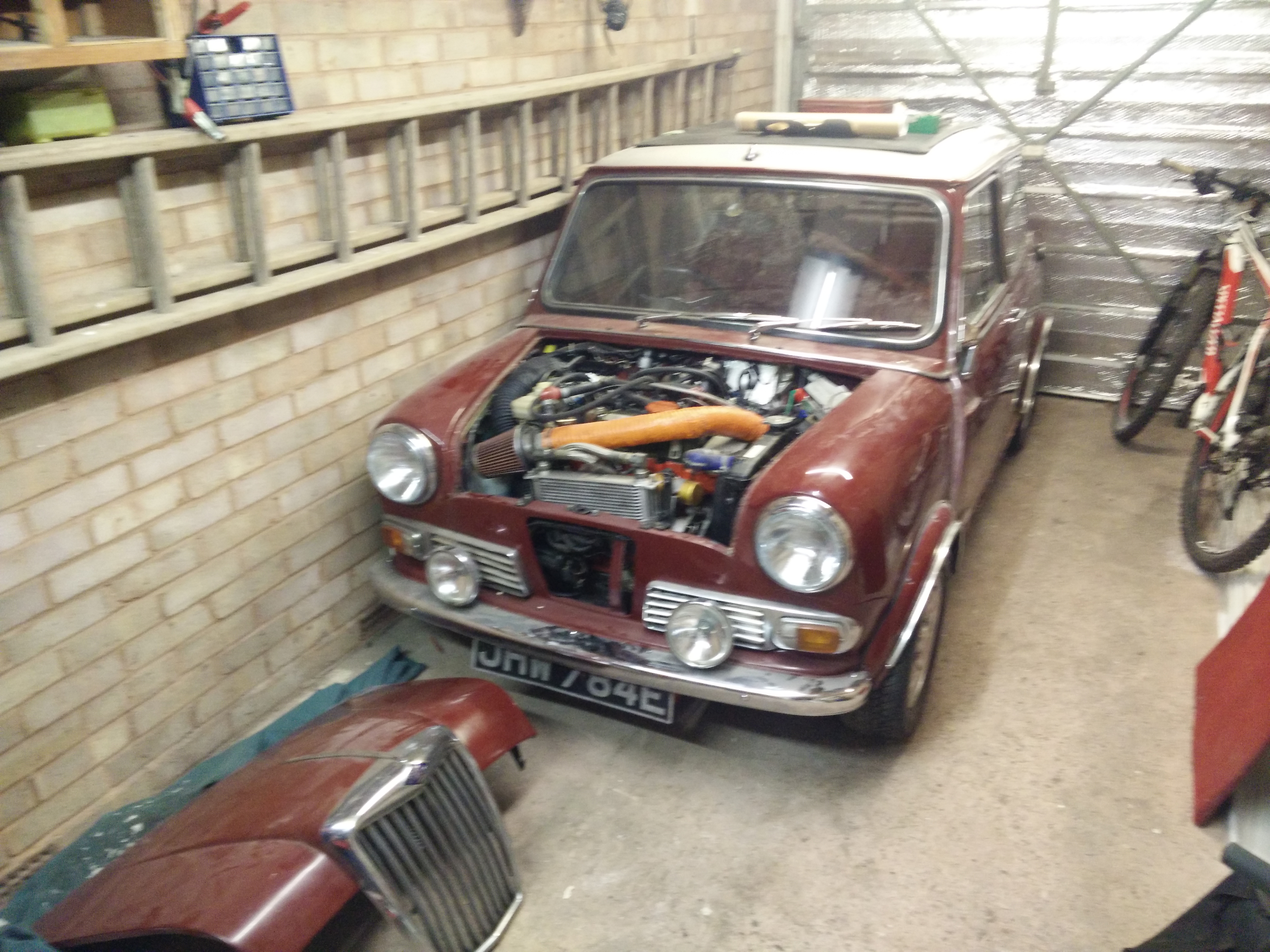

engine bay

ready for the tinkering to commence.

Nice car, I have an Elf put aside for a turbo job in the future. You have the oil cooler where I am hoping to put an inter cooler. Does the bonnet cross member clear the carb and pedelumn chamber.

Only the fixing nut of the plenum touches the bonnet cross member. Cut a 10 x 10 mm whole in cross member for clearance.
I am thinking about cutting some bonnet vents above the carb, had some issues with heat soak. I have a copy of the ERA bonnet vent to cover said holes.
The oil cooler is too big. Going to fit smaller one lower down, once I have ditched the distributor. The intercooler will go where the oil cooler currently is.
