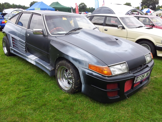

Denis O'Brien.
One for Turbo Dave
That’s a joke surely??? *Sick*
