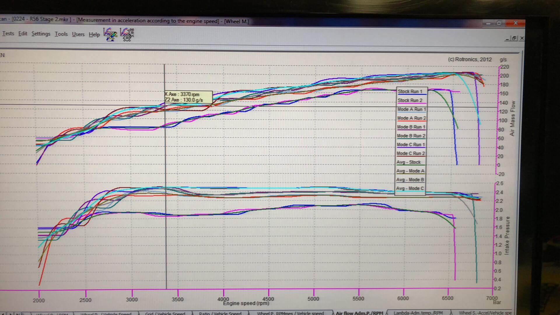

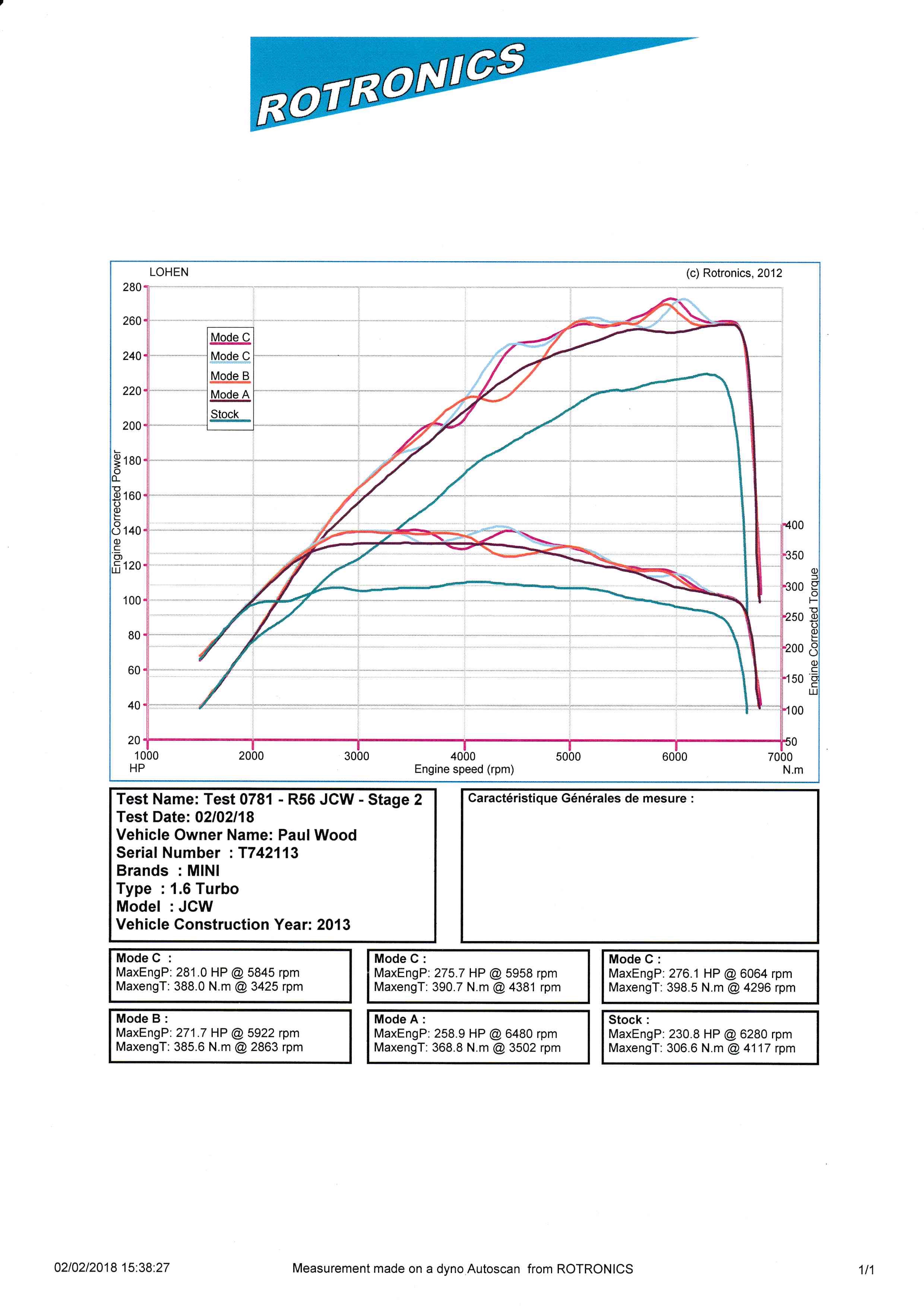

That curve should just go fine not all wavy. only thing i can think it is, is the High pressure fuel pump isnt keeping up.
5th Feb, 2018 at 08:06:11pm
I reckon its inaccurate rpm measurement and the software trying to draw a line through the points in the wrong place. Saul Bellow - "A great deal of intelligence can be invested in ignorance when the need for illusion is deep."

theres a lot of potential reasons for this assuming its not a measurement error as paul suggests.

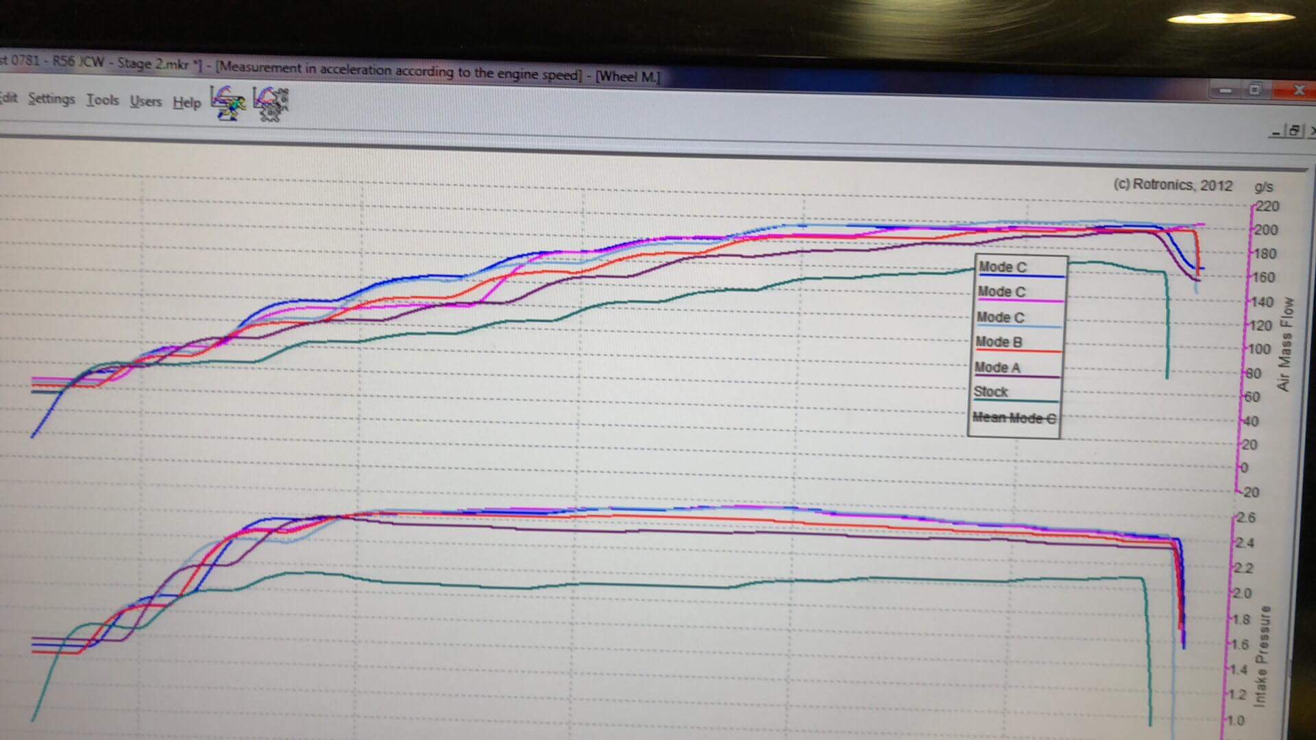

Here are the graphs showing intake pressure and airflow, AFR isn’t in graph form but after looking at the figures with the dyno operator, nothing seems out of place.

those graphs make me think of this :

Haha yeh it looks a bit mad, tbh I want to go on a different dyno anyway to see if the figures are any different so will ask for a full data log there. |
