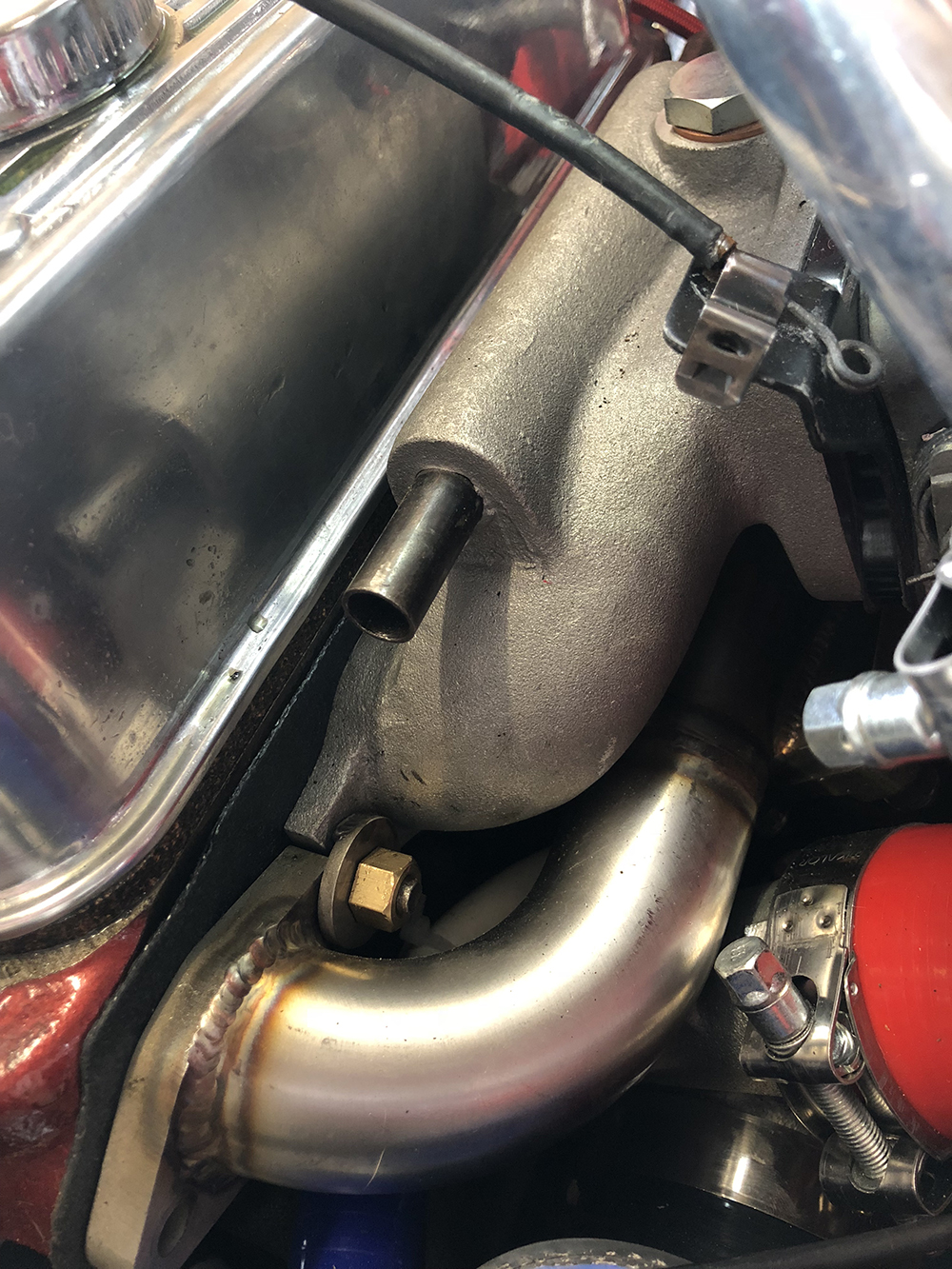

Hi all,
As per title and per pics below. The inlet manifold that came with the SC 5 port kit sits around 10mm too high and fowls the manifold. Is there a common inlet manifold that fits with the fusion fab exhaust manifold?

Metro Turbo one fits.
I’m also sure the standard metro one will fit.

4642 Posts
Looks like it's probably designed around the Turbo intake manifold, which sits completely different to most others. Unfortunately in terms of flow the Turbo intake isn't great, though it can be improved upon somewhat.
I'd have a word with Matty though and see what else will fit. If you can run the NA MG manifold that would be a better option.

I use the high flow one from moss Europe and it fits perfect
Phil.
Cheers Phil,
Both Matty and Jonny think the NA inlet manifold fits. So may go that route!
Will, have you any pics?

Does that pic help?
Just bolts on no problem lol

Yours might be an ever so slightly difference design to mine, however I've just bought one from Jonny so that'll sort it!
