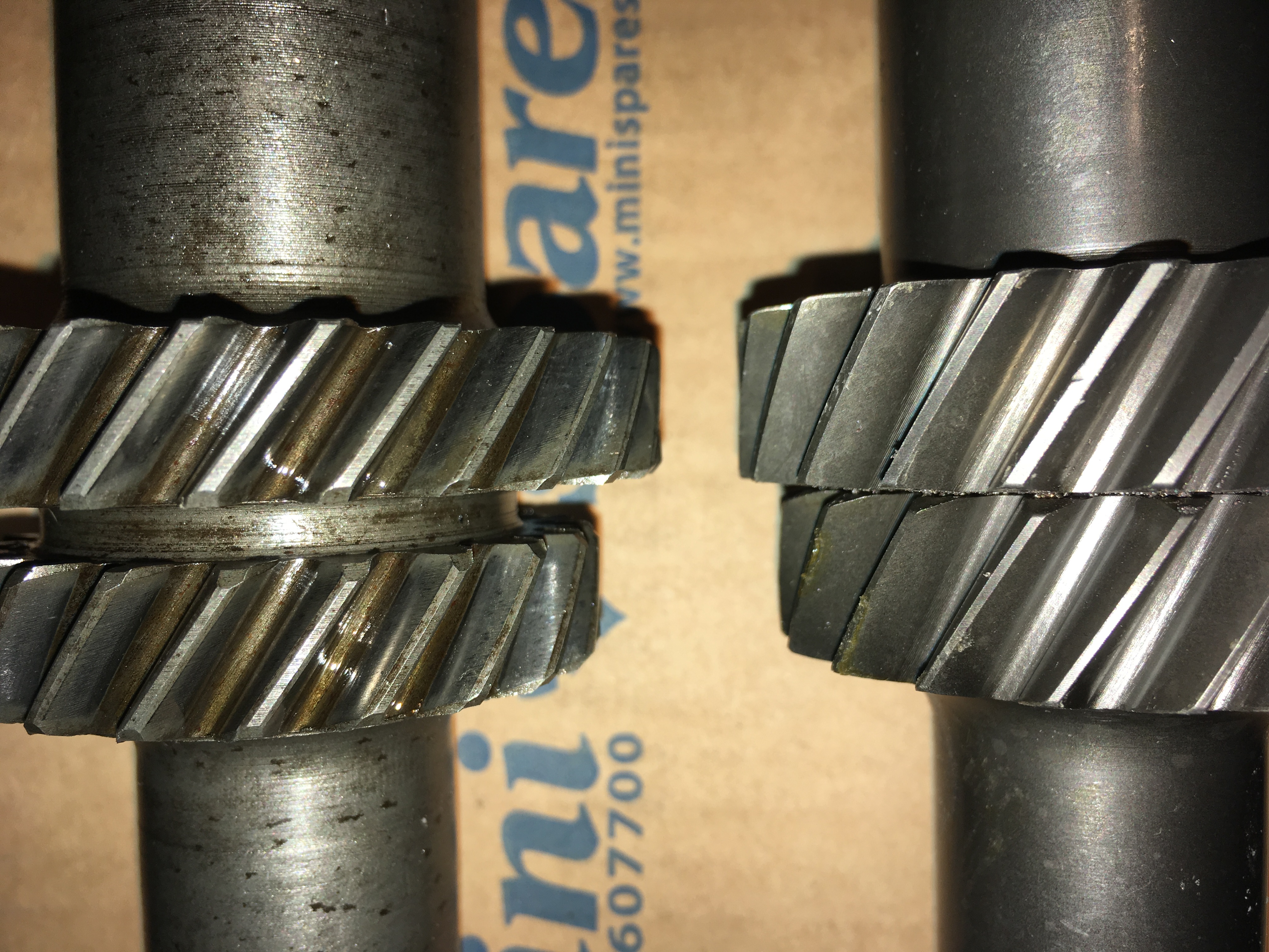

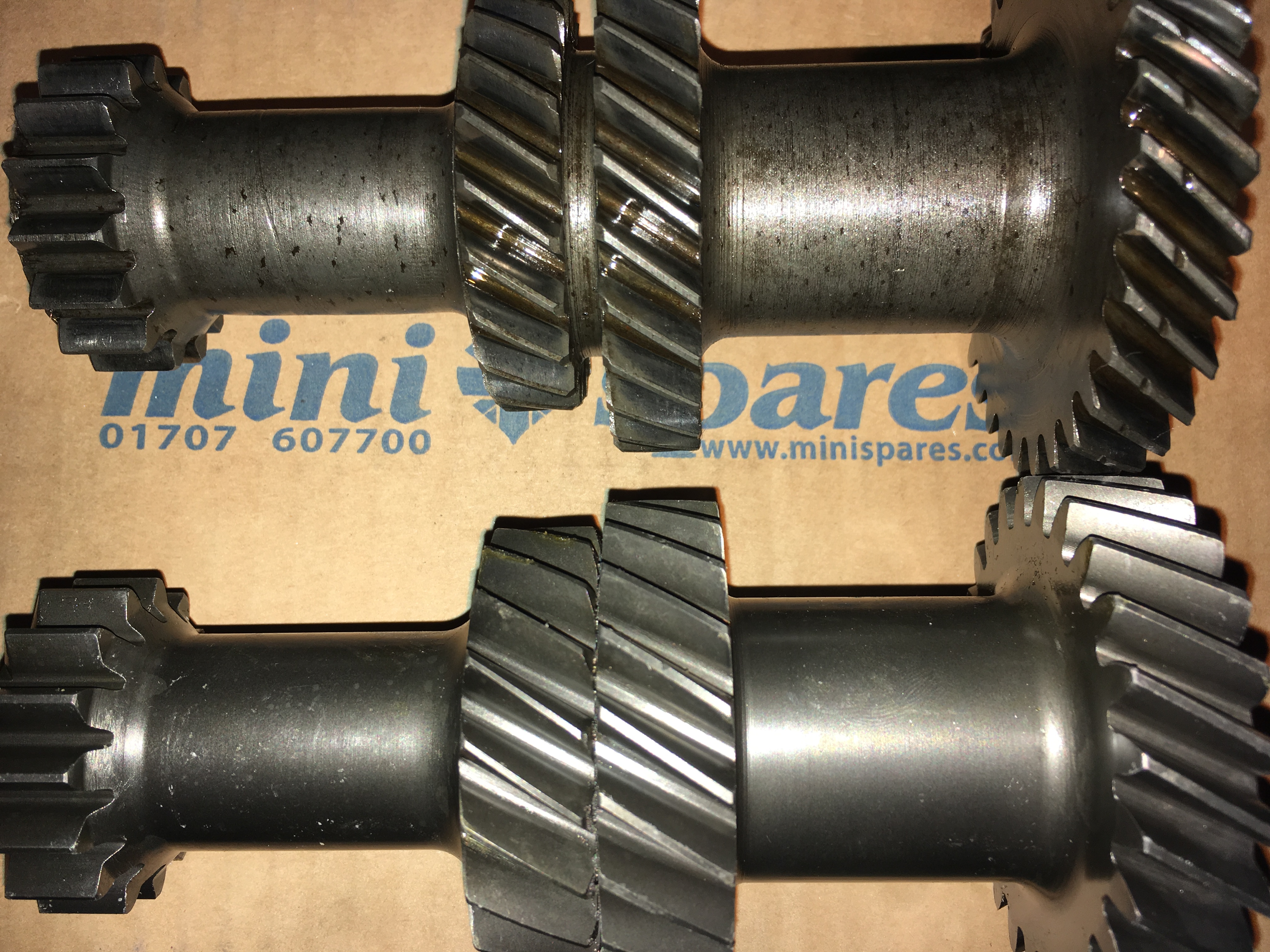

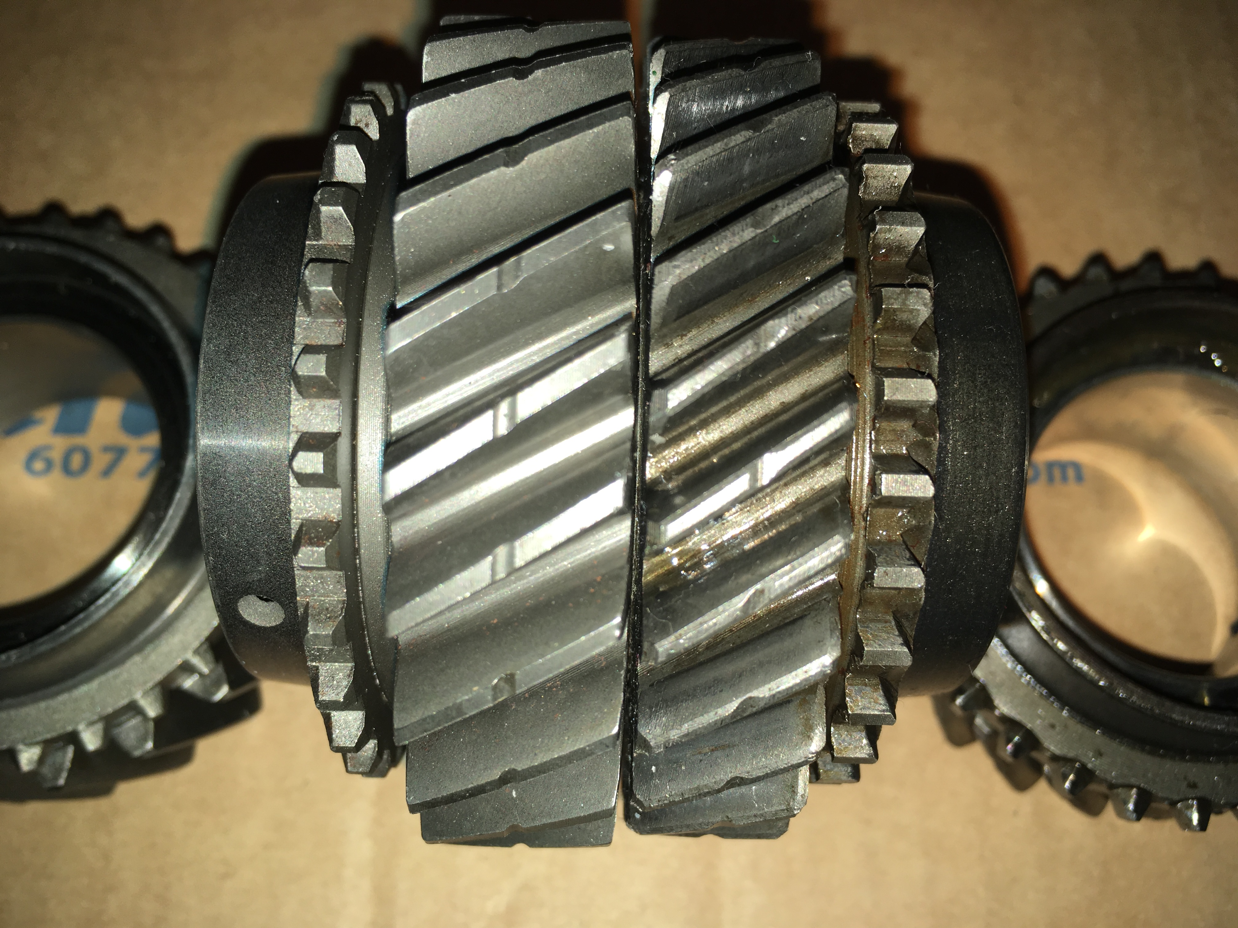

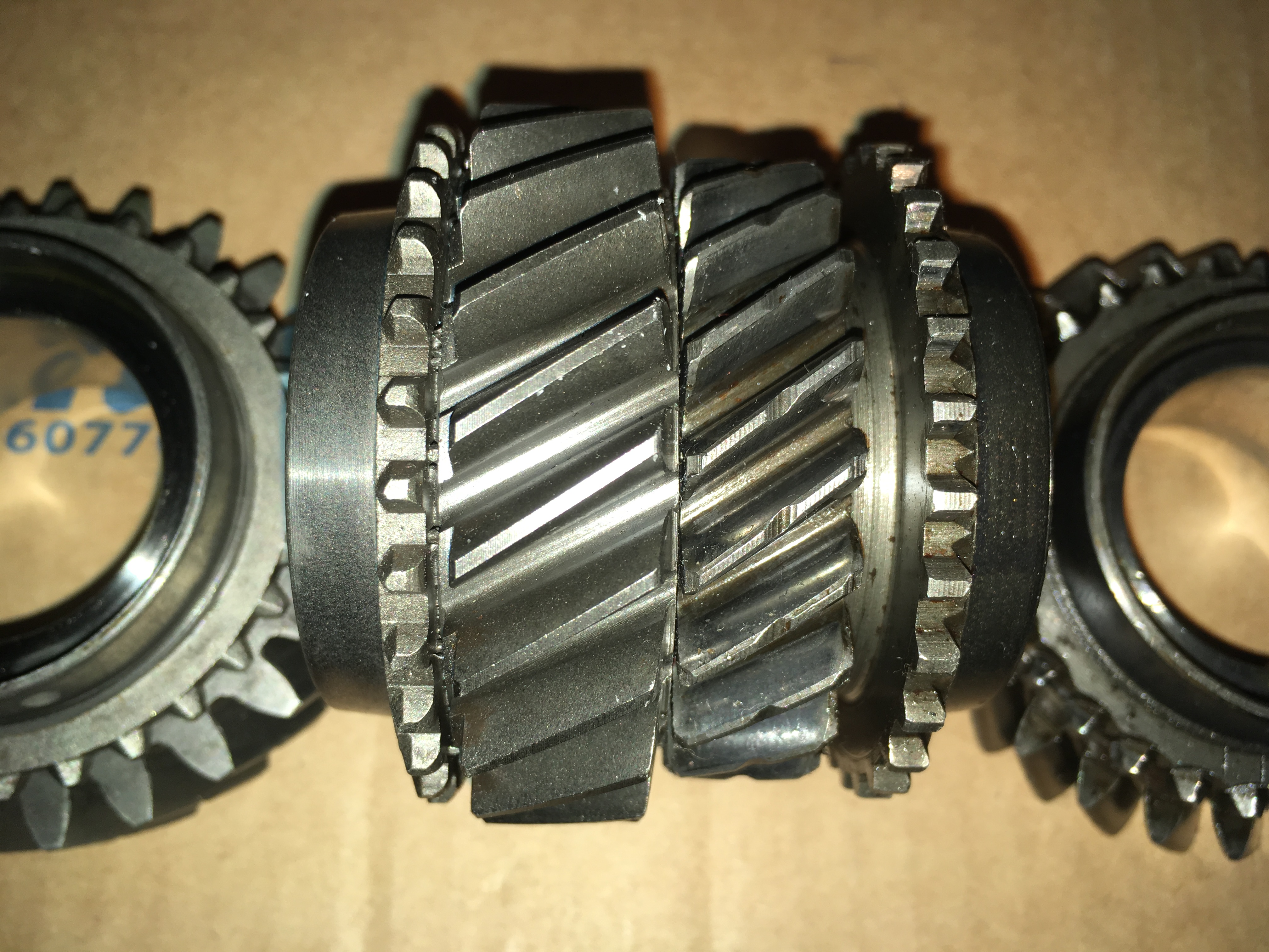

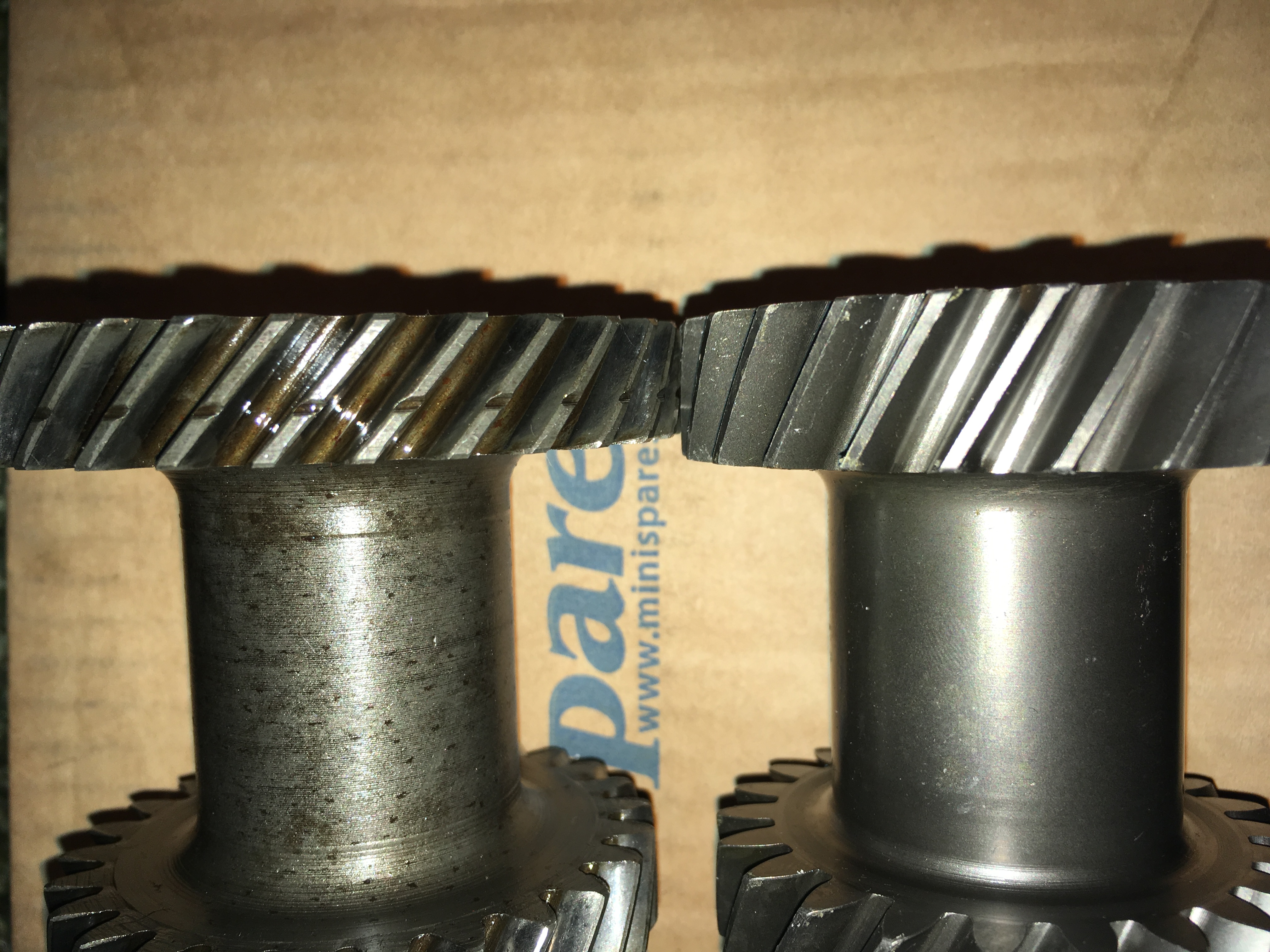

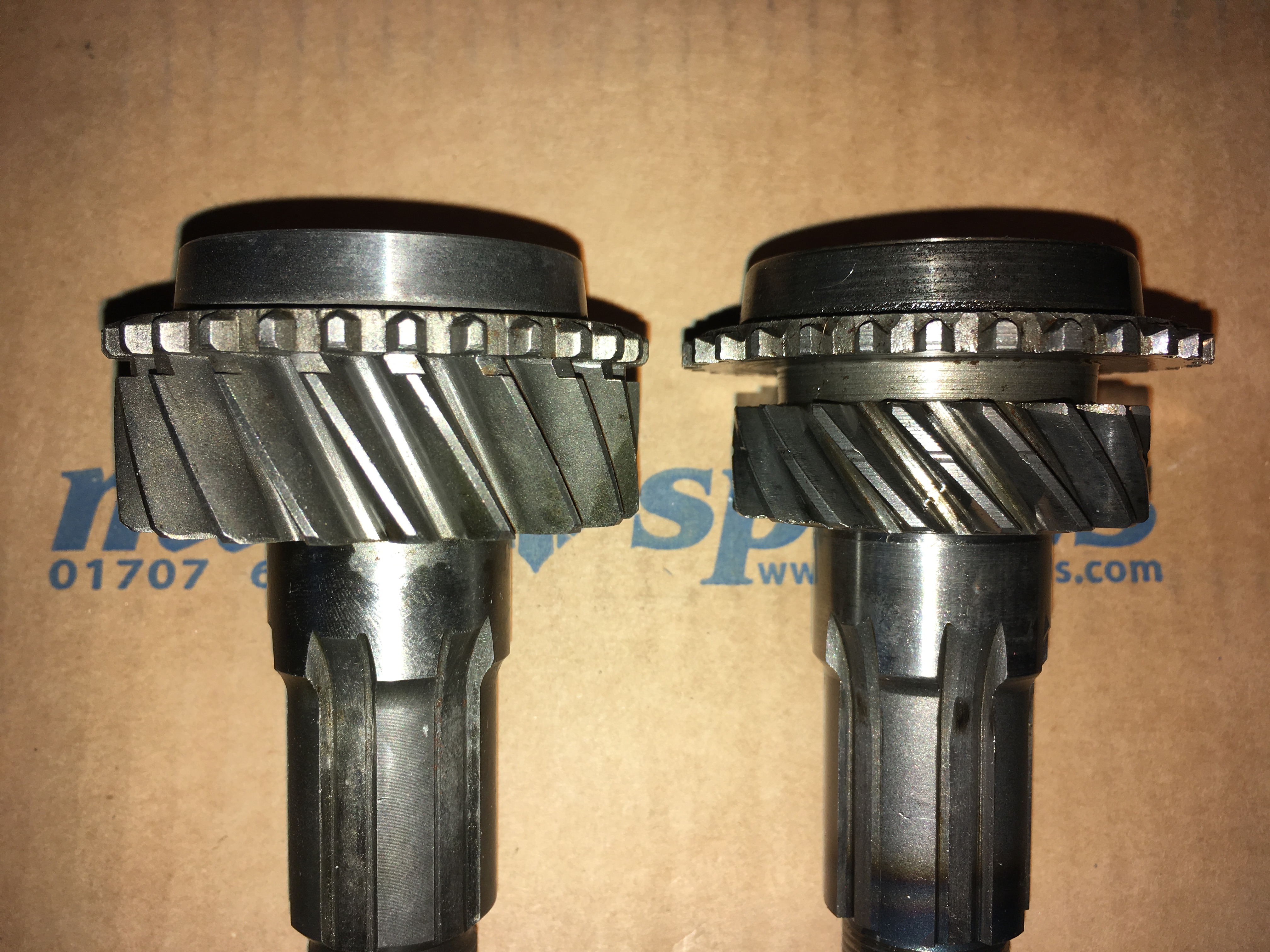

I've just taken delivery of one of these, and it looks pretty good. The gear ratios are very similar to the Clubman gear set with only second gear ratio being a little different. Should be interesting, might be able to hear myself think :Hehe:
Pictures show comparison with a standard ratio A+ gear set

Wow. I didn't have a lot of faith when I first heard of these, but WOW!
The pic on the minispares website don't do these justice!
Looks like they've been helical broached (many cool vids of this fantasic proccess on youtube that modern CNC has made so much easier) but looks like they've left a few slithers for you to de-burr on the edges of the 2nd gear? Definitely want to get rid of those!

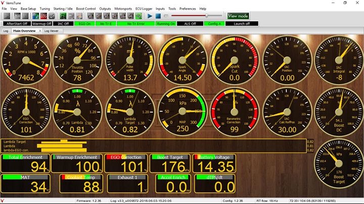

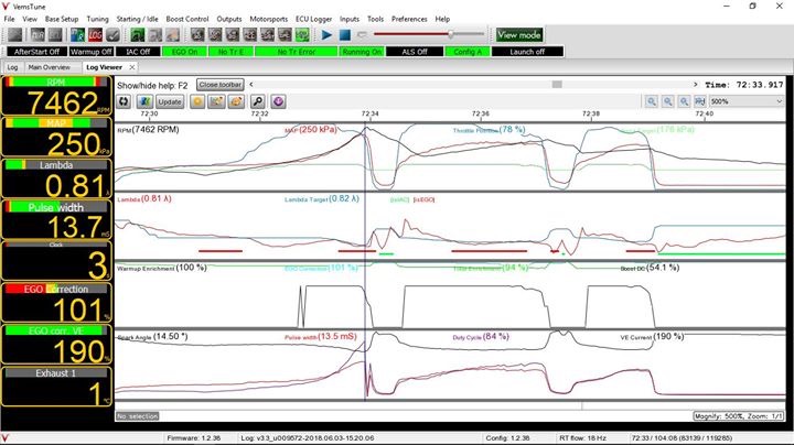

Went on a road trip at the weekend and the gearbox went great, such a pleasant drive.
Durability wise, we’ll have to wait and see but it should be hugely better than the standard gear set if not equal to the clubman straight cut gear set. I’ve already seen 21psi boost in the data logs but 15psi mostly.

Yeh! I was surprised too, but it’s more of overshoot than of intended 😲
