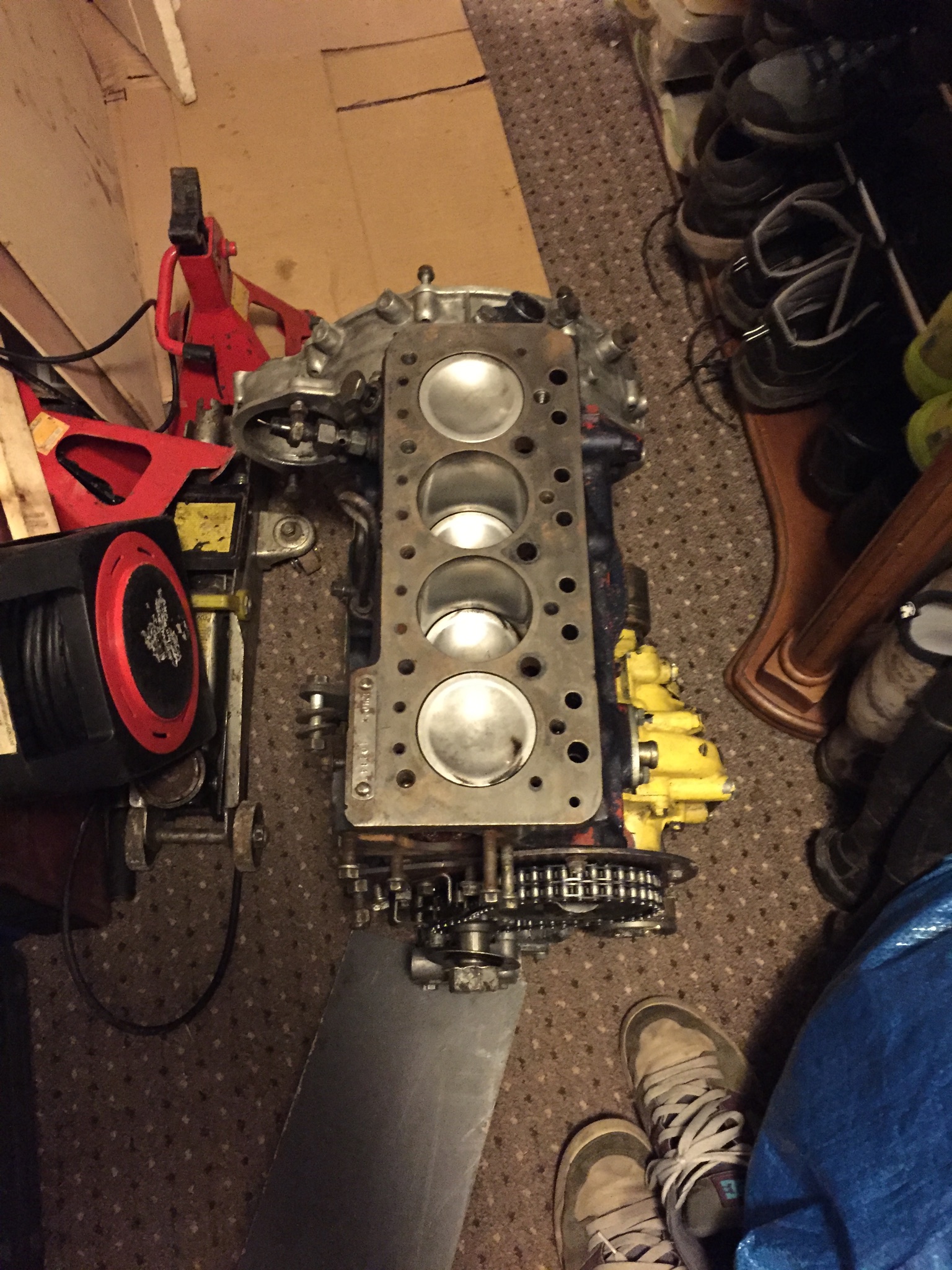

I'm riding a turbo metro engine to my mini.
Around here there is little information and spare parts for this project.
Before mounting the motor I would like to rectify it whole.
Can you please recommend that pistons go well and where to buy them?
Any help would be valuable to me.
Thank you very much in advance

What engine do you have ?
What engine do you intend to use ? size, model ?
Need more details

Hi. Thanks for answering.
The engine is the 1275 metro turbo standard.
I add photo in case it serves as a guide.

4642 Posts
Depending on your application. The cast Omega 10cc pistons from MED are excellent and adequate for road use, and track (boost dependent) or if you're on a tighter budget the 21253 can be dished out and have proven to be a decent piston. Or go to the forged Omega, as good as it gets off the shelf.
Phil.
4309 Posts
If they pistons and cylinders are in good condition and to size you could just re-hone the cylinders and fit a set of total-seal rings.

If the standard pistons are in good condition....there really isnt a lot of reason to change them.
They may be ugly, but they're strong and well proven.

First I will disassemble and measure the pistons to see if they are fine.
A greeting.
