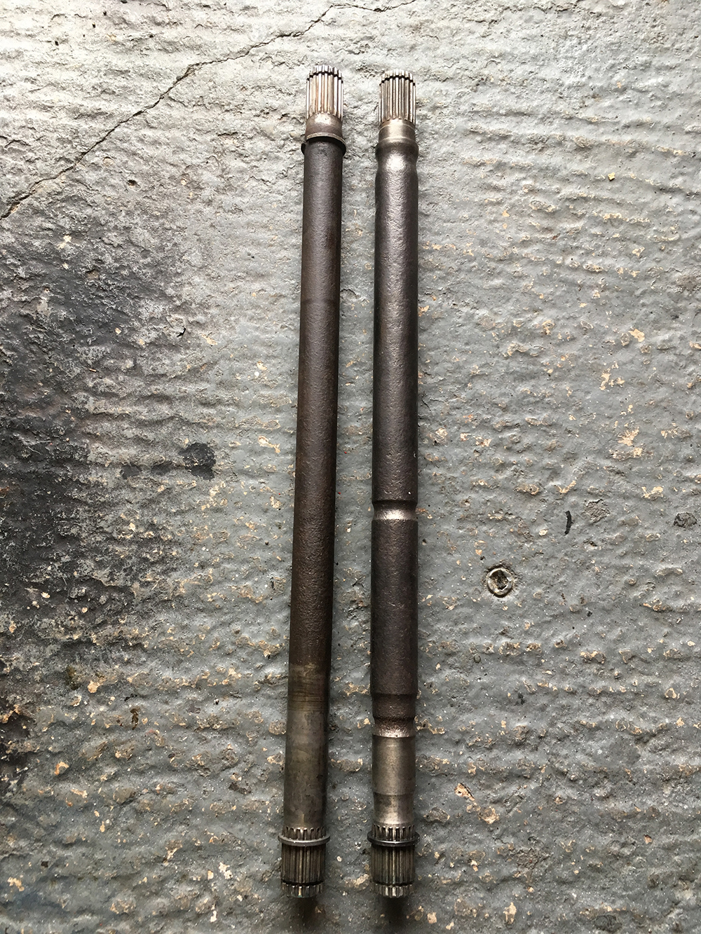

Ok so driveshafts. There have been a few different shafts over the years, and many say that the standard shafts are perfectly useable in high torque turbo applications, that’s all fine. Looking at the driveshafts that came with my 1995 SPi they are different again. Rover had simplified their manufacture. The shaft is a consistent diameter over the entire length, roughly 22mm. They only narrow down slightly at the splines to roughly 21mm. At the pot joint end instead of a seat machines into the shaft, there is a ‘C’ clip similar to the clip at the CV joint end.
The common pot joint shaft is roughly 25mm at its thickest along the majority of the shaft but is reduced down 5 times along its length. The narrowest point is near the cv joint end where it is reduced to under 20mm.
All things considered, if the late shafts are made from the same material they should handle the torque a little better allowing any wind up in the shaft along its entire length rather than focussed on one of the reduced diameter points along the length of the more common shafts. The ‘C’ clip groove will obviously still be a weak point, which I’m not so worried about really as it will likely act like a fuse in what is a rather expensive drive train😆

It was a cost saving exercise in the early mid eighties. Only lasted for a couple of years, before they went back to the larger size. Read into that what you like but i've never seen a shaft of the thinner variety break.
There were thinner shafts on 998’s. The 1983 Mayfair I had was fitted with shafts that narrowed right down, thinner than these late shafts.

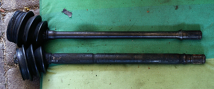

I got some drums n shafts off an early 80's mini the other week n ive never seen shafts so small...
Nothing gets past Dave lol
The Drive flanges are alot thinner as well iirc
