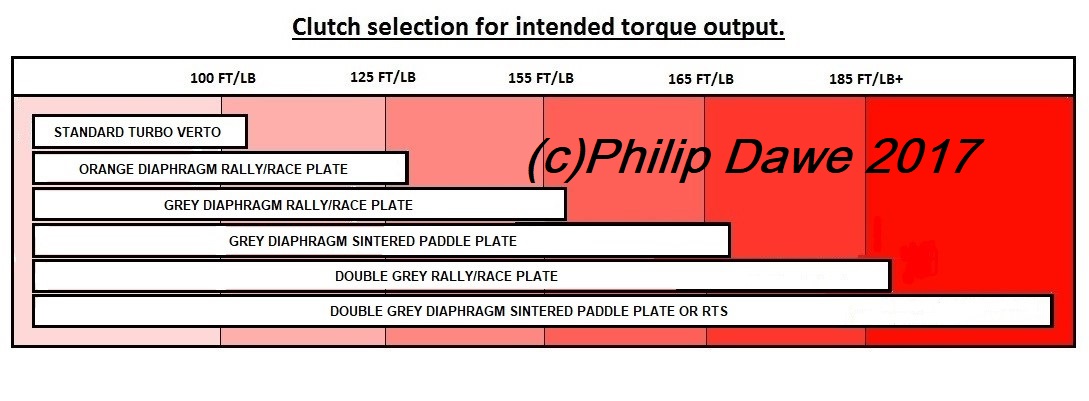

I made this a while ago & would appreciate communal feedback on it's accuracy. From my own experiences I don't think it's a million miles off, but would appreciate some opinions from others.
TurboDave has already suggested the lastest turbo Vertos are closer to that of the Orange pressure plate @around 120 ft/lb.

What's there is good guidance and roughly my experience.

Thanks Wil.

It’s interesting the effect of the paddle plate vs traditional.
Seems the orange limit varies a bit too. Isn’t windsurfer on here running 150 1b/ft with one?
That said I will expect to be changing clutch plates out regularly so the wear effect on clamping is probably not such an issue.

I guess the way the torque is delivered will have an impact on it to. If it all comes in a big rush, or more progressively.
