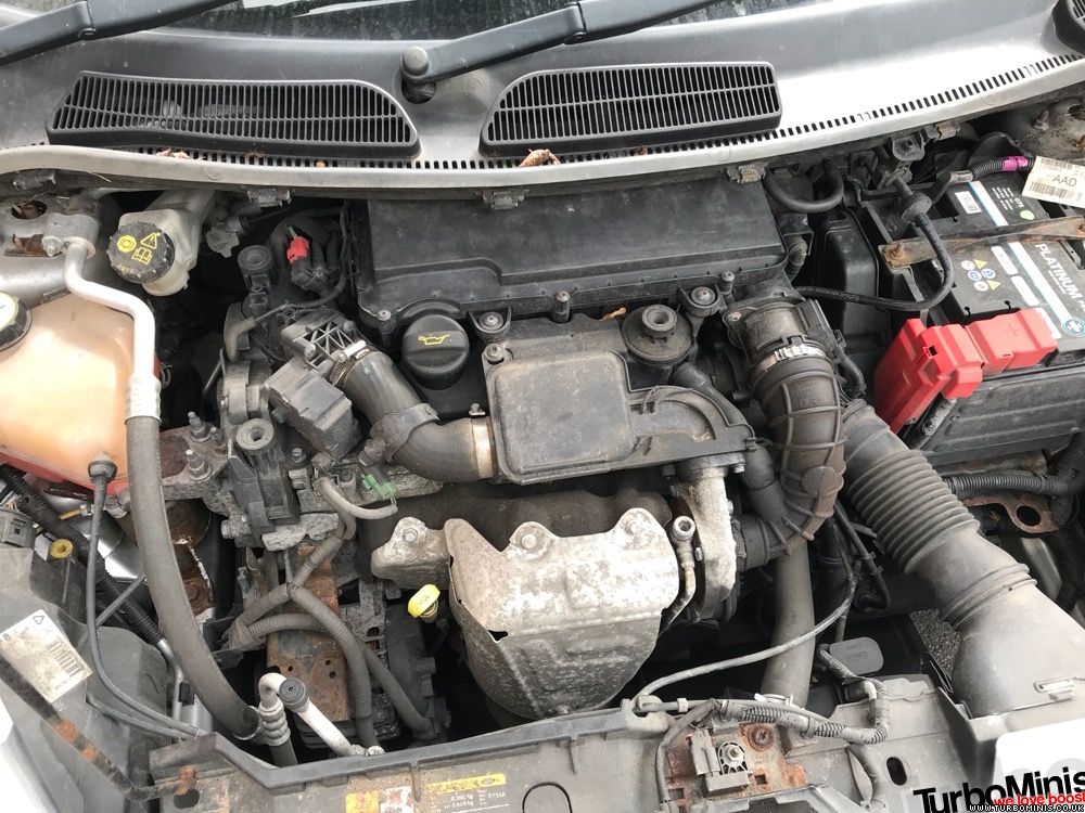

Well, here is a pic of the engine room.
Certainly looks like injectors are buried.

yeah that'll be the earlier Siemens system, if there's no evidence of carbon buildup around the non-offending injectors you can leave them as-is. I always change the seals but I have to warranty my work lol you don't technically have to but I highly recommend you remove the wipers and upper and lower scuttle panels it will greatly improve access. and remember the two bolts which will be hidden down the back of the inlet/cam over . you have to pry fairly hard to remove the inlet so easy to snap them if forgotten. you can also start the engine with no inlet if required while diagnosing(for example to do a leak off as suggested) you just need to put some card over the exposed camshaft and make sure nothing falls down the intake ports lol
