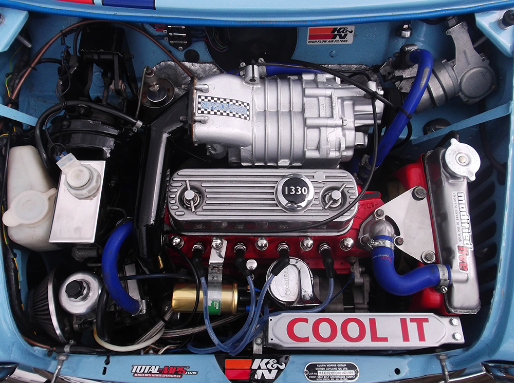

Hi I'm new to the forum. Not sure if anyone can help. I have a 1330cc Mini with an Eaton M45 Supercharger. Stage 4 head. Kent 276 cam. etc etc. The problem I have is the manifold pipe between the SU HIF44 carb and the inlet to the supercharger is pointing the carb towards the offside inner wing (yes strange, I didn't fit it). What I am looking for is another manifold pipe to re-direct the carb to the front of the engine bay so it can get more air to be able to breath better. Can anyone help? Many thanks. Clive
I'll be honest, thats a pretty ugly looking manifold with those sharp turns, but I think you already know that.
I would suggest geyying in tyouch with Alex at the car kitchen, i know he's done a few of these installs so can probably so somthing suitable without an issue.
https://www.facebook.com/thecarkitchen/
It might look odd, but I can see why it's been done. I doubt you gain anything by making it straighter.
I presume it's running an electronic programmable distributor (like a 123 etc)? If not, there is much more to be gained from that.

Ok will try the car car kitchen. I can get a new pipe from Jonspeed Racing but it's a 3 to 4 week wait. Don't mind waiting but if I can get one sooner all the better. It's got an Aldon Electronic Ignition.
Is that the Aldon Amythist (SP?) mapable system?
Efi?
