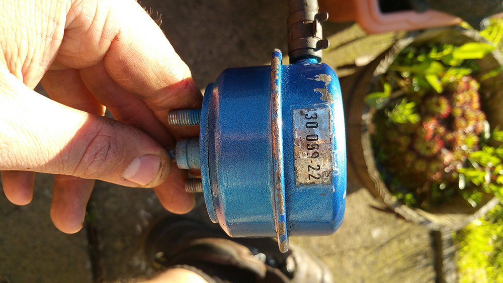

Hooked the tyre inflator up the the actuator in the best heath-Robinson fashion, starts opening at +/-2psi, fully open by +/-4. The gauge isn't 100% accurate, but I think it may be reasonable to say the actuator has had it? With the actuator removed I can pull the rod out relatively easily.
I've put a pic of it on, I don't know if that number helps identify it at all?

OEM actuator is soft...although yours sounds a little too soft.
Was it installed with any preload on it ?

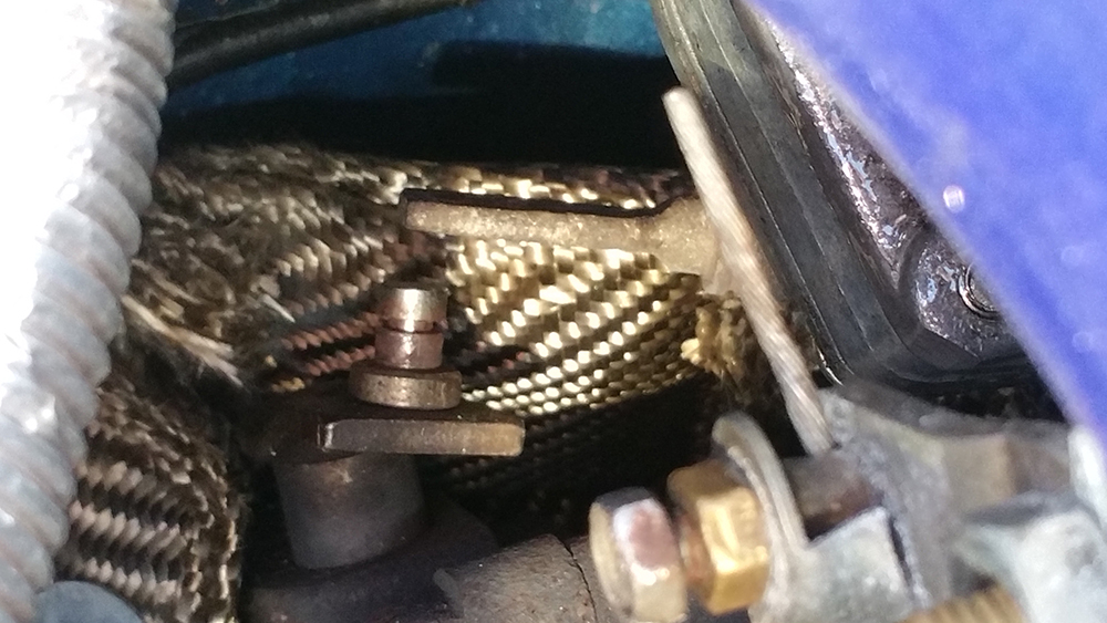

I've popped a pic on of the preload, around 3-4mm thereabouts, the waste gate is closed in the pic.

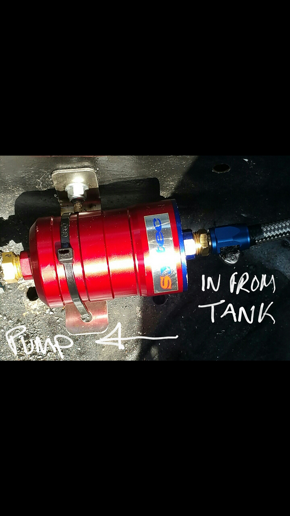

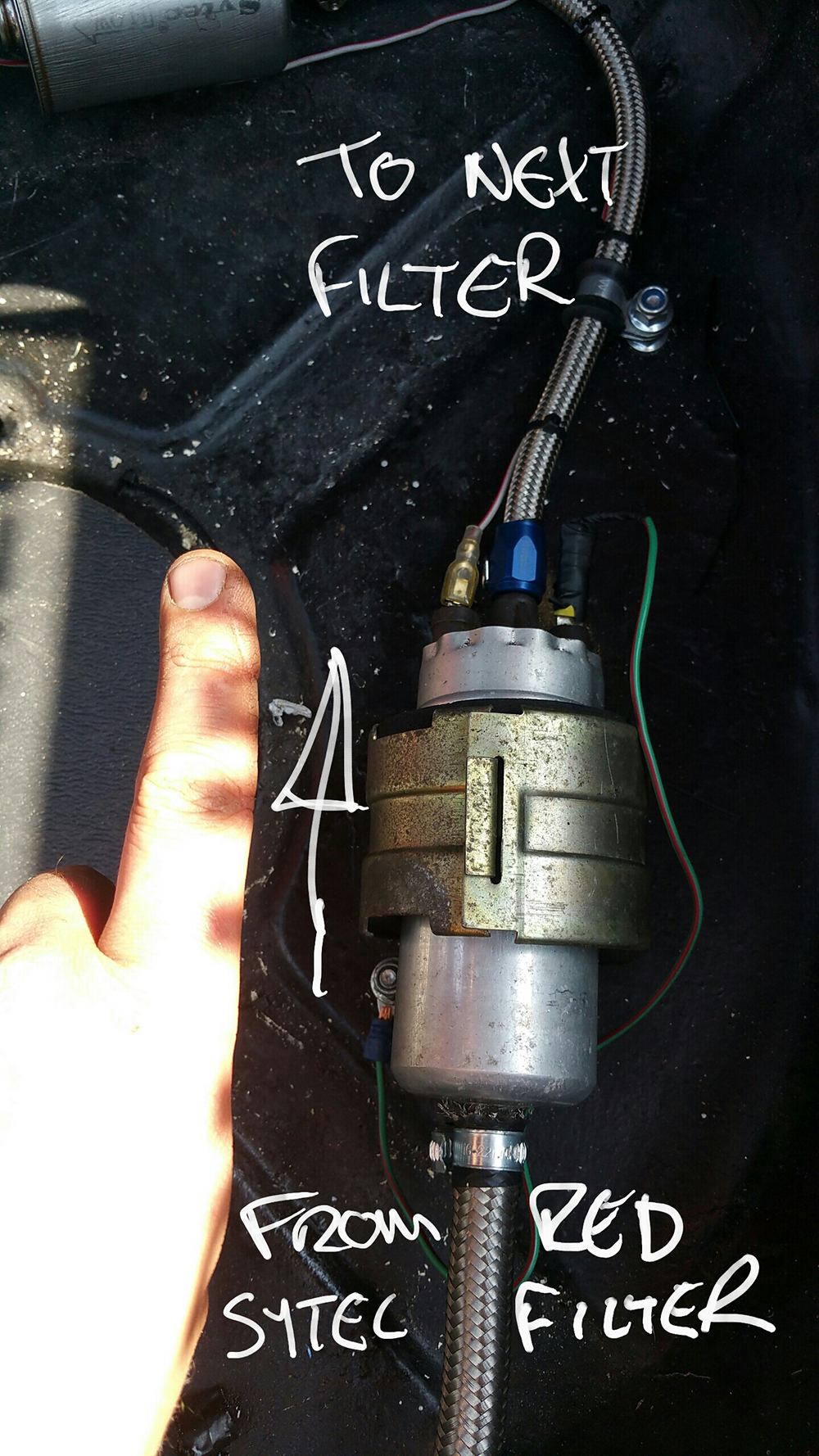

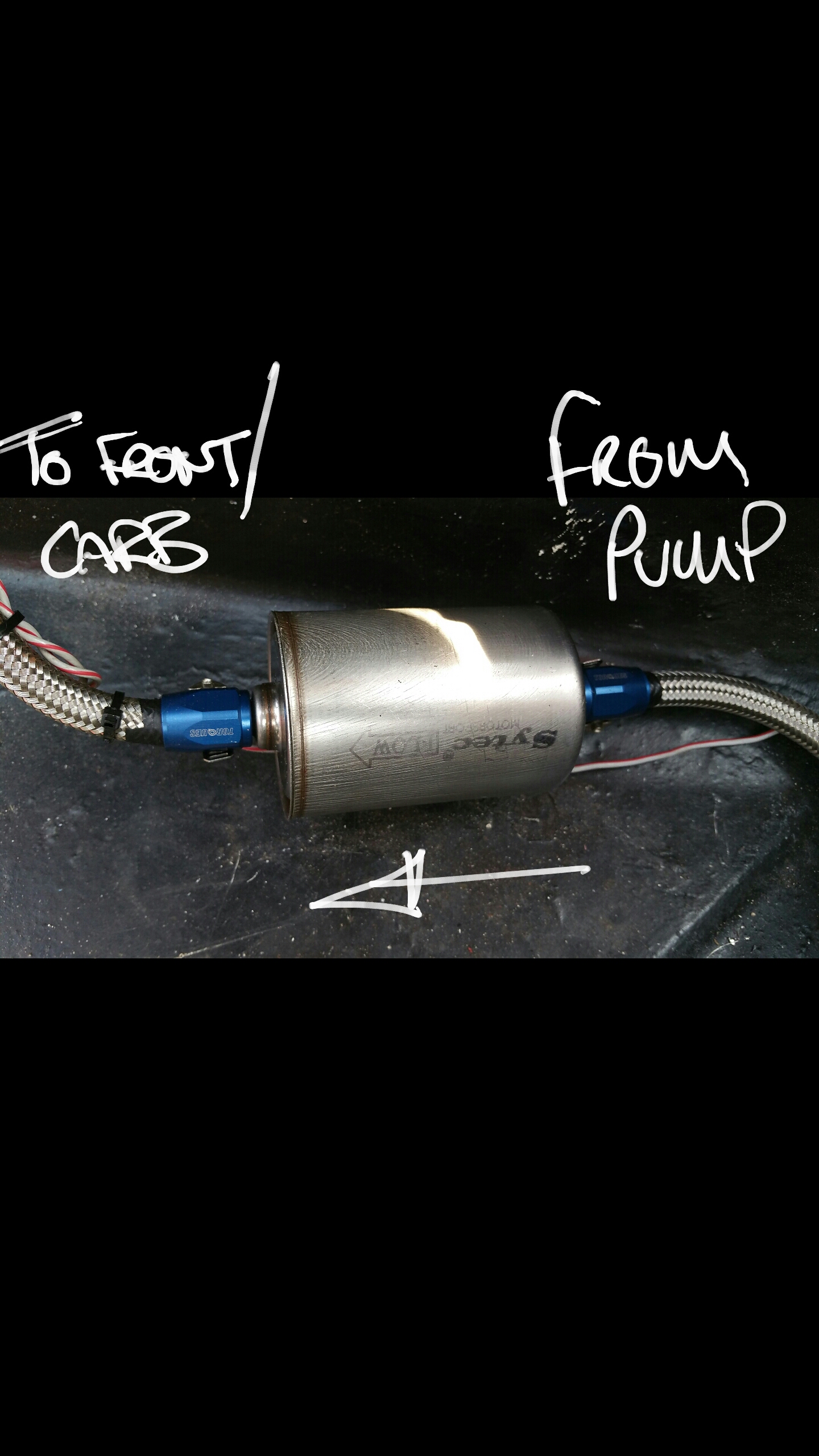

I've still got the cutting out issue though, the more I look the more it seems to be fuel starvation. (I've swapped the coil for a known-good one just to eliminate it) It seems to do it when it's hot and under load/making boost. Once it's coughed, spluttered and died, the pressure gauge drops down to zero, then takes ages to build back up. I've whipped the fuel cap off and it's not vacuuming the tank, I know stevieturbo said above the Sytec filters are no good in front of the pump, is it possible the filters are strangling it? I know the obvious thing is to whip the filters out and then try it, just wondered if anyone's had this?
Ben5004
33 Posts
Member #: 11676
First filter between tank and pump
Ben5004
33 Posts
Member #: 11676
Pump
Ben5004
33 Posts
Member #: 11676
Filter between pump and carb
Whats the filter before the pump for? What type of fuel tank are you using?

It's the standard metro steel tank under the car, with a return added from the reg. Pre-filter just to stop and rust/muck/debris getting sucked out the tank and through the pump
4641 Posts
Is the pump mounted below the level of the tank ?
Phil.
Ben5004
33 Posts
Member #: 11676
The pump is in the spare wheel well Phil
4641 Posts
The pump needs to be mounted below the tank. They're gravity fed.
Phil.
As Phil says. Also pre filter unions look too small, the metro pipe from tank to filter was pretty large.
I know a pump pre filter is good practise but really I’d make sure your tank is free of shit and then put the pump back where BL intended as it’s known to work fine there.
