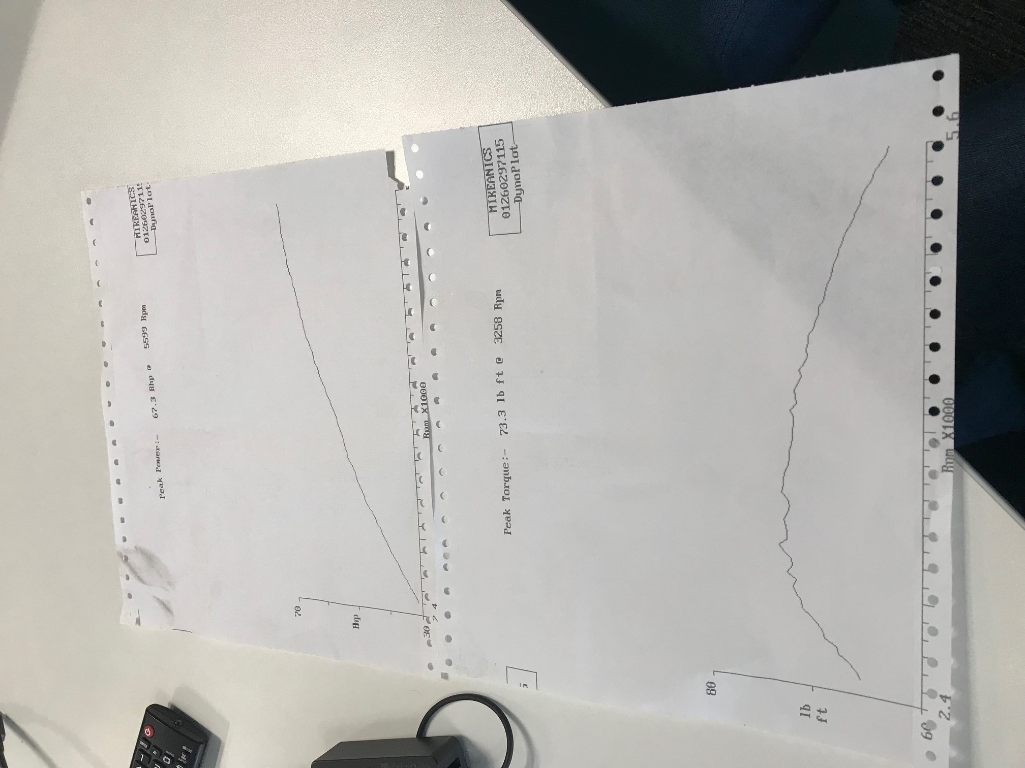

Anyhow it seemed to do pretty well, it was lean so needed a lot of work to the needle and got good power for a pretty standard 1293 NA just an SW5 cam, air filter and exhaust above standardspec!

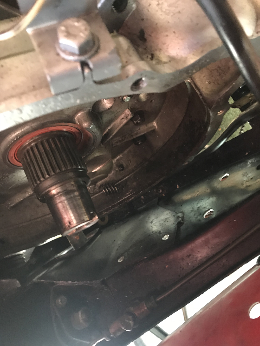

Yeah, the rattle stops when i depress the clutch as well! Can i pull the wok off without lifting the engine out? Cant remember as its been about 10 years since i last took one off!
Yes, disconnect the exhaust and clutch side steady (and front /rear lower clutch side steadies), engine mount bolts, and jack her up. Watch for radiator contacting inner wing. If you didn’t notch the bottom two PITA bolt holes in the wok, do so before re-installing, so you can wind the bolts in until they have a 11mm gap, and you can drop the Wok down in there. Absolutely the best thing you can do is to drill a few 20-25mm holes in the side of the subframe that aligns with the PITA bolts; easiest way is to make a paper template on the inside of frame referencing engine mount holes, then move to outside and drill thru with a hole saw or cone/step drill.

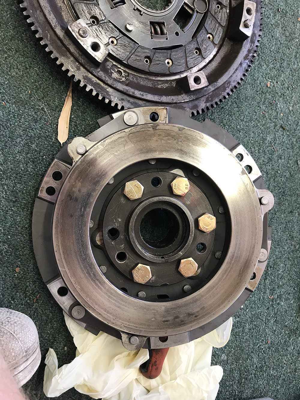

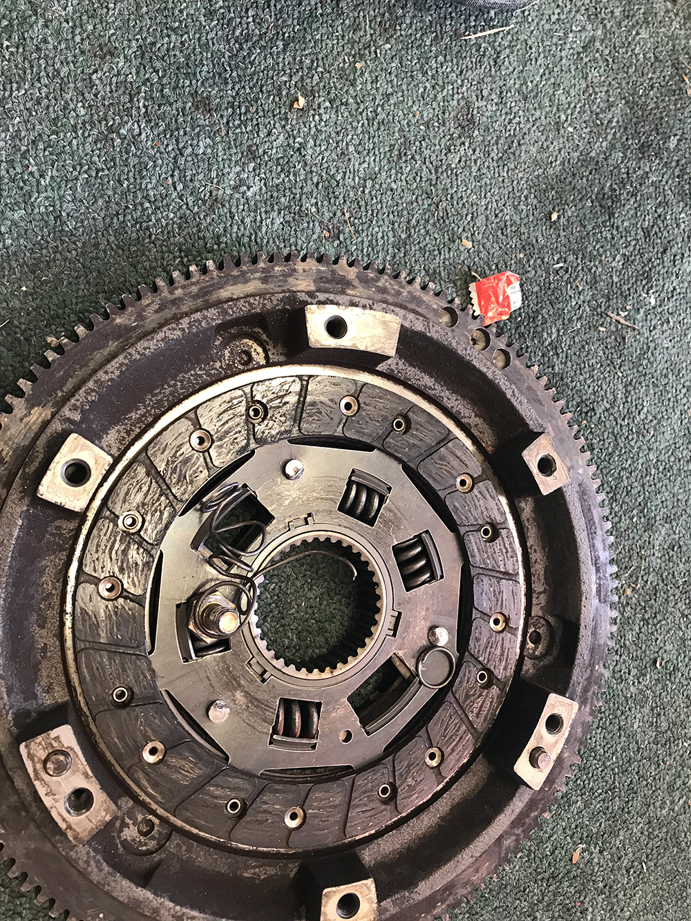

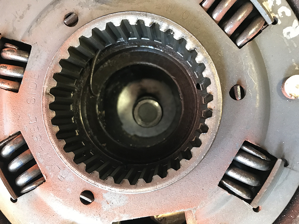

So, finally got the wok and clutch off today and the problem is pretty obvious! It looks like one of the bolts that holds the pressure plate together has backed it self out and then caught one of the springs on the friction plate, ripped it to its and ripped the remaining threads out of the pressure plate! Hopefully pics will upload and this was how it came apart! 3 of the remaining bolts in the pressure plate could also be loosened by hand so I guess it was a poor build! It’s disappointing as the engine etc was put together by a very well known builders!
So good news is it looks like it just needs a clutch plate and pressure plate. What’s the best one to get? It’s not a stupid power engine. The flywheel and housing are off an injection by the looks and all in very good condition still. Current pressure plate has a green spot on.
