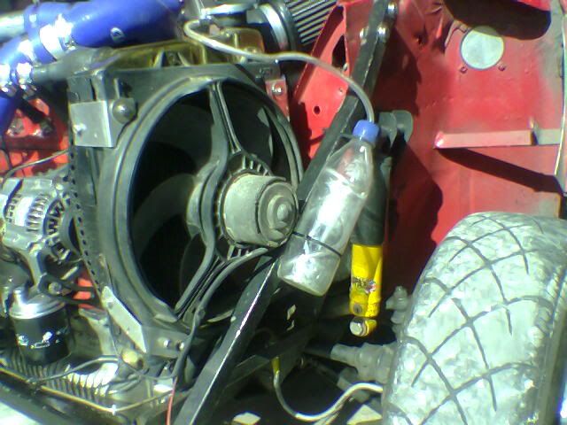

my over heating problems have gone at the mo
im using watercooler t2 plumbed in at the heater take off and top hose
mini spares 2 core rad
rover 214 fan with the shroud cut down to completely cover the radiator, sucking air through
no mechanical fan
std type water pump
ran at 190F round 5 thrashing laps of castle combe and around 170F on the 74mile journey back including getting stuck in traffic
