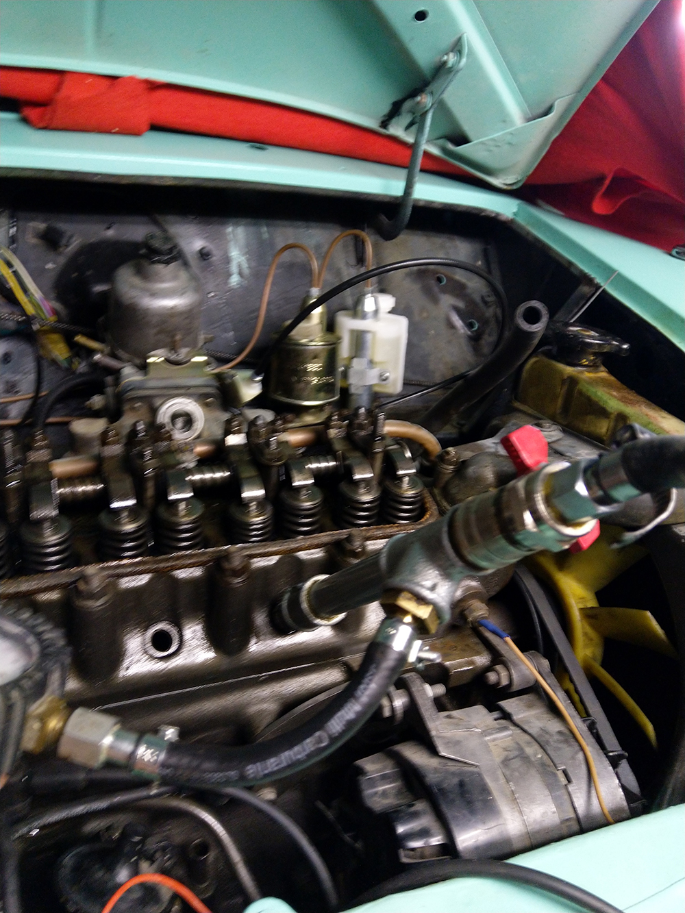

So in made this.
What in know now from putting 4 bar of pressure on each cilinder is that. If i donit on cilinder one i can see it leaking some air out of cilinder 4 ever so slightly.
Pressure on 2 i hear some air leaking into the inlet.
Pressure on 3 slight lost but undeturment where and probably just the tool because i can hear some air but the gauge stays on 4.
Cilinder 4 loses pressure straight down into the gearbox ( as expected since pressure on 1 made 4 blow a slight walm of air.
So Back to rings suspect.
Rammie2000

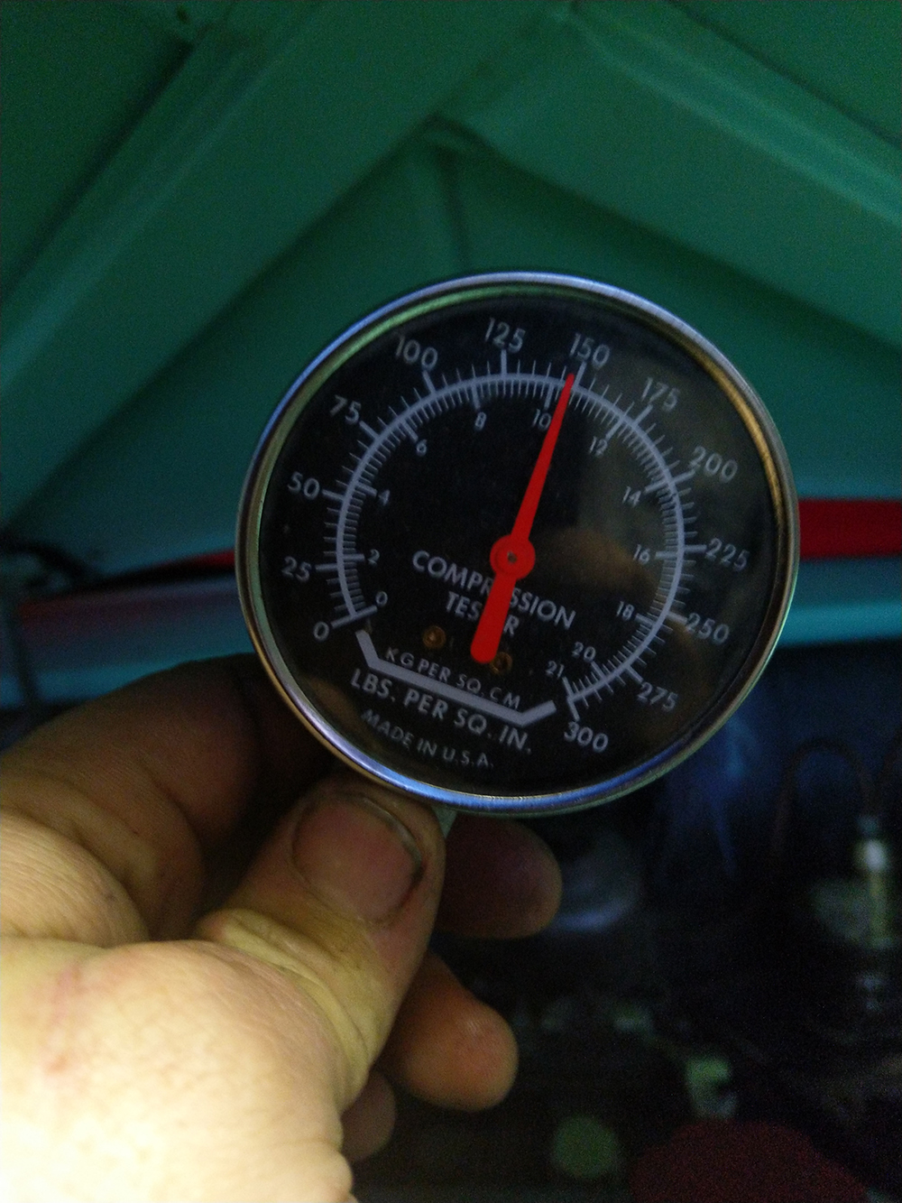

They all hold around 10 to 10.5 kg/cm2 so not bad for a 1100 engine

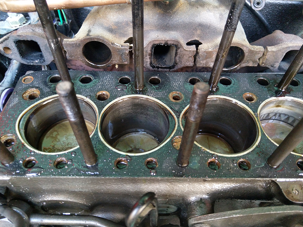

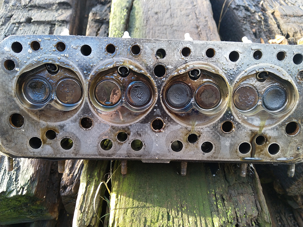

Valves wil have been the isue i guess top of head is coverd in oil around the exhaust valves.
Rammie2000
1751 Posts
Member #: 10190
belgium
Oil on Pistons but inlet deels dry.

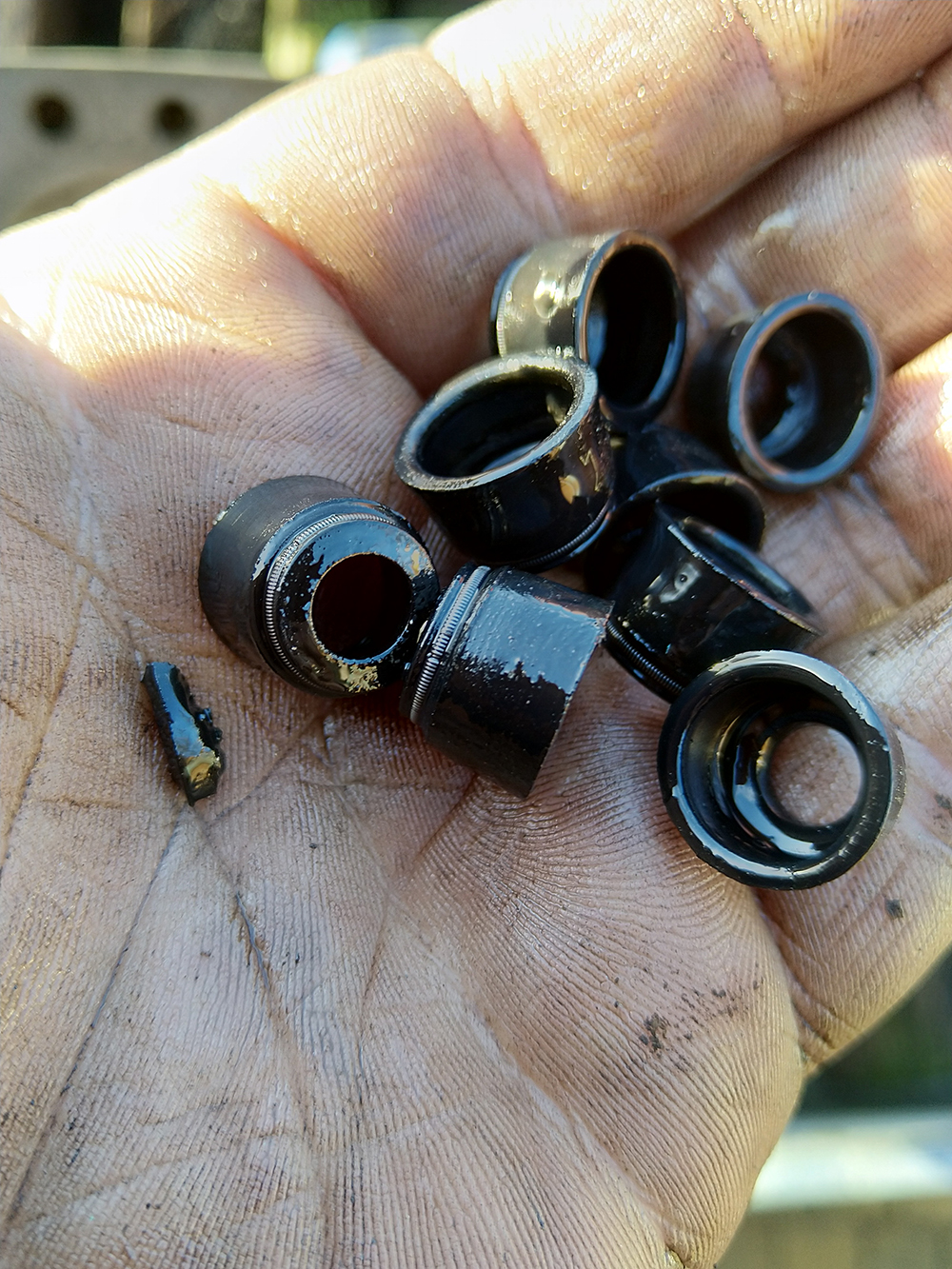

Oil caps so hard one brakes a ship of just from holding it between the fingers.
Check the valves for play in the guides, if the look OK, then mpi Viton seals on all 8.

I checked 2 by setting the about 7 mm open and then a micro meter again the top of the stem.move about 0.15 MM side to side.also seen that 3 of the valves have Worn stems. The rest i places in the Guides and could wigle most of them by hand. So new Guides. Some new valves and indeed those viton seals if i find Some.
