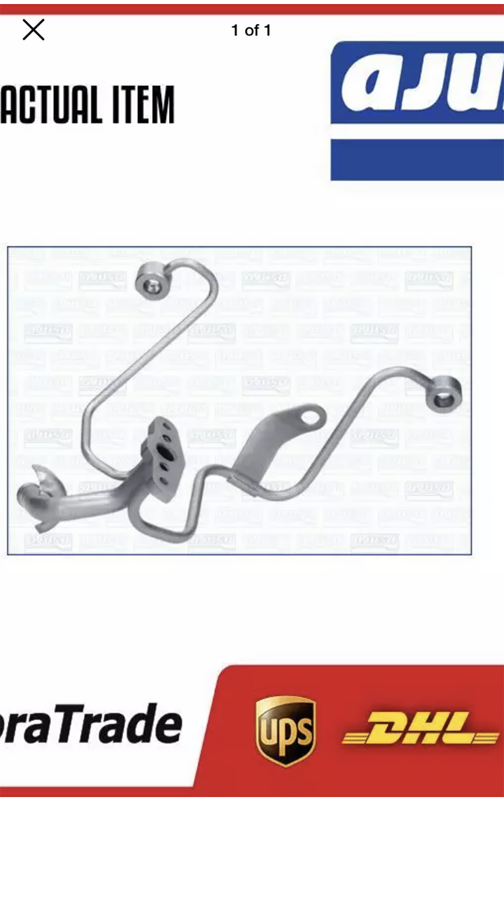

Don’t stress guys. I have found this photo. Kinda tells a story. I’m just going to copy it and plumb the small outer hoses for coolant.
not seen one like that before!
bake sure the turbo's orientated with the oil drain facing down (+/- about 30 degrees)
Edited by Joe C on 12th May, 2019.
evolotion
2909 Posts
Member #: 83
Glasgow, Scotland
that's too weird never seen a fitting like that before.
Denis O'Brien.
I reckon that is just a photo for illustration purposes rather than the actual item.
