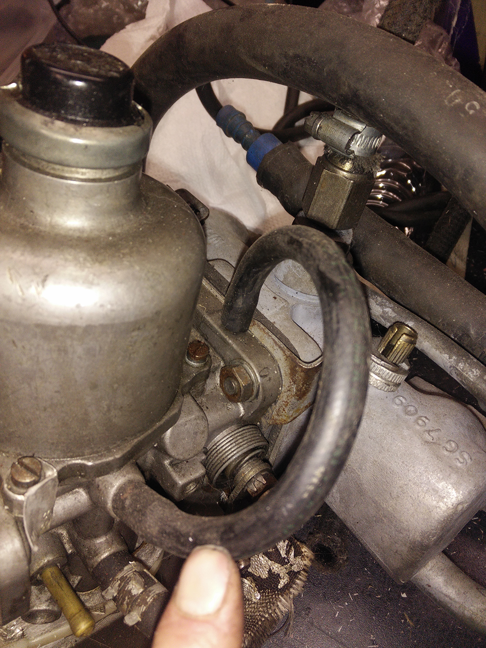

119 Posts Member #: 2576 Advanced Member South Staffordshire |
22nd May, 2019 at 07:06:32pm
Has your carb got this link pipe? HOSS |
113 Posts Member #: 11786 Advanced Member |
22nd May, 2019 at 07:10:48pm
Yes as sayed above i had the part throttle lean off connected but i blocked it. it made the fueling a bit more consistent in the other areas but didnt change anything on the problem |
