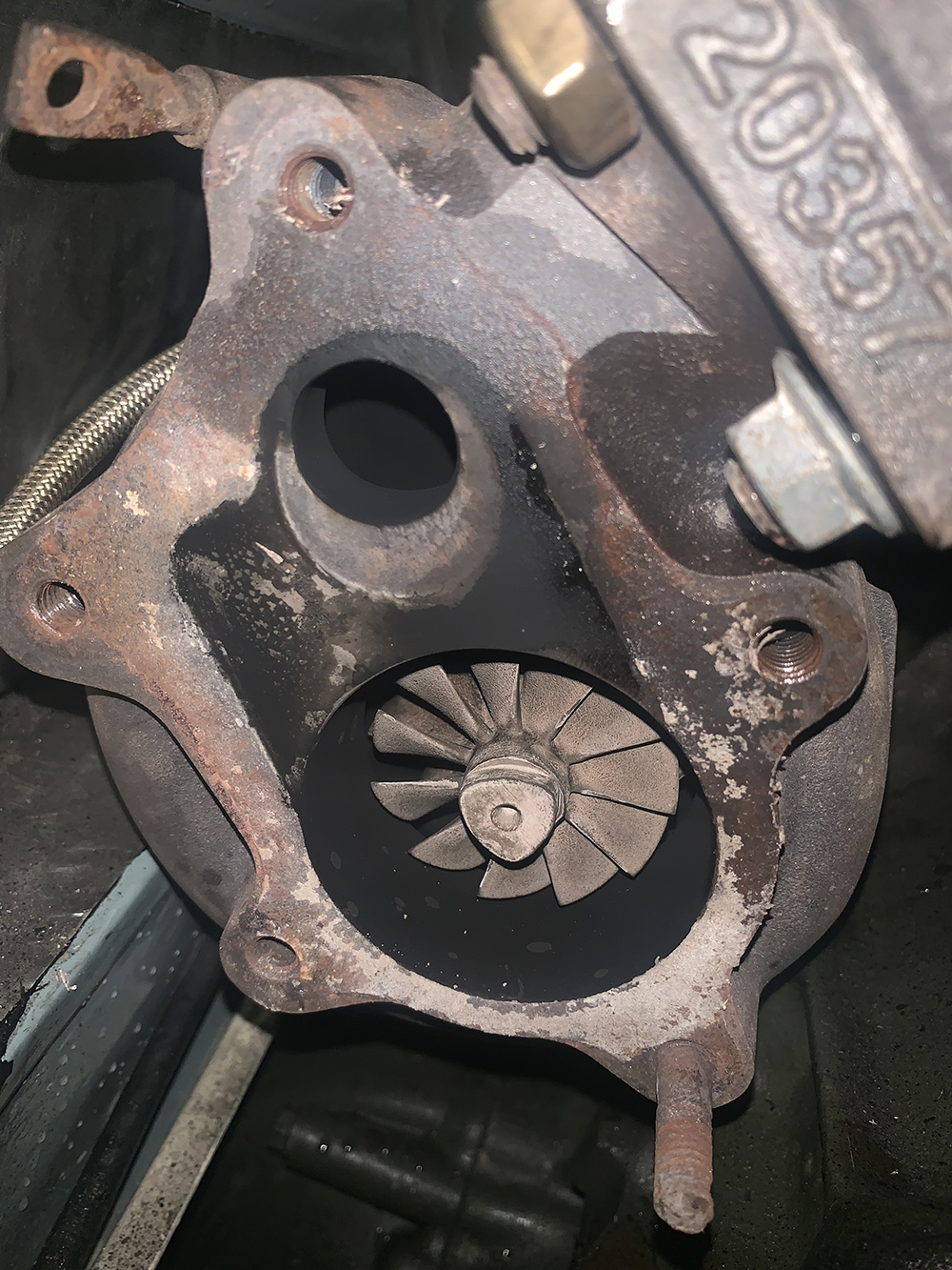

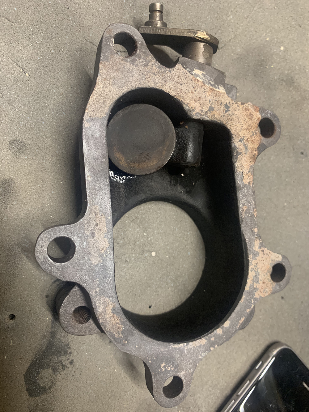

So took the car apart again tonight and think I have sussed out the problem! Seems like the actuator has far to much play in it preventing a full seal over the hole (see pictures) You can also see the sealer I used which I will remove. Is there a way to tighten up the actuator/flapper rod? Or do I need to source a new part? Seems like mostly up and down play not side to side.

What do you mean it has far too much play ?
It's a simple flap, and you were asked ages ago to ensure it was actually closed, and ideally with maybe half a hole pre-load on the actuator arm.
Which from the black marks....seems it was nowhere near closed, and doesnt even look as if it is aligned over the hole ?
Is something fucked with the arm/flap ?

I fully understand how the flap should work and reset the preload several times before stripping it apart. As I just said the shaft has to much play up and down as shown in the black marks. This is allowing it to leak at the top.
I am not going to scrap my turbo just because this part is not available. I plan on removing the weld from the top of the shaft then moving it up and re-welding to cure the up and down play. This will then make a full seal over the hole and solve the problem.

So finally managed to figure out the cause of this!!! Bought another turbo from phil and as soon as I took the wastegate housing off I started to see differences.
The turbo fitted to my car I had bought in a kit from eBay described as removed from a running mini. This was lies!!! The hot side of the turbo was completely the wrong size inside so the core was just sat in a void. Wastegate hole was lower down so poppet valve did not cover. So I have changed this along with the cover took it for a test drive tonight and bloody hell I have boost!!! 🤪
