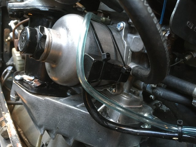

On 23rd Jun, 2020 remko said:
- Height of carb piston visible (12 LED’s) on dash next to wideband lambda! Now I know what part of needle needs grinding.

75 Posts
Member #: 1956
No rocketscience:
12 leds connected to 12 reed-contacts (or switch). Reed contacts in polyester block to fit to dashpot. Piston machined to hold a half 5mm whiteboard magnet.
Simple, but very usefull while tuning the AFR!
On 24th Jun, 2020 metroturbo said:
I'd be interested in seeing more about this has been done. Sounds like a nice little project.

On 24th Jun, 2020 remko said:
No rocketscience:
