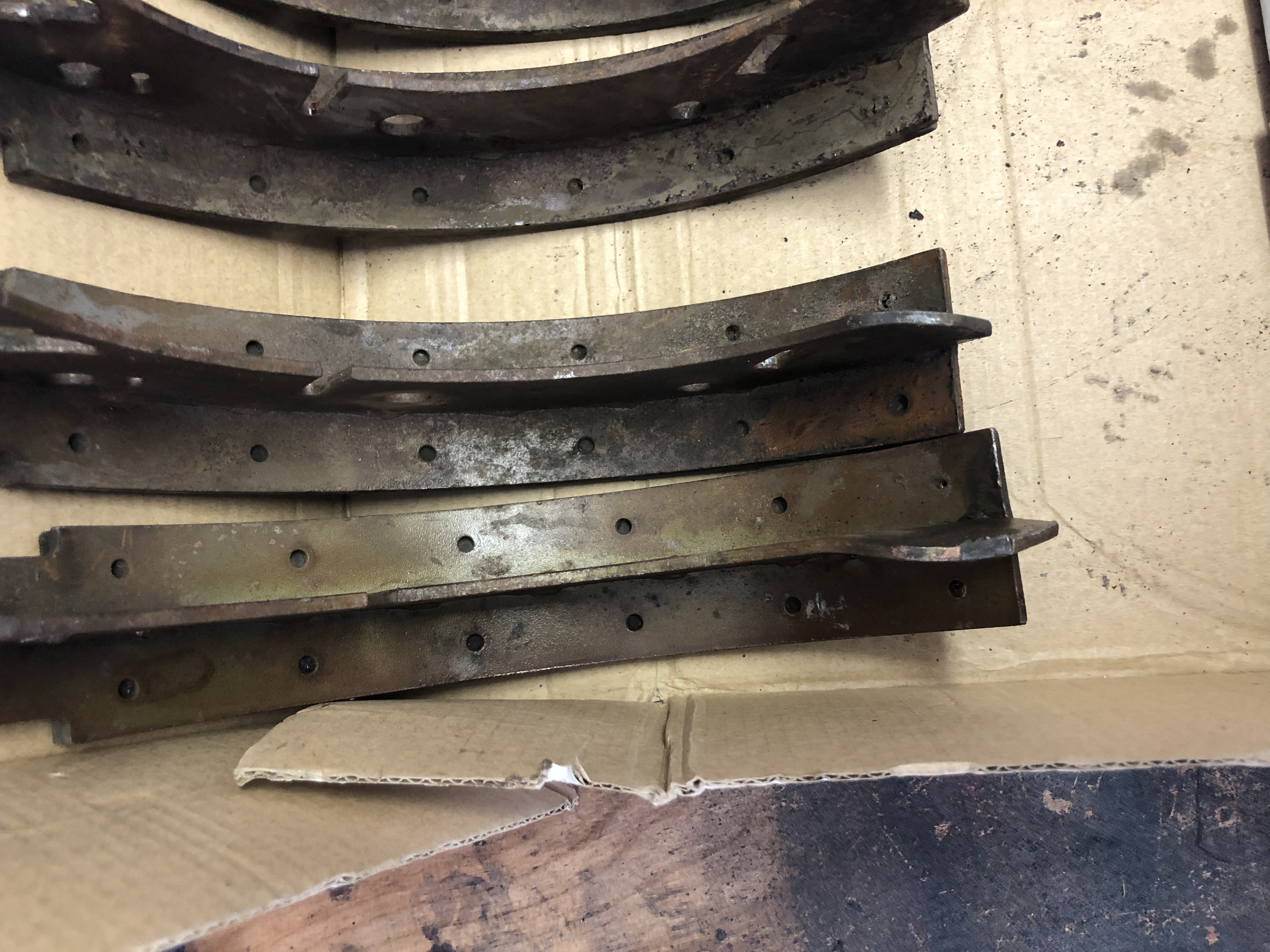

Maybe this is the issue. A bent rear shoe

Thanks all for the help and motivation, it’s fixed, is was the bent rear shoe.
6753 Posts
well done graham , that's an odd one .
Well done finding it. Must have been the shoe grabbing the drum early causing the car to pull from the rear brakes. A run on the MOT brake rollers would have helped narrow that down to a rear problem.
I agree Tom it’s strange that it passed an mot about 4 weeks before. I still don’t know what caused the bend. I will put it down the previous owners as the last mot in 2011 showed a failure on front and rear brakes. I also noticed that on of the shoes had picked what looked like rust. I wanted to run the car for a few miles and then change the braking material using the old stuff to clean up the surfaces.
I recon the design makes it sensitive a rear issue effecting the front. I’m still happy as now it has a week serviced braking system, that can’t be a bad thing.
