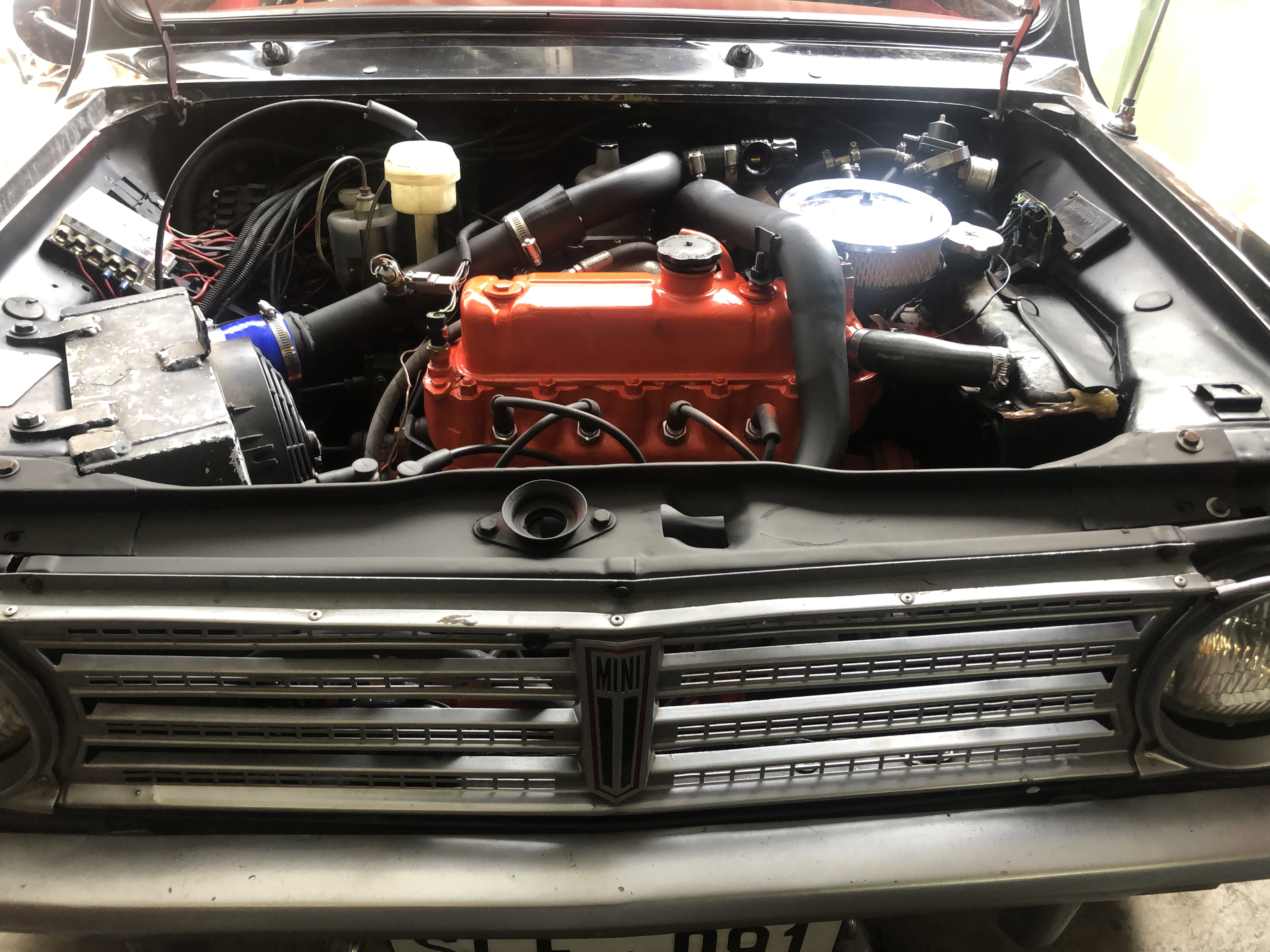

I have built a 998 with a gt17. I heard great stories about them being awesome turbos but I missed the part where they were ideally suited for 1275s.
Either way it’s done now. I have ordered a gt15 regardless.
My thing is should I just pull the engine and fit it or persist with the gt17?.
I haven’t tuned it properly yet. So it’s a bit blah.
It’s not a daily driver.
It’s a built and balanced bottom end
I have a good head with big valves
Compression is fairly low.
I’m running a re13t cam
I’m using megasquirt for ignition
Has anyone had a success story ?.
yeah, a 17 is pretty big for a 998, Will and ben Hamer ran one on their car to good effect, but that was a hill climb racer. I would definatly swap to the GT 15
For a daily drive the GT15 is the better choice.
I also use a GT17 on a 750 bike engine, but that doesn't make full boost till over 6500rpm.
Depends what you want, the 17 will make loads of power
