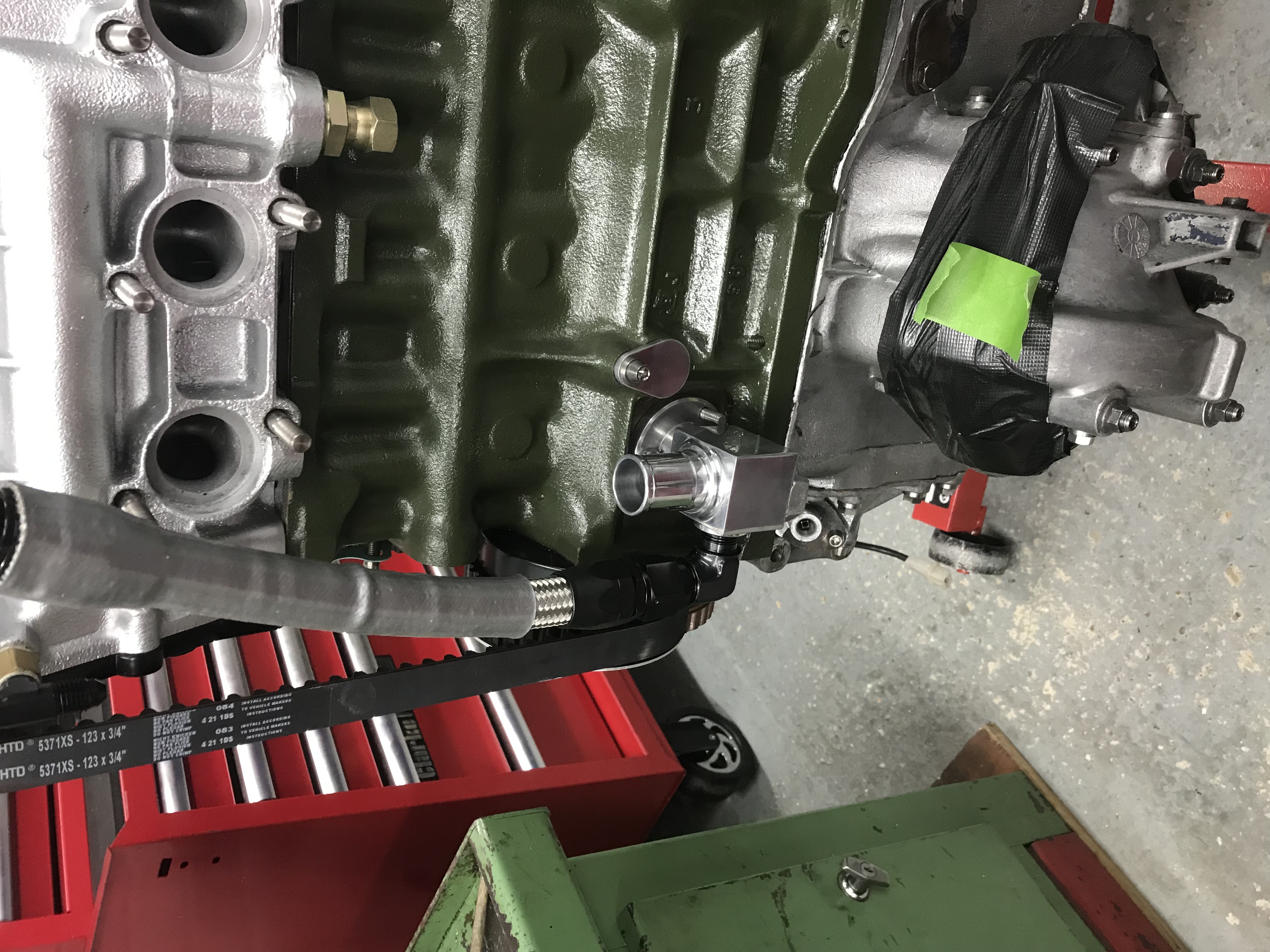

shane
2644 Posts
Member #: 1246
Lowestoft, Suffolk.
This is an option for oil drainage, granted this is on my K Build....
Shane
