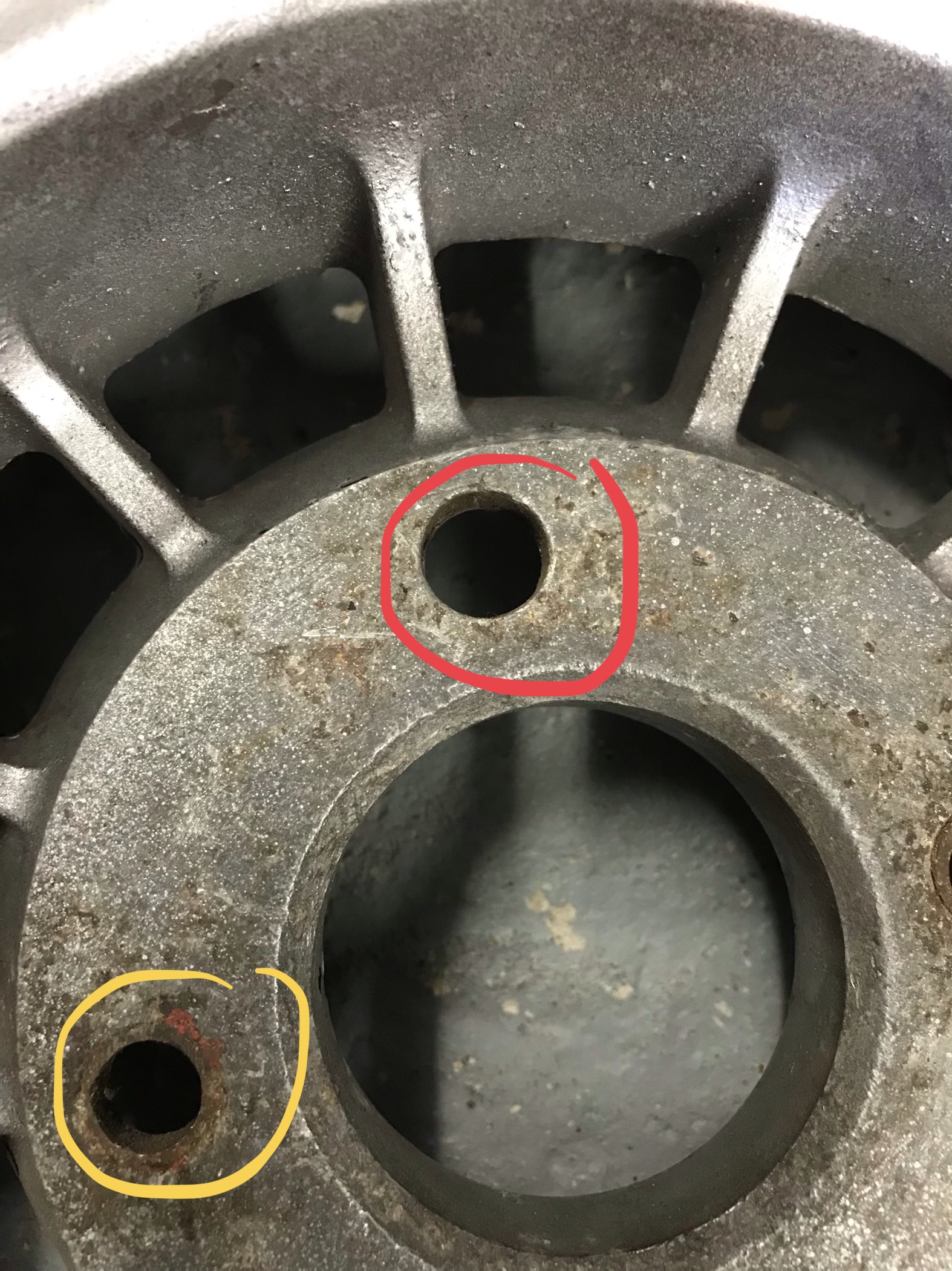

Evening all,
I’m messing with a set of Exacton’s as a side project.
Am I correct to think that they is supposed to be a steel insert pressed into the bolt/stud holes?
Circled red appears not to have one, yellow appears to.
If so could anyone furnish me with the ID?
Thanks in advance.
Shane

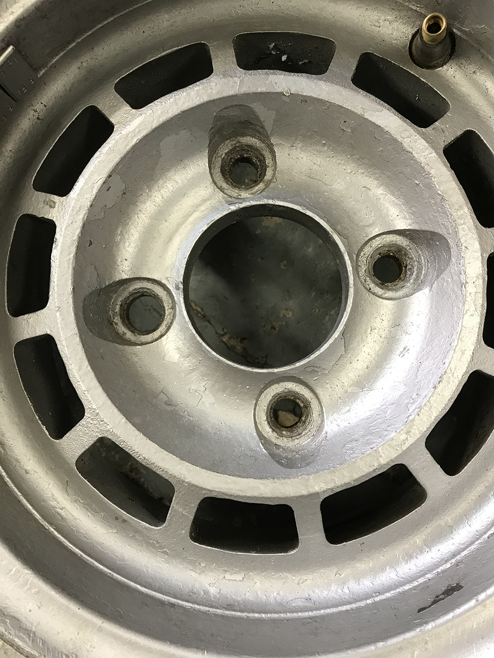

What does the other side look like

I ended up ordering a wheel nut for the wheel which fitted the hole minus the suspected sleeve.
I suspect the other three holes have grown with corrosion and retained whatever sleeve was on the wheel nuts previously used, would like confirmation for peace of mind tho.

6966 Posts
these never had steel inserts fitted,
they used one off type a sleeve nut from rover, now available form minispares centre

Thanks for that Carl, just wanted to be happy the wheels are good before they come your way.

6966 Posts
I always tell folk to look at the rear, if the holes are round then all is ok,
if not , problem
