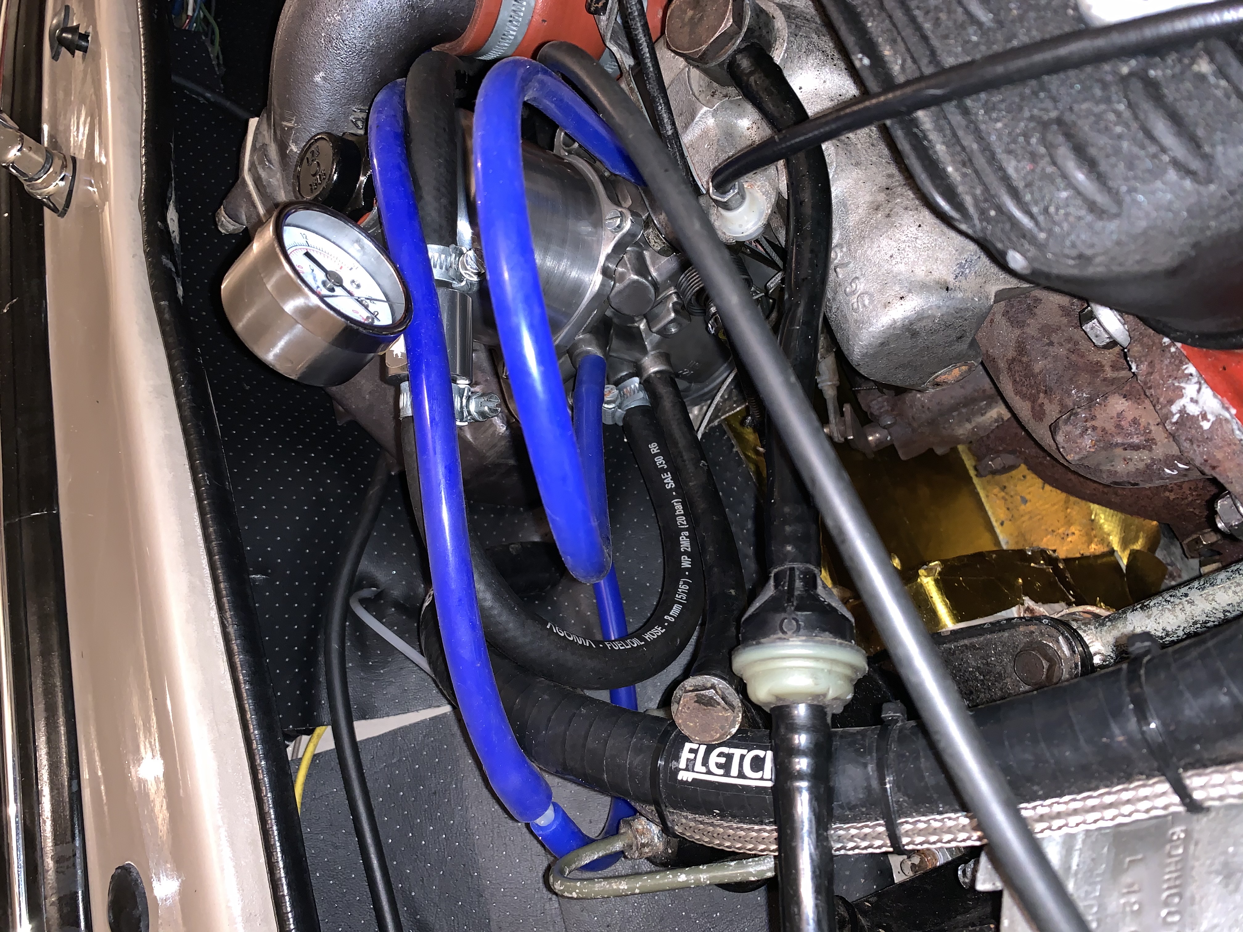

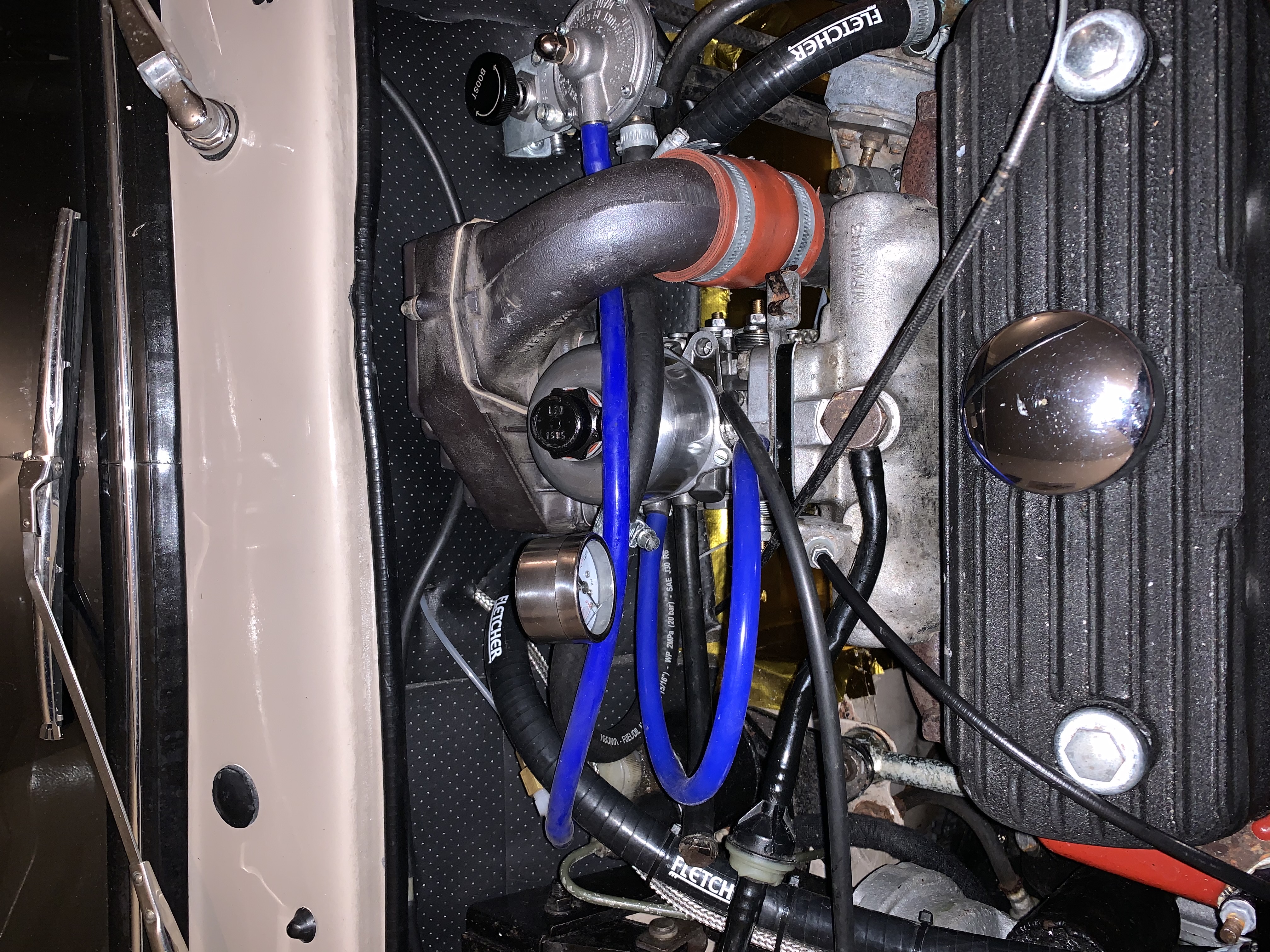

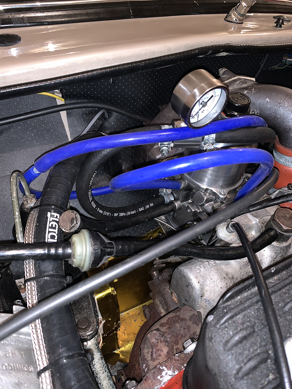

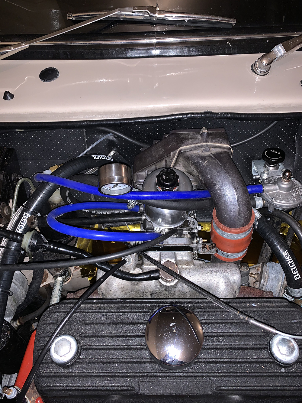

here's a few photos of my carb setup. At the moment I've got the part throttle lean off connected and have tried as well with them blocked off at both ends and still have the same problem. The fuel pressure reg that is on there is a brand new one from mini spares. Its hard to see in the photo but I have the feed line from the tank going in to the right, return at the bottom, top left is going to the plenum pressure signal and the lower left connection is to the carb. I thought that replacing the fpr would solve my problem, but it does exactly the same thing with this brand new one! Starting to think there is an air leak somewhere but im not sure how I could narrow that down. I also do have the correct turbo gasket between the plenum and the carb as I know its a common issue to put an NA one in there by accident.

what needle is in the carb , its hard to see is that blue pipe from the top of the fpr going into the corner stub on the plenum ? what do the plugs look like .
