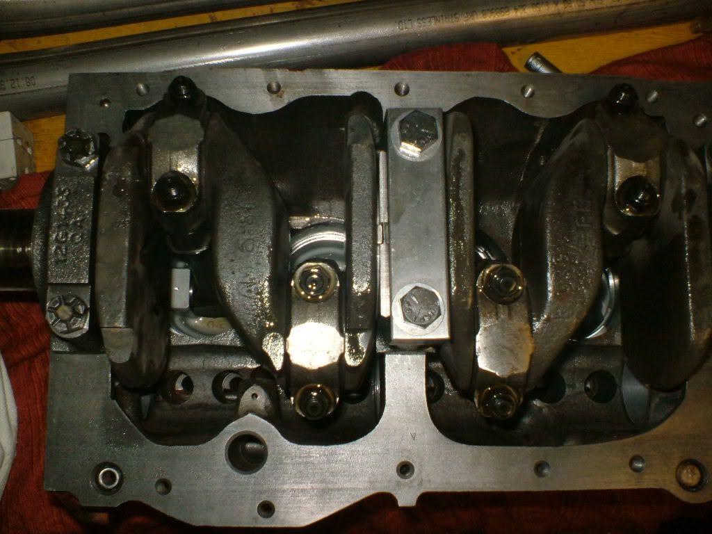

Got my block etc back from morspeed yesterday and started assembling a few bits today...
Everything is falling together nicely.. top marks on the machining Simon..
mmmm nice shiny omegas........

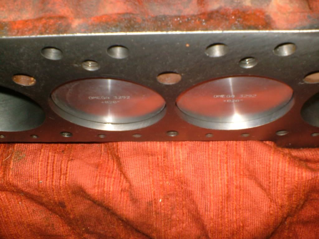

What pistons are they with no dish?

Forged omega 3292's, with 18mm gudgeon pins,
they sit down the bore a bit.
Had the block decked to give me 8-1 on a standard head *happy*

By as much as the picture shows?

I think thats the pistons at TDC. ? a very odd way to gain combustion volume but we'll have to wait and see from the results i guess.

Yes your correct Karl, they are at tdc.
I know someone else running a similar setup and making excellent bananas...
Say hello to bad combustion!!!!
I'll be interested to see the results of this, to see if the theory really holds true or not. Just make damn sure it doesn't det or you'll end up with no head gasket in no time.
squish??
