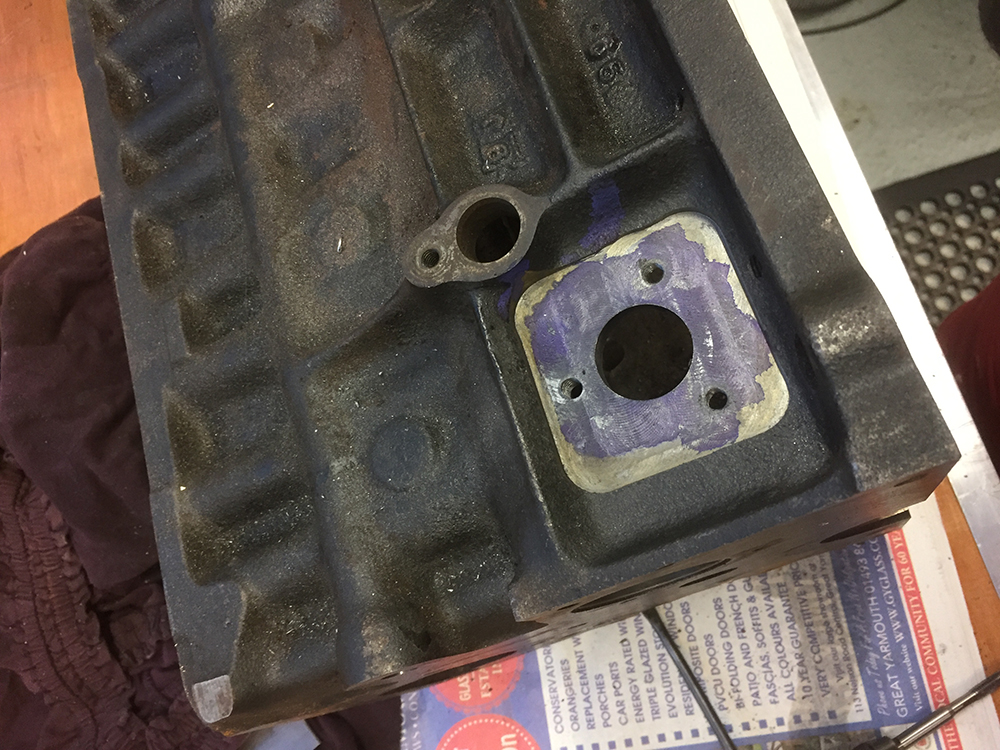

I'm using one with my K build. I did machine the block in the area where the oil pump is on the A/A+ block.

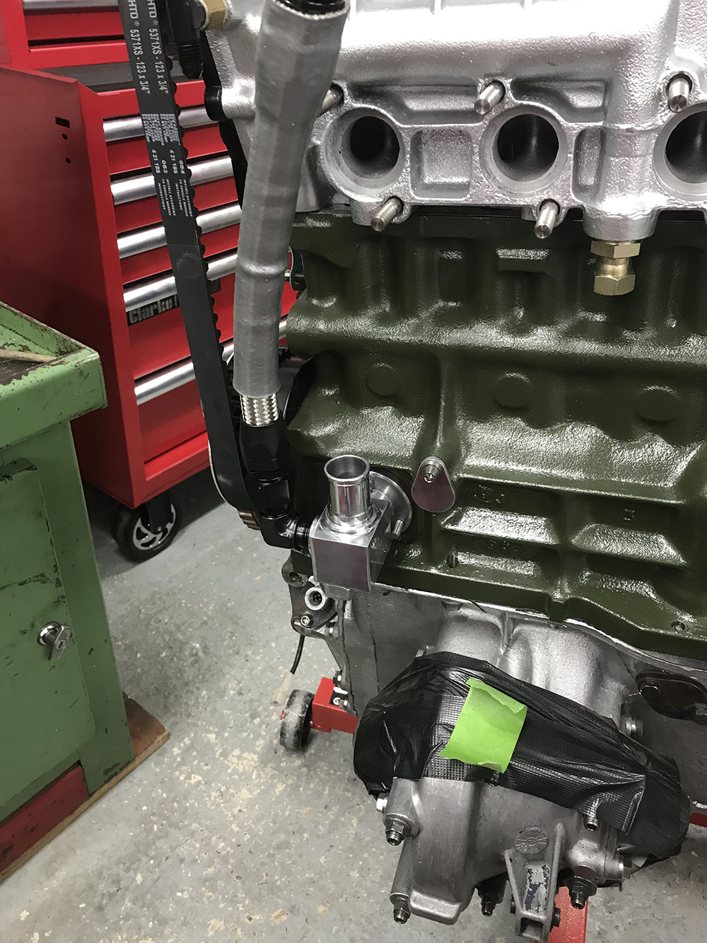

Then machined up a drain block for the head and turbo oil drains to return.

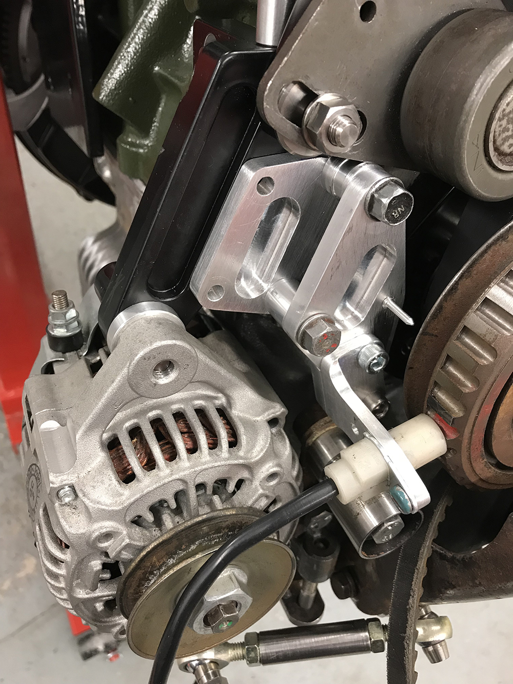

I then made a bracket to mount the alternator low down to free up space at the top of the engine bay.
The Nippon Denso units fit very well above the fins of the gearbox casing.
Some fudging around had to be done for the belt drive and tensioner tho.

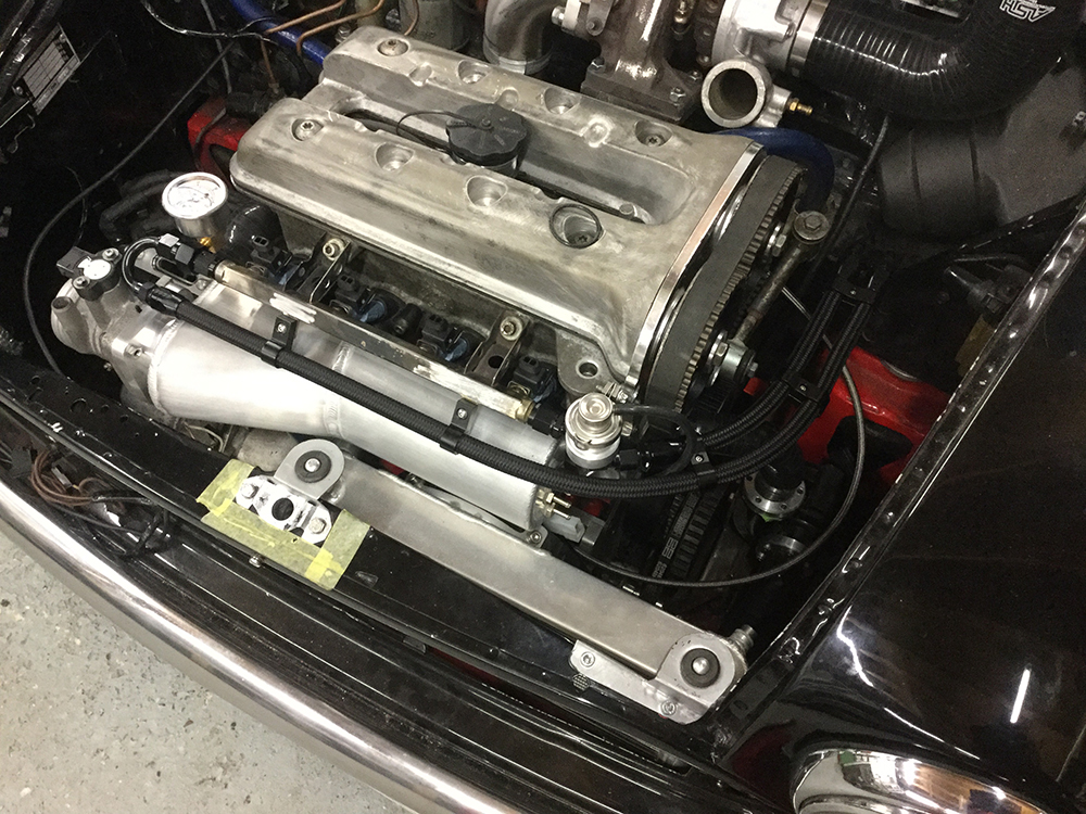

Nope, I seem to remember a thread on here a few years back where someone tried one and said it was marginal on cooling capacity. with that in mind I had a radiator made by Concept racing which was loosely based on the dimensions and orientation of the MPI Rad.
I haven’t got a decent image of it out of the car, but if you have a close look you can just about figure it out.

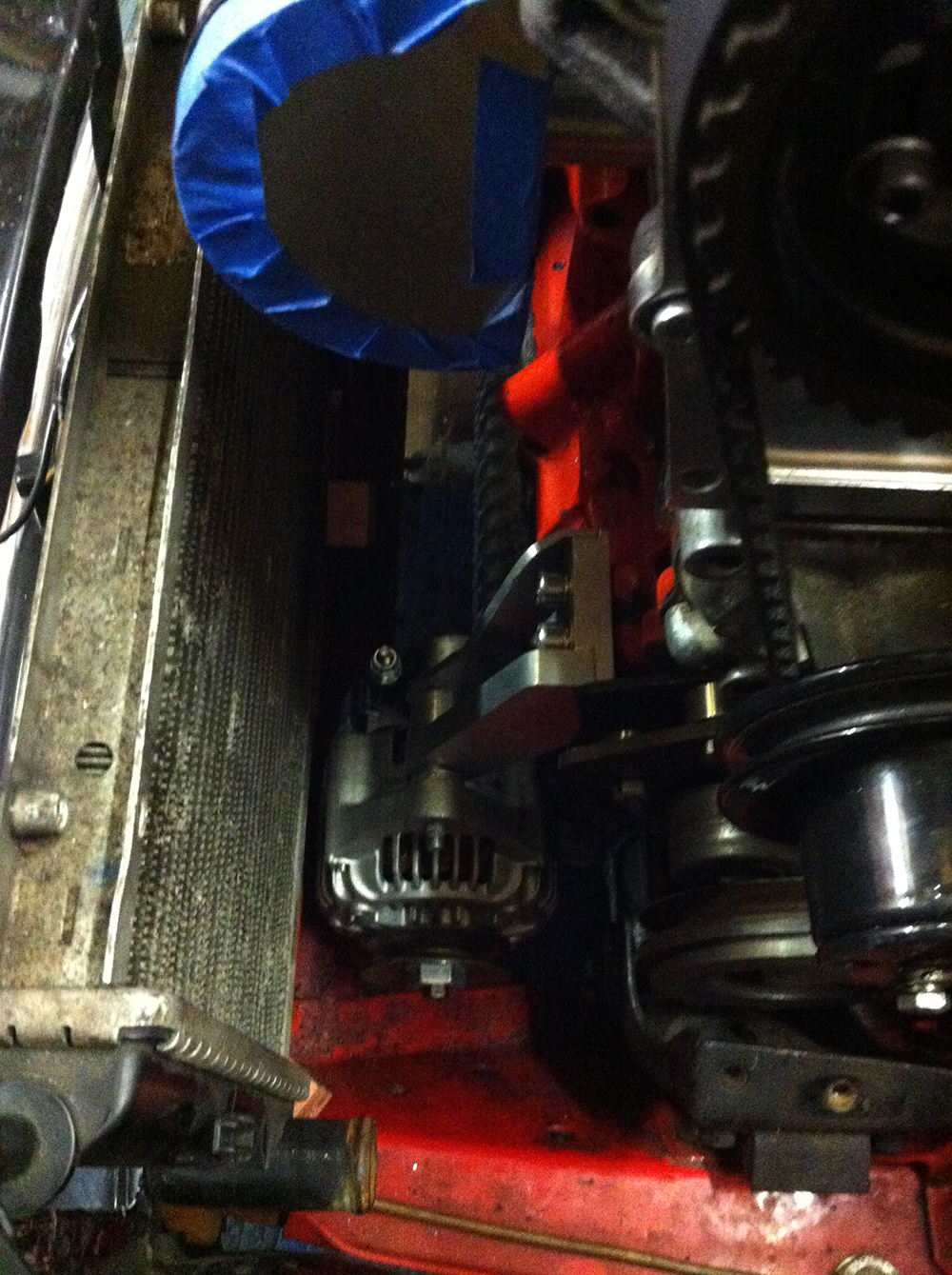

Not a problem. I was fudging though the file of build photos earlier for my first 8v build from 2012 and found a pic of the first mock up of the alternator in the low slung position using the MPI rad (hopefully below).
Also when time permits for me to look for it I should still have the drawing I did for Concept for the rad.
If you need any further pictures of mounts and bracketry PM your Email and I’ll send some over.
