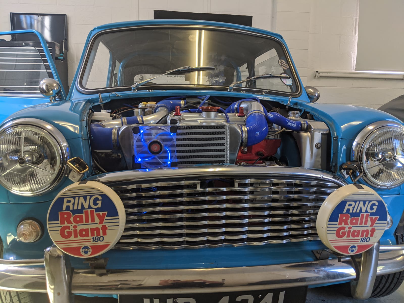

He’s Hilda ,1973 mini turbo (1293) rebuilt by my bro and me , engine done by a great friend who knows a lot about turbos and superchargers . So cheers Sam

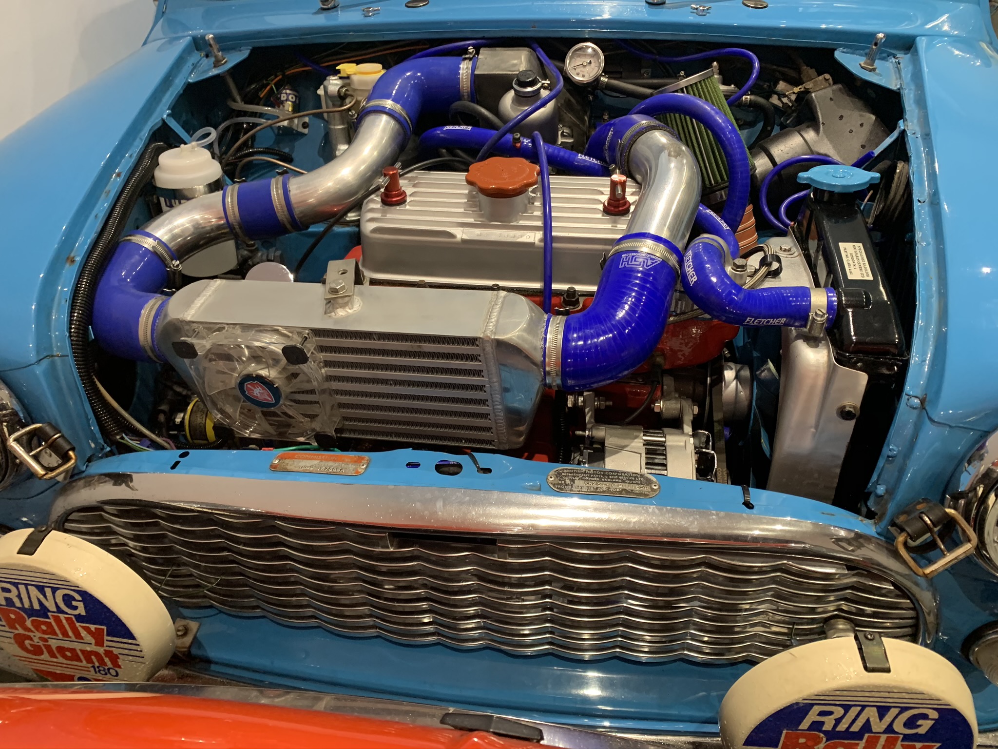

Spec is 1973
1293 metro turbo engine , completely overhauled with new Viton stem seals ,
Sodium filled exhaust valves Help,with heat,
New Garrett t3 turbo
New reconditioned carburettor
Bailey dump valve along with complete silicon hoses etc
Aftermarket Renault 5 turbo inter cooler fitted with fan if needed
Getting,round to putting holes,in bonnet for air flow .
Cool hose running from front grill to turbo air intake .
But again these forums are great to get info and help.
