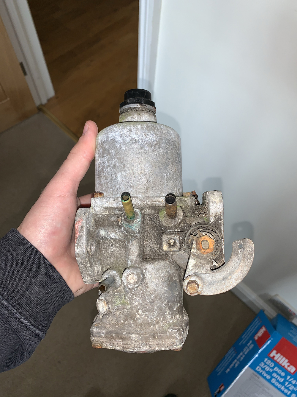

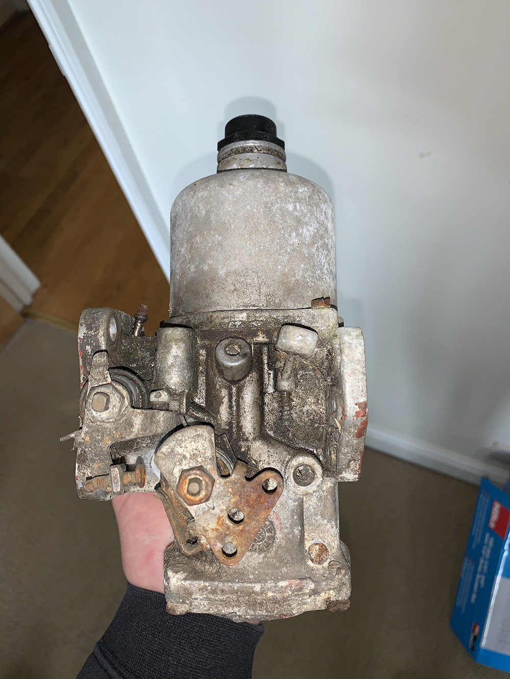

I purchased my first mini a couple of months ago, it seems that the owner before the last has put in lots of MG parts and im pretty sure it has a metro 1275 in it. I'm just wondering if someone can help to identify the carburetor which i have taken of it? I read through a previous thread which compared the two and it seems it is an N/A carb but the dashpot resembles that of a turbo carb? Any help is greatly appreciated.

NA HIF44 with a turbo dashpot on it.

Is there any advantage to a turbo dashpot?
4642 Posts
No, only than you can fit the plunger retaining clip that nobody uses anyway.

I've got the opposite turbo bottom with NA dash pot

I have used a few combinations, i had a turbo carb get crushed on the bulkhead and converted an na lower half for turbo use
iirc matt (Miniwilliams) launched a plunger once

Bit of an oddball as the throttle cam and choke cam have been put on opposite sides, as they are on a turbo carb.
