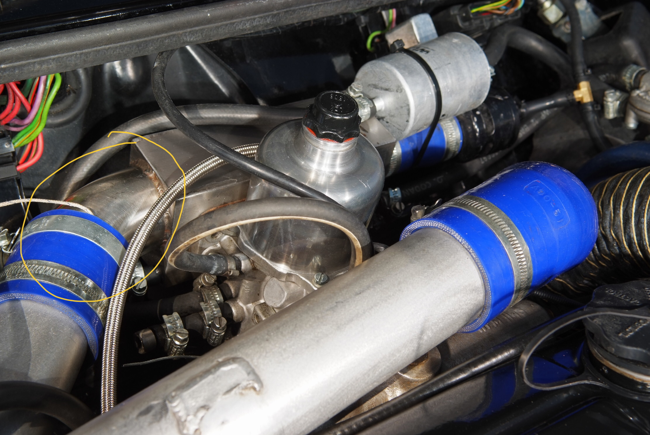

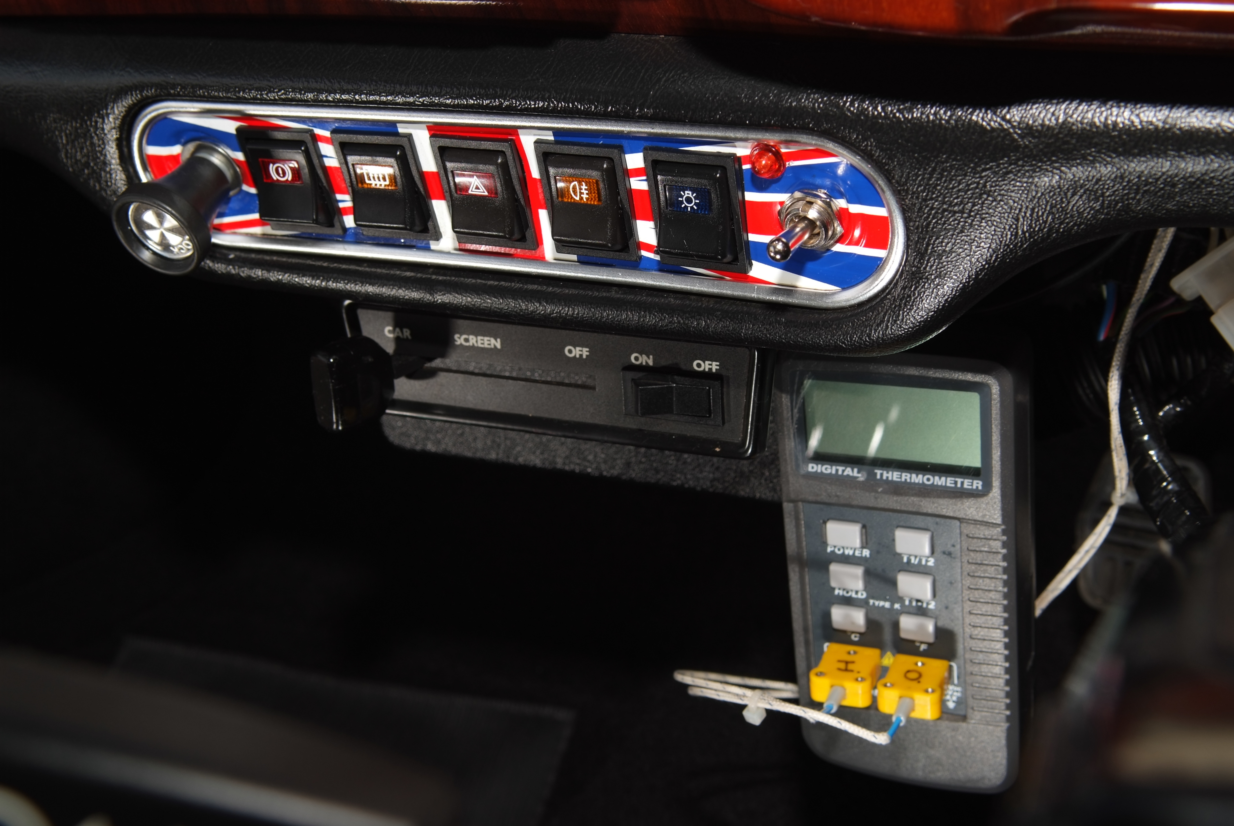

I used to use the same intercooler, I had two K type thermocouples on the inlet and outlet to monitor charge temps and was surprised how efficient it actually was.

That’s interesting Shane... how did you connect them to the inlet & outlet? Is it a probe that sits in the airflow or is it possible to get a clamp type? Surely a probe would mean drilling and then making air tight somehow...

Thermocoples; https://www.ebay.co.uk/itm/1M-K-Type-Multim...3IAAOSwJppdFfL9
Thermometer; https://www.ebay.co.uk/itm/Dual-Channel-K-T...fYAAOSws~Bd-D7v
The thermocouples are small enough to slide under the hose joiners on the inlet/outlets.
Most of the K type thermometers have min/max and Delta T functions, cheap but informative. Also good to use to establish a datum before you make any changes then ascertain the gains made.
Also a smaller intercooler installed with good air flow and a path for the heat to be rejected is potentially better than a massive one installed poorly/no air flow.

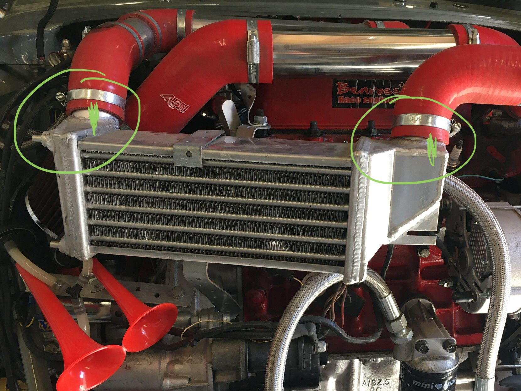

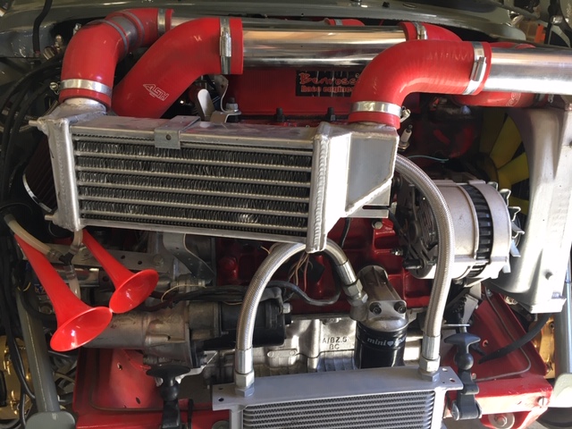

How have you got your cooler mounted?
Shane

like this...

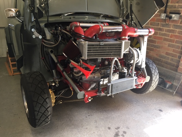

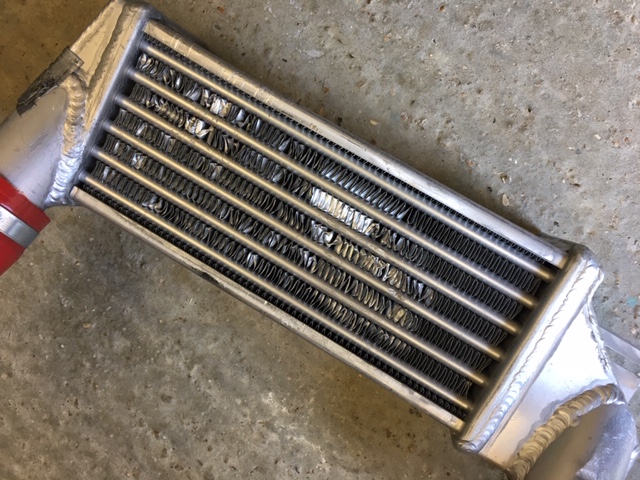

But I need to bring it forward a bit as one of the pipes to the oil cooler is doing this to the back of the intercooler....

pressure drop across the core is as important as cooling ability.
Doesnt matter if it cools superbly..if it cannot flow any air.

Have you thought about adding some cowling around it to channel the air through?

The more air you can get across / through the more heat exchange can be achieved, by adding a cowl or ducting you don't allow the air to "bypass" the core, remember the air flow will take the easiest path.
