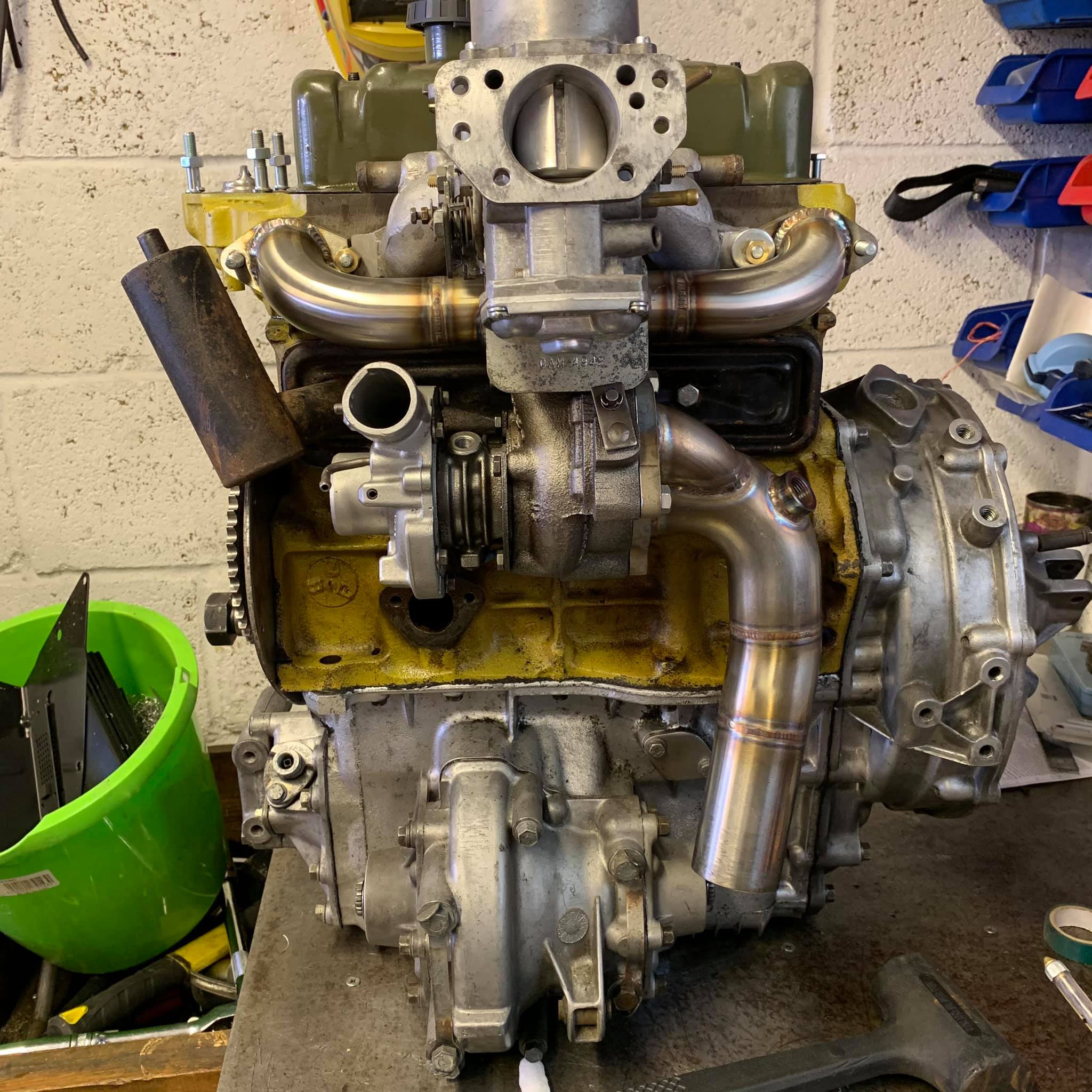

Awesome car, was good to chat to you at combe. really interested to see any more pictures of the turbo to intercooler pipe routing, you said the outlet is clocked down, so you have a U shape pipe? I'm trying to work out what the differences are between your turbo and mine.
Love that oil drain, great little piece of machining.
wilsonc001
46 Posts
Member #: 11333
To answer that with an image, I found an old picture of it mounted outside the car...
