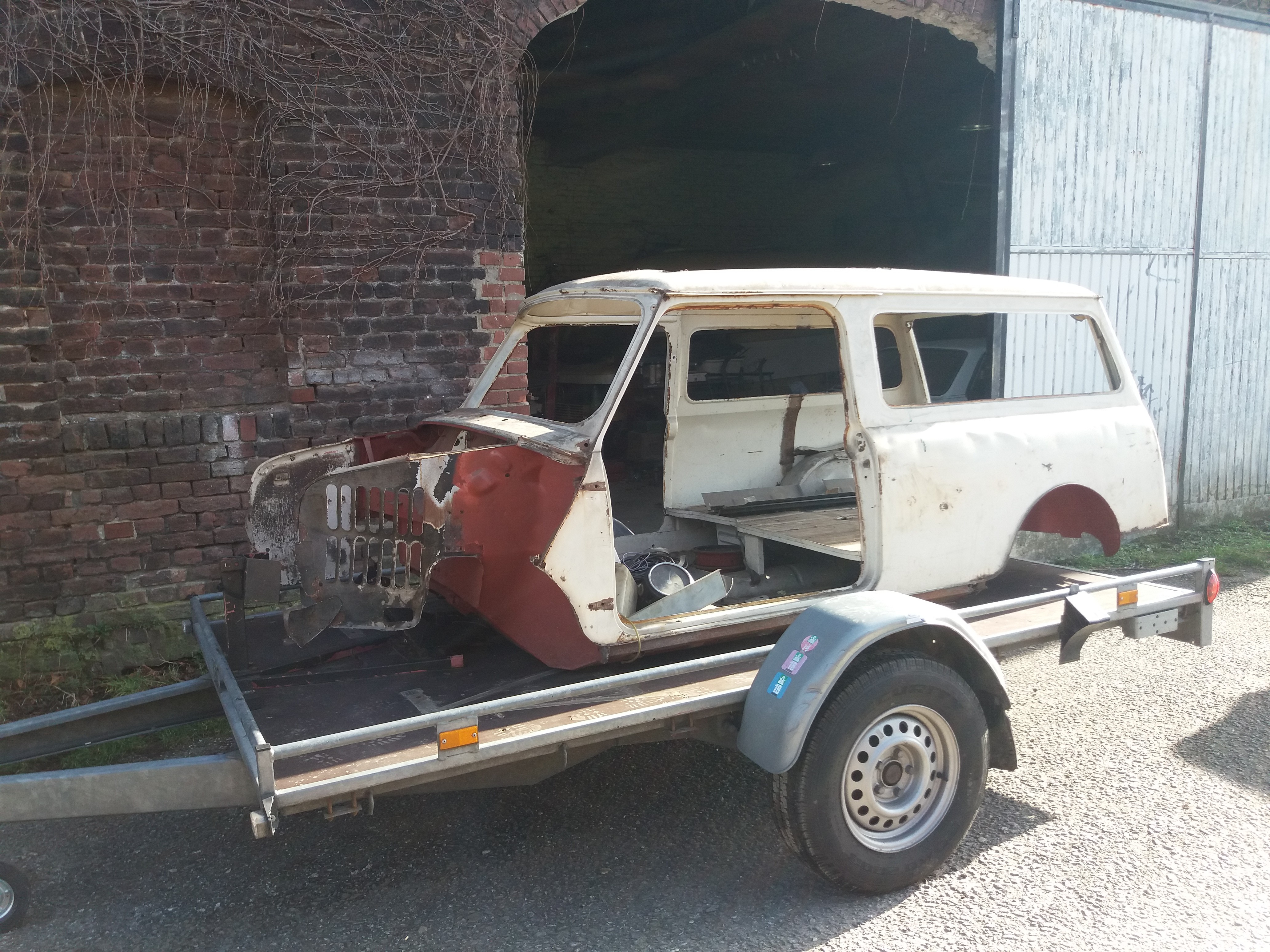

I Bought a 1978th Van stripped down by the former owner and (hopefully all) parts for restoration.
This will start in spring next year.

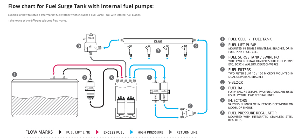

I've done this recently as I have a clubman estate. Same fuel tank. I went with a swirl pot and lift pump and high pressure pump. The only reason I did this was because I couldn't find a definitive answer on if I needed one or not. Some say you do, some say you don't etc. So i went with after the advice of Gavin Wilkinson on the facebook group.
I've mounted the lift pump on a plate that attaches to the rear subframe using the rubber bobbins. Then the swirl pot is in the boot mounted to the plate that is pop rivetted in around the wheel arches. Then I have a HP pump on the rear subframe.

I did the same. Hp-pump under the car mounted on the subframe and that was enough to do the job. Make a return hose on the tank.

I did some research and found two configuration plans using a swirl pot.
One with internal hp pump and one with external hp pump.
I think that I will go for the version with external hp pump.
Is there any advise about the lift pump? What pumps are you using?
For the hp pump I think I can use the Metro turbo pump.
Another question, what pressure regulator are you using? Is that the Malapassi with 3 or 4 tube connectors?

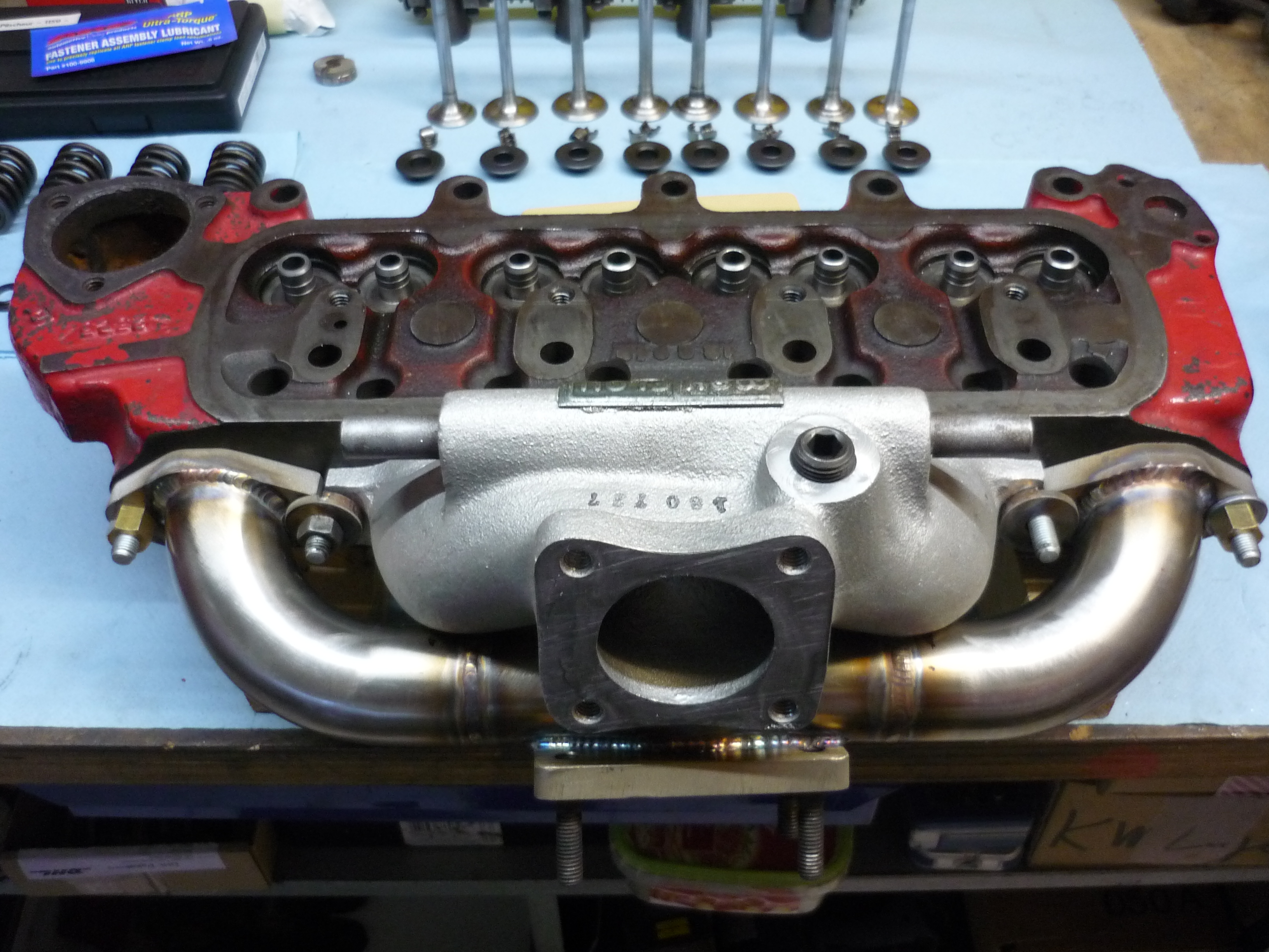

Yesterday got my head back from the machining shop.
New valve seats and guides.
Ralf
If your machine shop really returned your cylinder head in the condition shown in the photos I would have to question their competence.
OK, the photo may make it look it's worse than it is but the photos show pitting everywhere and especially between 1-2 and 3-4.
In the photo it looks like pitting, if it's just dirt, they should have washed it of before doing the seats and guides.
And if it is pitting, they should have recommended a light skim.

Good luck with the build Ralf. That head definitely needs a little more love.

yes sure, but no problem. I will do the cleaning.
Work done so far is valve seat and guide. And that looks good to me.

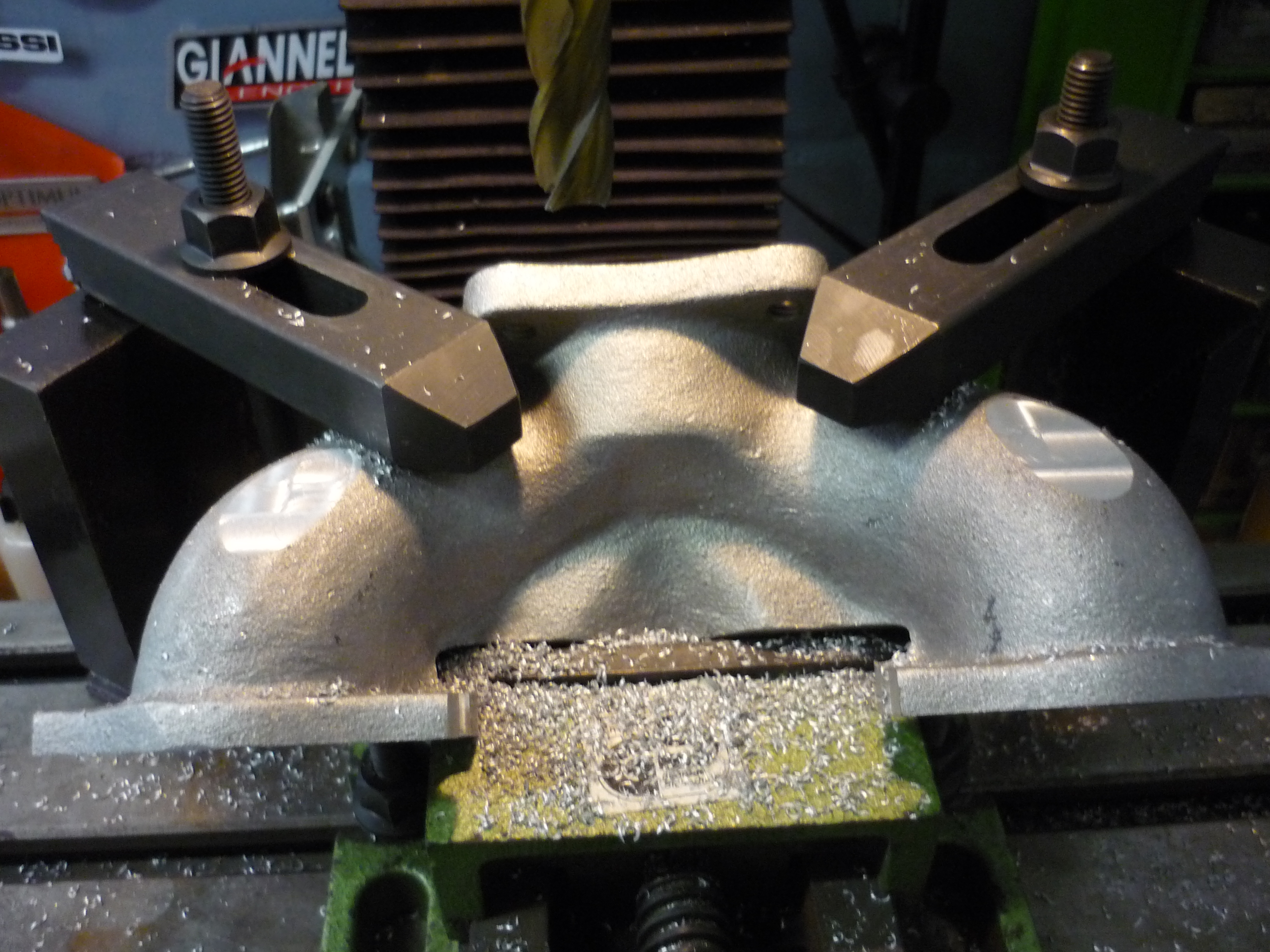

Got the inlet from Maniflow today and it didn't fit with the FusionFabs exhaust manifold.
There was a collision in two areas.
So 2,5mm material milled down in the two areas and everything fit together now.

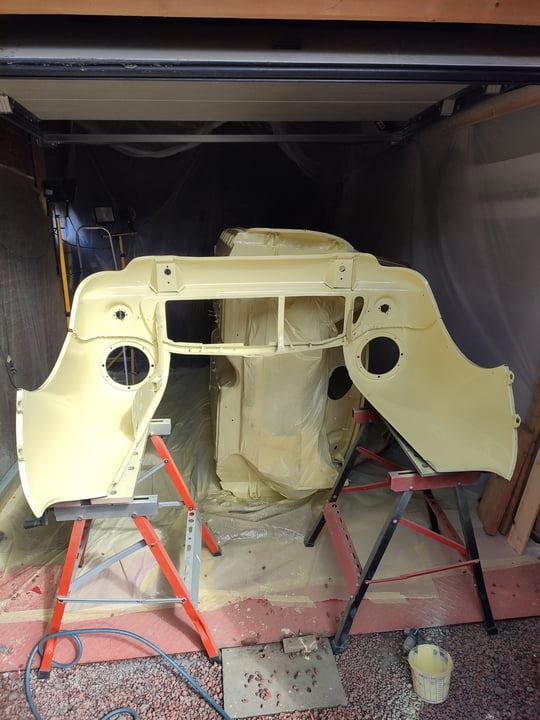

Many things were blocking progress over here, but now I'm back working on my Van.
Like to share some progress pics
Edited by Ralf on 28th May, 2025.
steve1275
864 Posts
Member #: 951
Bromsgrove
looking good! *Clapping*
