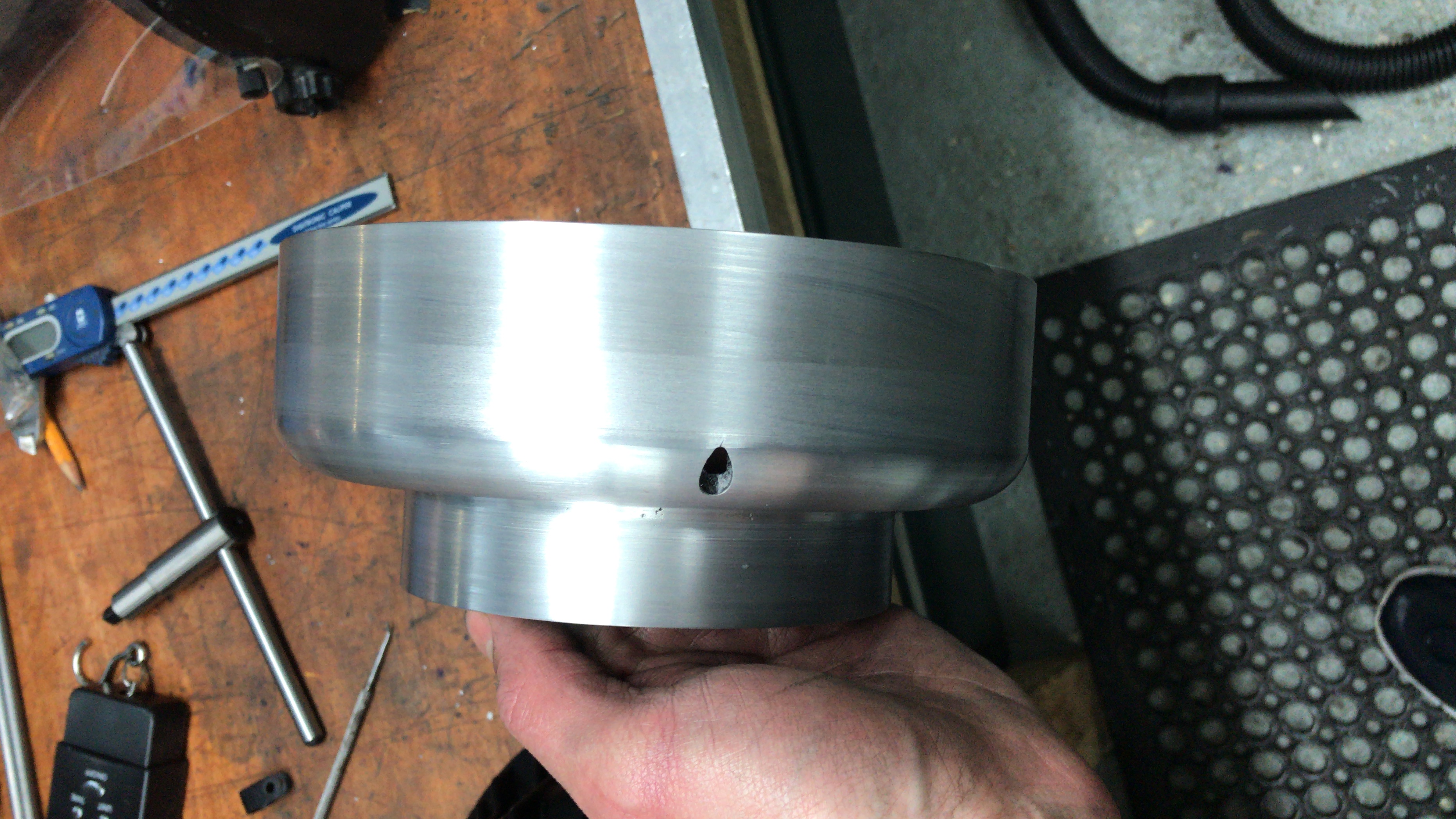

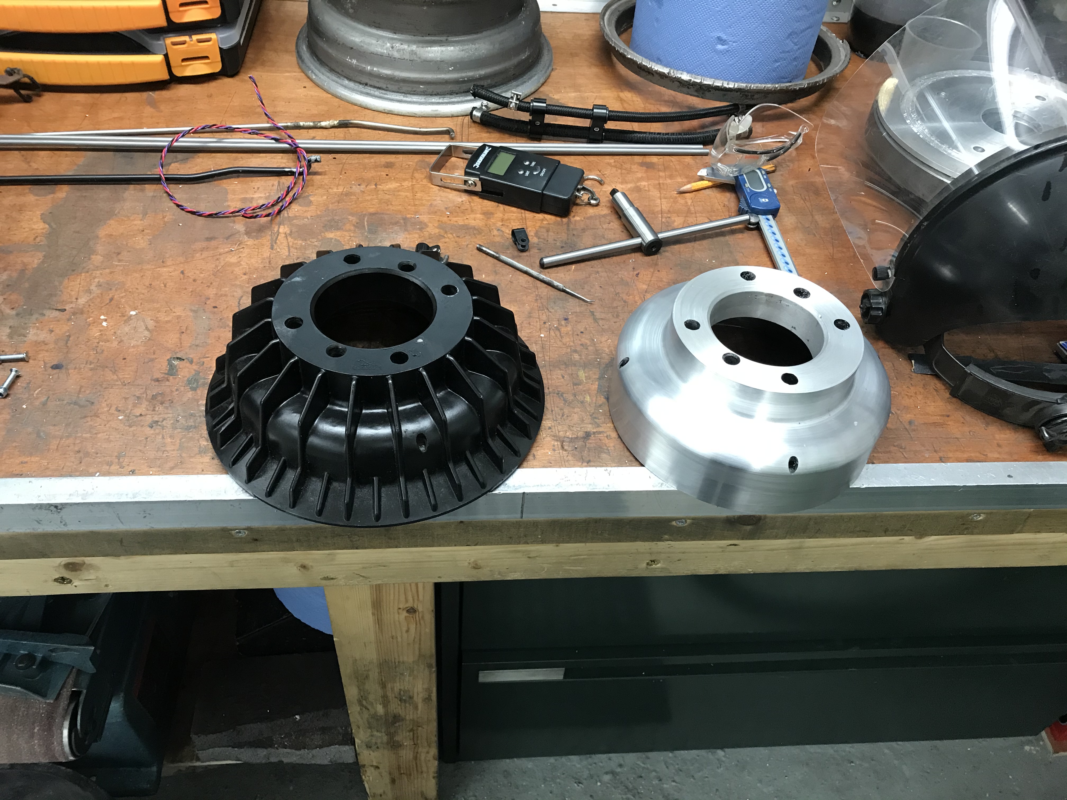

The normal Minifins can be turned down to save weight.
I ended up turning his down on the lathe, there were 1.9Kg before, with the fins off and a tidy up they weighed 1.240 Kg each.
I was sure I could get them sub 1Kg with taking another cut and adding some speed holes and slots on the mill but he was reluctant to let me go much further.
