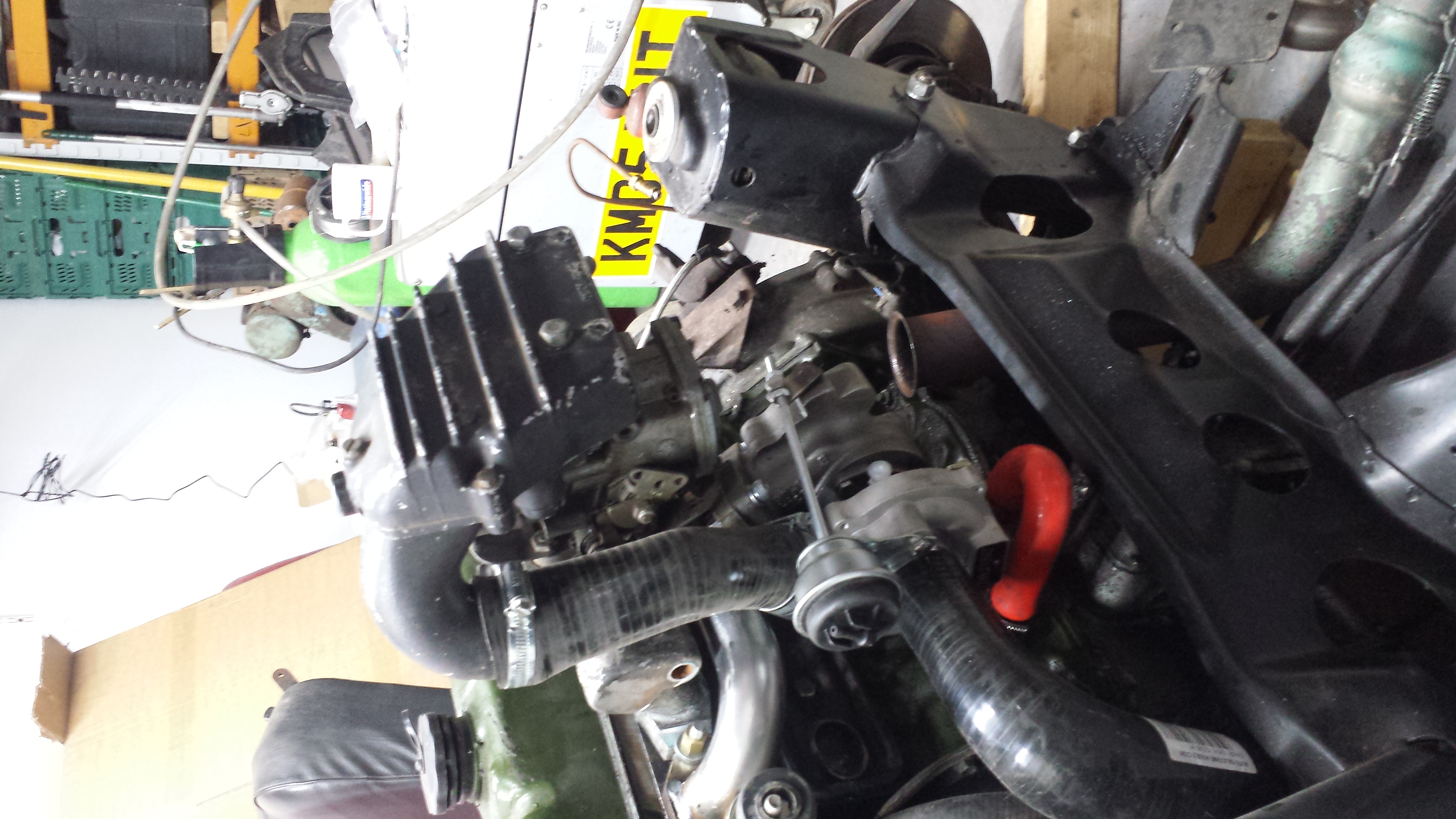

So the forum seems quite quiet these days, thought I would make a thread for the engine build I'm working on.
I've been collecting parts for a while now, just slowly spreading out the cost so the boss doesn't get mad *hehe!*
Spec:
998 +20 dished pistons kindly donated by mr Paul Jeffries
GT15 from a tdi polo
Evo001 cam
Standard 12g940 head
Meastro plenum and HIF44E (that needs converting)
RS turbo intercooler
Megajolt ignition
x pin diff with 3.1:1
RTS clutch
High pressure pump and malpassi regulator
AEM AFR gauge
My goal is 100hp as a nice round number, should be achievable with the above.
The manifold I am yet to build but I'm planning on cutting up an LCB or two to make a short down the back manifold, I'm not sure how long this will last so have been looking at thicker gauge mild steel pipe but unsure what ID pipe would be best suited.
If anyone has any thought, advice, or thinks I've forgotten anything, comment below.
Once I get into it properly all will be on youtube: Mini Matt TV

Update.
It's been a while and I've been talking about it for long enough so the other week on my way up to Bingley Hall I dropped off the engine and gearbox off to mr Paul Jeffries aka JPE.
Paul will be rebuilding the gearbox with a Tran-X 6 pc straight cut gearset and helical drops so I can retain some sanity with 4th gear being 'quiet'.
The block is going off to be overbored +20 and have pockets for the 12g940 head and then I will be finishing it off.
Pretty exciting and loads to do in the mean time.
