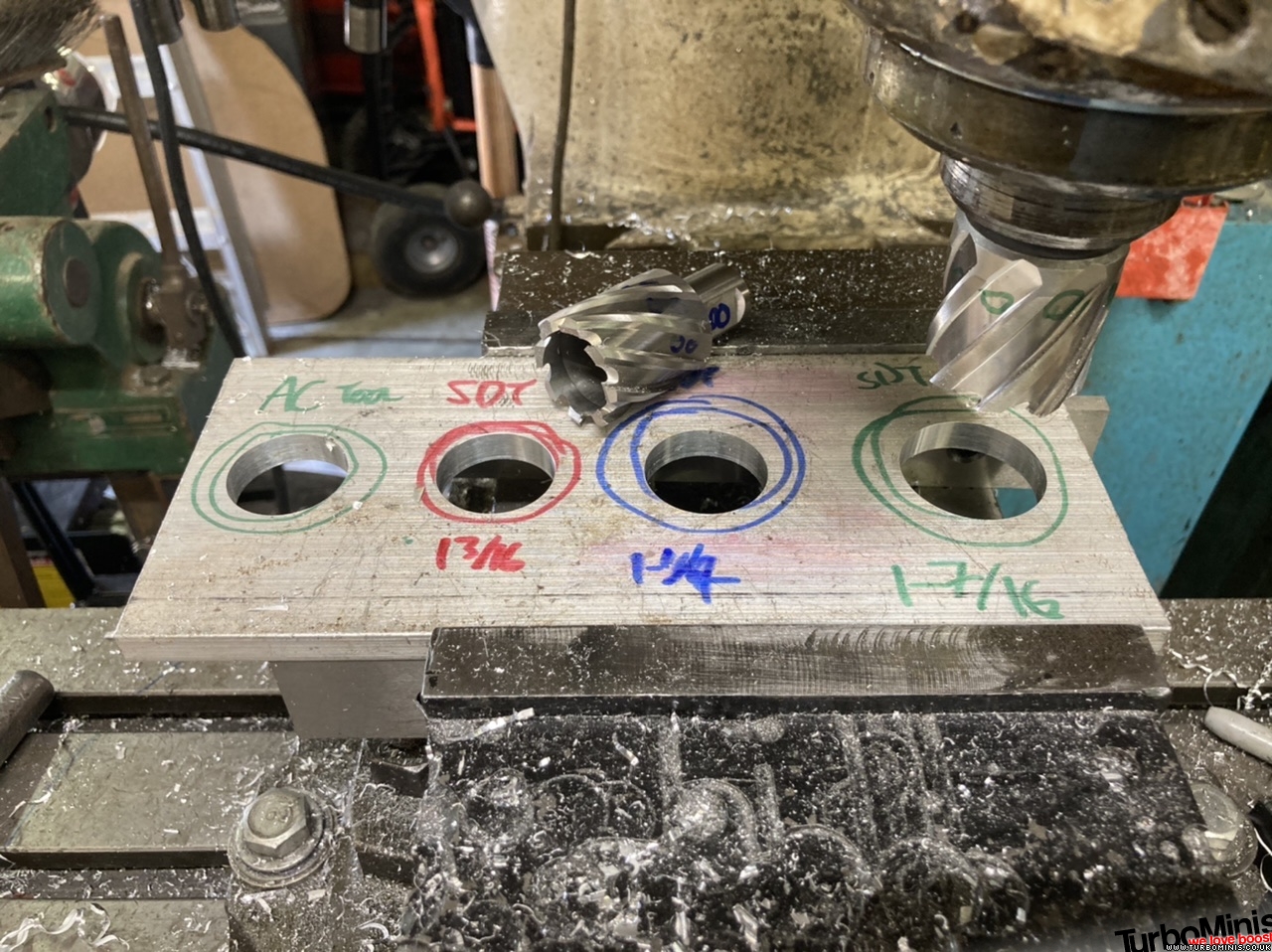

If you’ve not got a set of Annullar cutters, you need to get on eBay and buy a set.
These things punch through material in no time and make a hole that looks close to a bored finish.
I measured woth telescoping hole gauges, and the holes were all +/- .001” (0.025mm) - two perfect to size, one was .001” over and one .001 under.
It took under 30 sec to go thru this 1/2” alloy plate using the quill handle. It’s best to ‘peck drill” them to avoid the massive bunch of thin chips that’s created by the many cutting surfaces.

Three different brands here Phil - the 1-7/16 is Wansui Probor, the 1-1/4 and one 1-3/16 was Steel Dragon, and the last 1-3/16 was AC tool. All Chinese obviously, but I can’t tell them apart in quality.
I’m still in awe of how amazing these are....
FYI I’ll be using them to bore out the valve seat throat on RV8 heads; 1-3/16 and 1-7/16 are absolutely perfect sized for the typical oversize valves giving 88% on inlet and 85% on exhaust. I’ve got to take out so much material that this will be more effective than hand cutting. I’m going to make a mandrel to pilot them in the guide and mill them, but given how accurate they are made, and the number of cutting surfaces; I bet these could be adapted very easily to use with a mandrel piloting in the guide (or guide hole) to hog our a lot of material fast and easily using only a cordless hand drill...
Might be worth you experimenting with...

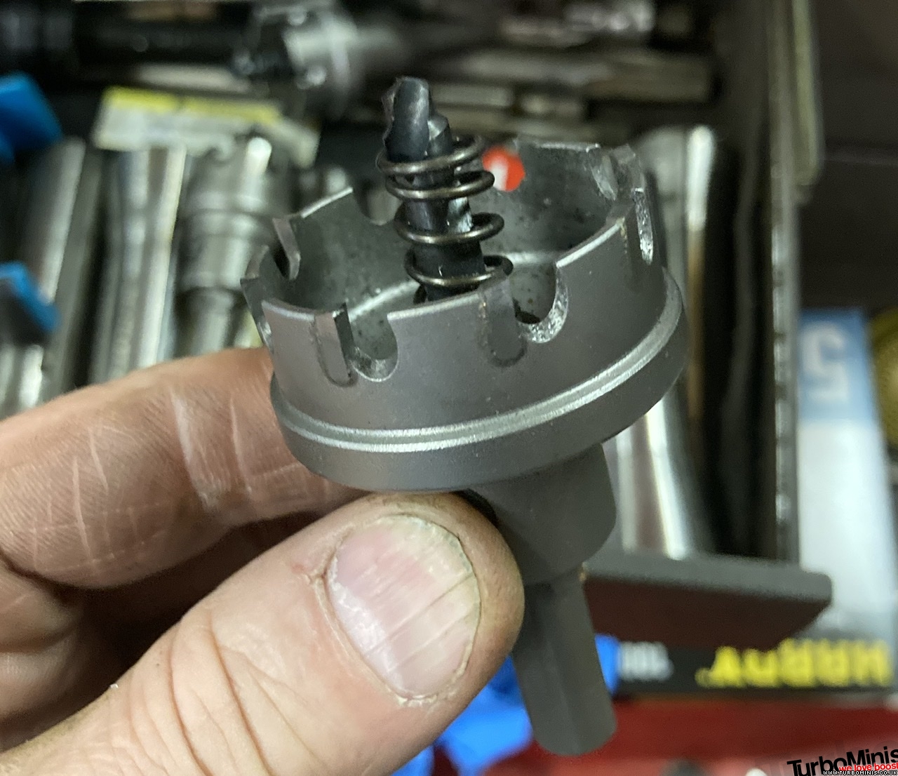

I’ve never heard that term; the only other term I’ve heard then described as is a ‘slugger bit’.
Not sure if what you’re talking about looks more like this, I discovered these from the electricians at work Who use them for putting holes in panels. They make an absolutely perfect cut with no deburring - I certainly can’t say that about the old school hole-saw type.

That's just a variation of a holesaw, albeit looks like it has carbide tips in it for hopefully a cleaner cut. As regular HSS holesaws are pretty terrible.
Haven't actually tried one of those yet.
First google of "rotary broach" brings up this, drills for mag drills. Or the term "rotabroach" is also common.
Seems there are lots of variations, or rotary broach can mean something different altogether.
