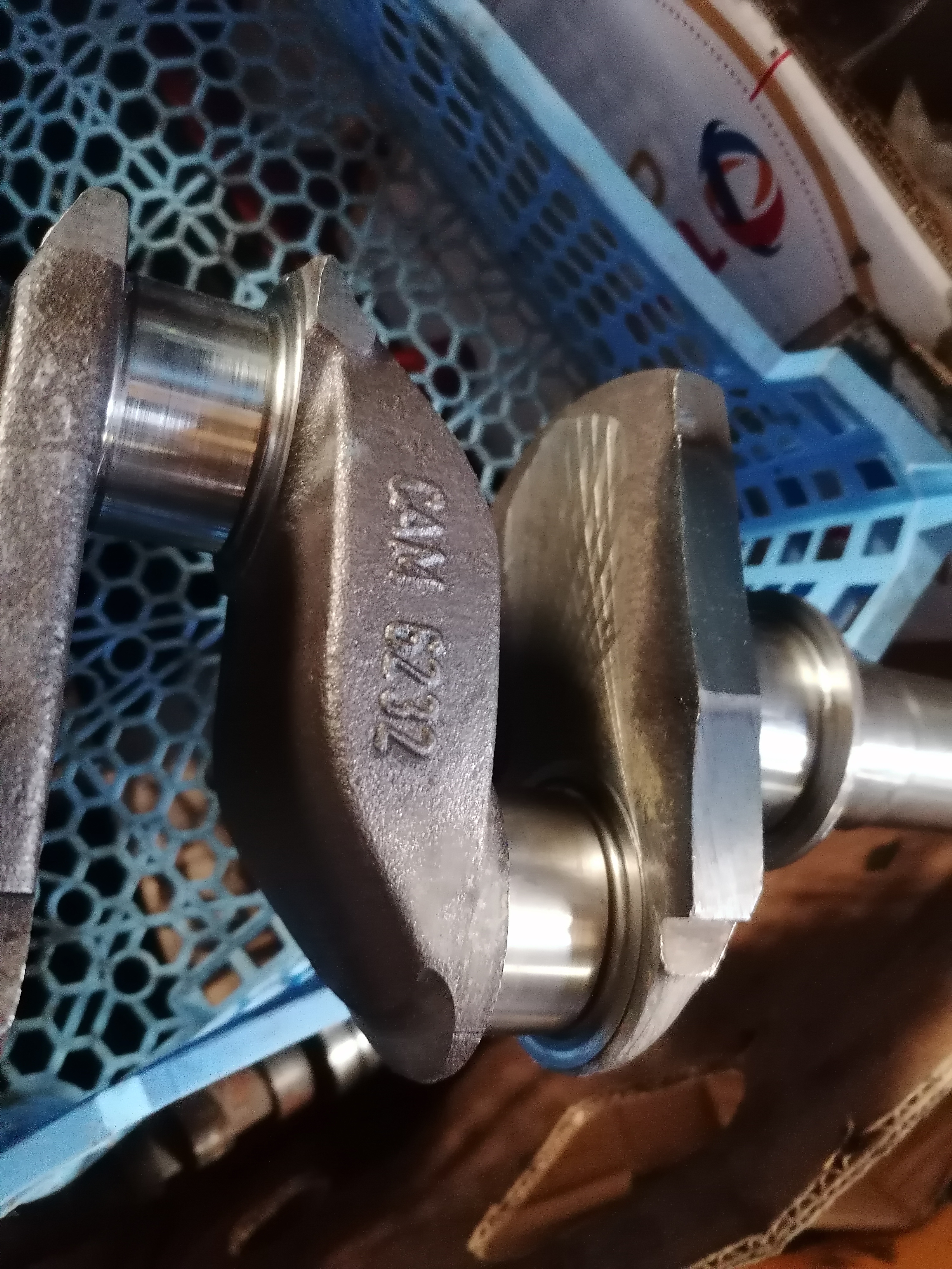

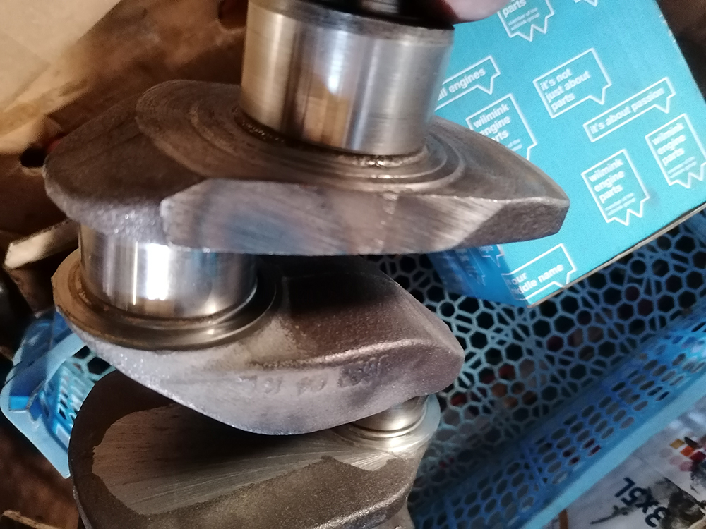

Just got an engine stripped from a supposed tuner.
I seen lightend crancks but in my idea this is... Well bogg jobb home done on a farm.

Looks like fairly normal balancing marks ?

Possible but looked extreme deep to me
Some of the metal is removed in the places neccisary to compensate for getting it wrong on the balance weight parts of the crank.
But that's a lot been removed.
Is the crank straight ?
What are the journal sizes, standard or undersize ?
The photos look like some are reground and some aren't.

They are all standard and cranck seems straight when I put it in between the bearings.
I am not tempted to try it out how it runs aqtually

Put a new set of bearing shells in the main bearing housings (or some good old ones) and apply some light oil (less than 20/50), put the crank and thrust washers in and lightly tighten the main bearing caps - not full torque, just enough they have seated over the sleeeve dowels - then see how much effort it takes to turn the crank.
If it's straight you will be able to spin it with just your thumb/forefinger.
Any more force required it's either bent or something else seriously wrong.

Looks like a later 1990’s crank from the casting marks. The factory balancing efforts had big chunks of material carved off in all sorts of places from the ones I’ve handled.
That's factory balancing marks. Not neat, but normally fairly accurate. ANd good enough for a small shitty cheap car that maxes out at 5500rpm.
